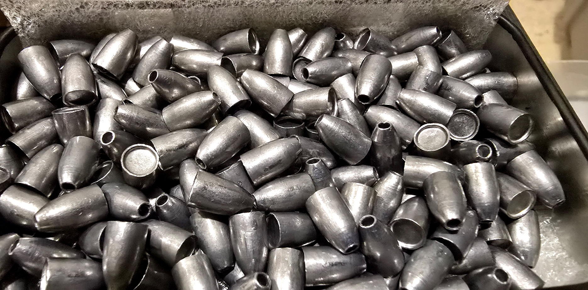

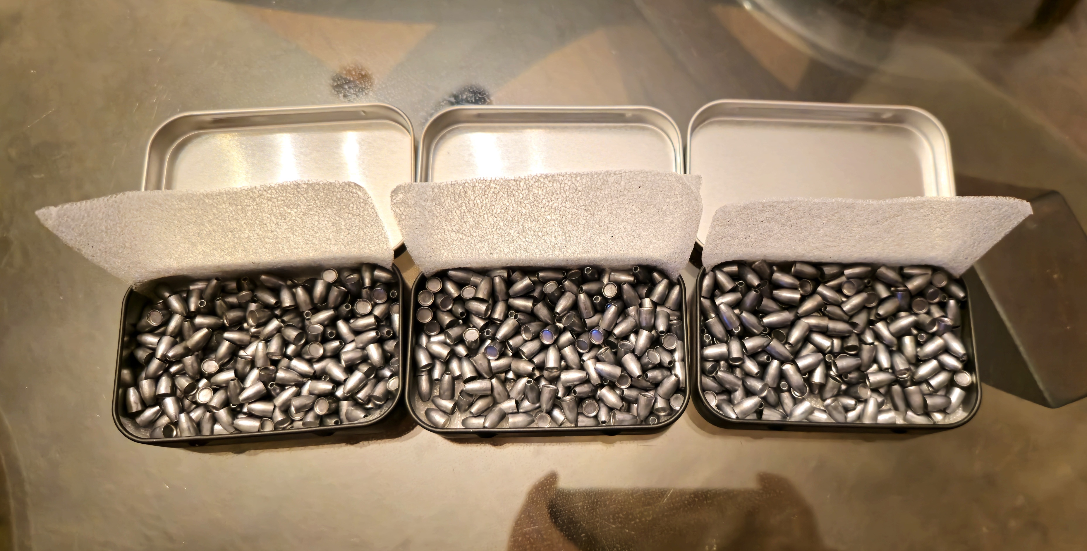

The 218 Griffin LDC got delivered today, he ran out of poly balls and will get more in a week or two, i won't receive the 217 until he could make more. Haven't shoot them yet but they look awesome, super clean. Out of curiosity i went to count the 17gr 218, he didn't mention it but there's actually 220rd in the tin instead of 200, happy to find the 20rd extra. 🥳😁 Didn't count the other two tins so i'm pretty sure they'll be 200rd(or a few more) in them. I put some Ballistol on paper towel and roll them, just to get a very light coat on the slugs to prevent oxidation, should also help lubing the breech o'ring and barrel whenever i use them. If these shoot as good as the Hybrid then they'll be my go to moving forward, much prefer these lighter weight slugs to minimize pass thru.

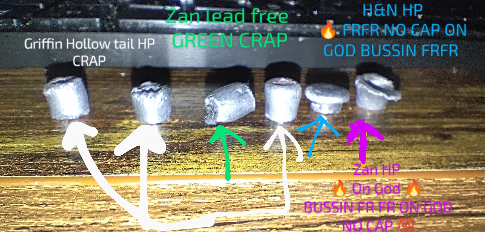

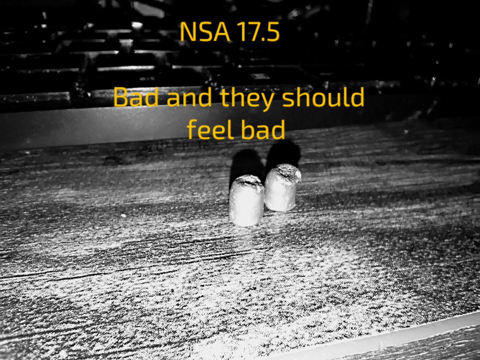

Oh yeah. These were fatal projectiles I've recovered. 25 and some NSA 17.5 22s. You've seen what the LDC .22s do.View attachment 508510View attachment 508511
Thanks for those pictures, and wow....the NSA 17gr didn't expand, the hollow point section just got pushed inward a little, what velocity were they on?doesn't look better than JSB 18gr.
The nsa 17.5s don't expand at all. The cavity ever so slightly stretches and the body slightly warps. Those were at 790. But the kills were a squirrel and a rabbit at my wood line feeder at the edge of the grass on my backyard so only 18y. The Hn slug was the headshot Sunday night, the zan last week same 35-37y as the hn. Only 30fps slower. 870 vs 900 both 30gr.. the zan lead free was over 1000fps it's only 22gr. Hit a Canadian goose in the head, skipped off the grass and hit a silt fence, stuck in the silt.
The Griffin Hollows were 2 squirrels and a rabbit at 880fps didn't range them as they were at my usual permission, they were between me and a tree I ranged at 58y. I estimated and nailed them. Not hard considering 25-46 is .5moa difference.

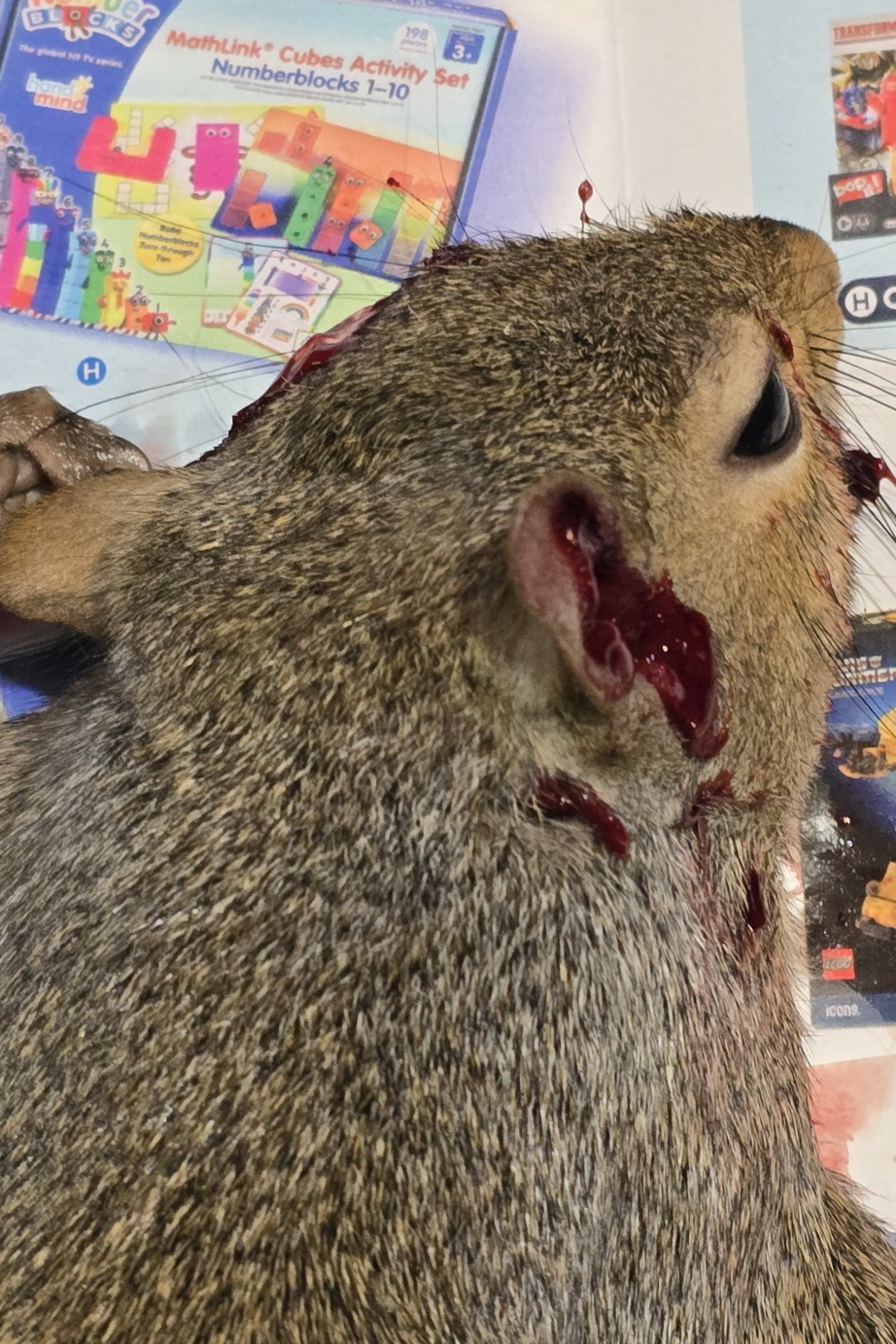

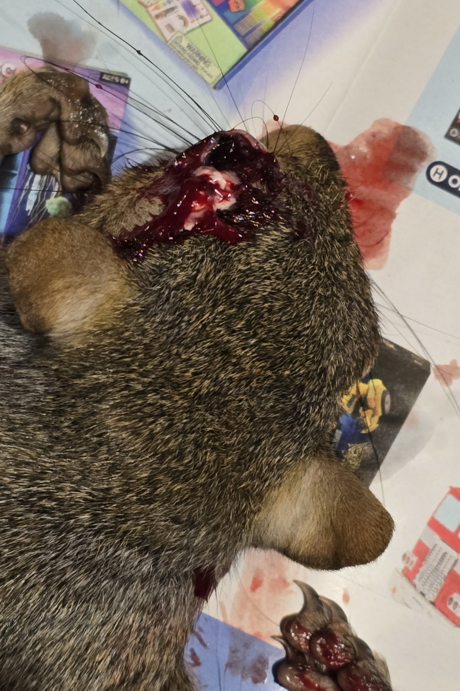

The Griffin 17gr LDC didn't disappoint, 1 shot 1 kill, he was about 20 yard away with his back facing toward me in 45 degree angle, aimed behind his right ear, the slug blew out above his left eye, his skull feels fragmented and shattered, almost mushy....the LDC is devastating like the Hybrids. I dialed in the M4 to sling this one at 980fps so there's about 36fpe through the skull, a loud pop upon impact. A head shot at this power level even with 15.9gr Hades/Atomic will be instant light out. I'm happy with the Griffin accuracy, can probably get away shooting these 17gr LDC with the stock Notos, definitely brutal and effective from M4.
