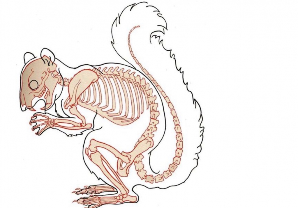

Okay guys I would say the different results may have to do if Ken's slug hit a bone. Of course there is a big difference between that and flesh. Now for me shooting pigeons and small birds at times you will not have any substantial bones to make a slug open up at least shooting the .25 cal FX Hybrids. As I showed in my ballistic gel test the .22cal. FX Hybrids did open up to about 40 cal. or more as I remember as well as the Griffin and Varmint Knockers. As I said just looking at the new FX .25 cal. Hybrids it appear they may have more tin in them or are not as soft as the other slugs that did expand. If FX decided to go a different route on the construction or composition of these slug as oppose to their .22 cal. that would make them less effective at delivering more energy to the target. For some the lack of expansion may make little difference. For the purpose I was hoping to use them for it does. Let's see how things goes and be beware of some of the hype we are seeing. Bill
AirgunBill, I appreciate the effort and don’t dispute your results. Mr. Hicks has a slug in hand showing uniform expansion from what he says is heart/lung, suggesting it was recovered from the chest cavity. It could have caught a lot of shoulder I guess, but something feels off. You’re probably right that they changed composition to improve accuracy.
