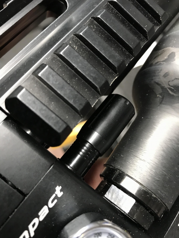

Quick question guys, had my .25 a few days and not altered anything as yet.
With the wheel on max I’m firing the 25grn JSB’s at 900fps and the 34grn at 810ftps there’s a fair bit of slop in the hammer and the valve is set like this from the factory, does that look right?
Should I take up the slack and wind the valve in a little.
"EliteAirgunr"That valve has nothing to do with slack and what people refer to as taking up the slack. That has to do with your hammer spring.
NO, you should not touch anything or take up any slack if your gun is shooting well. Stop tinkering and work on your fundamentals and learn your holdovers or clicks for your scope. Have fun shooting.
Yes I understand taking up the slack refers to the hammer spring tension, I just wondered if the valve looked to be wound out a little far, when I read people saying 3 rings showing or 4 rings showing for the valve setting mine looks to be more.

Who setup your gun? Does it group well? Does your shot count fall in line with your caliber? If all those are satisfactory don't touch it.
Ideally you want to close the valve there until you start to see your fps drop from where you wanted it. Once it drops, open it back up a little till it's right where you want it. This gives you efficiency and doesn't waste air.

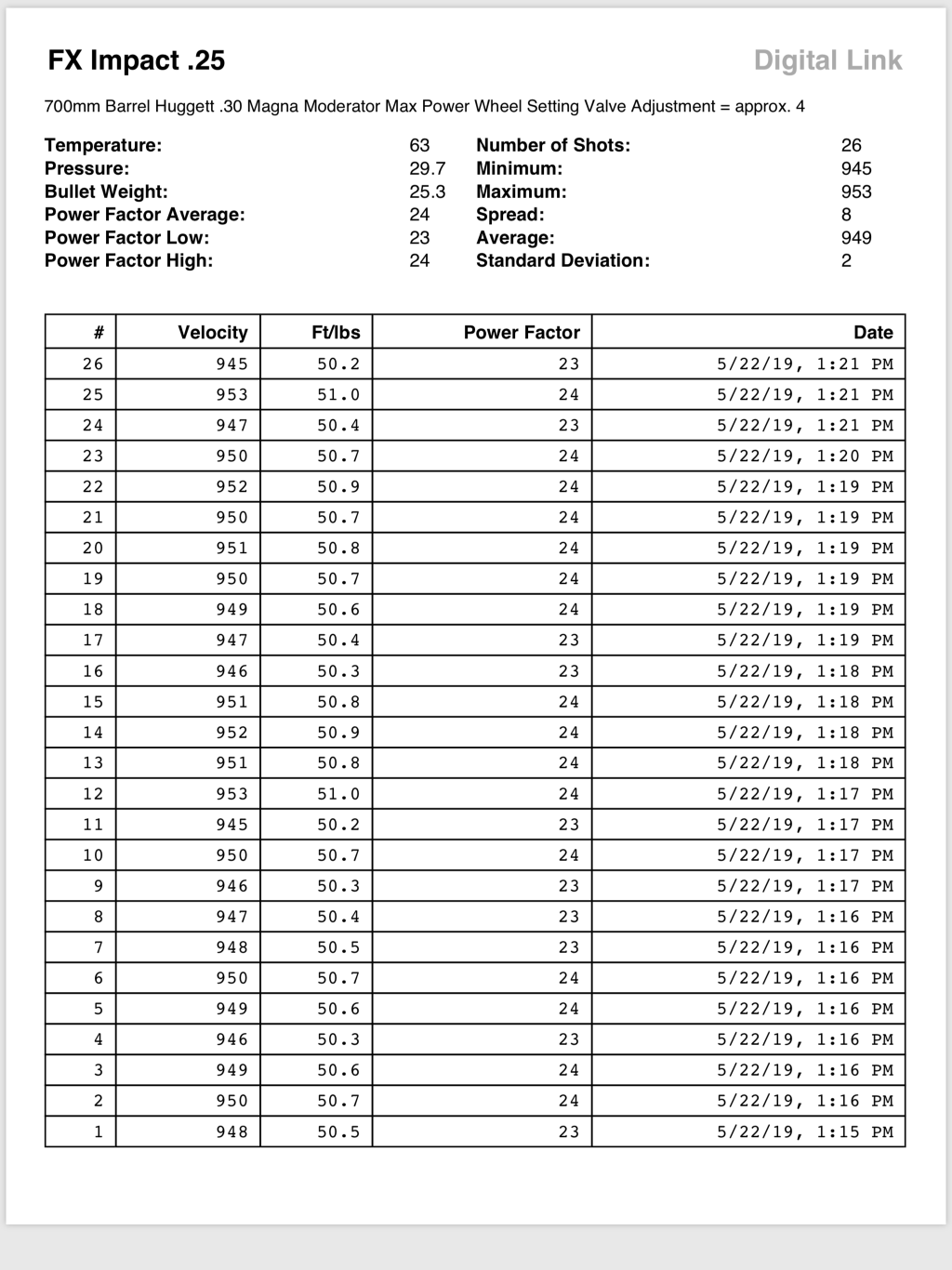

Does anyone have any additional information for optimum FPS for the FX Impact .25 w/700mm (any other links or discussions)? Here is a shot string from this afternoon shooting JSB Exact King Diablo 25.39 grains. Happy with performance, but is this too high with the 700mm barrell? With the power wheel turned to “5” I was able to get an average of 935 FPS.

I’ve watched his video many times, but it does not really answer my question. I also believe he mentioned a target range that he was tuning down to for a .22 caliber?
There is the manufacturer recommended FPS for each caliber, but also have not seen anything for what that range should be for an Impact equipped with a 700mm barrel.
My FPS increased from 910 to 940 simply changing the barrel, only. The only fine tuning I’ve done is play with the air valve adjuster.
So, is there an ideal range or optimum range when switching from a 600mm barrel to a 700mm barrel?
