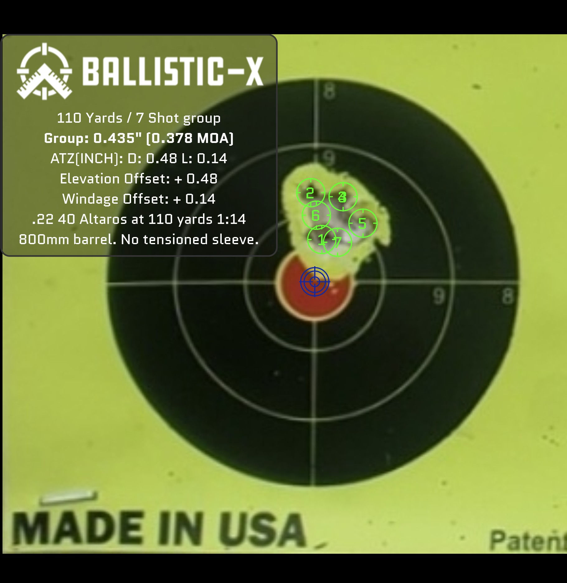

Today I went back out to the range with the 1:14 22 800 mm 22 same gun. It was cold and very humid. It just rained. I don't know what I was thinking but I forgot to crank back the reg when i was home. It immediately fired at 1050fps. Cranking it back I got it down to 930. Turning down the front screw got me down closer to 900. Ideally I need to crank back on the pressure as I am somewhere around 180 bar at the regulator I believe. But wow the ATP started stacking them at 100 yards.

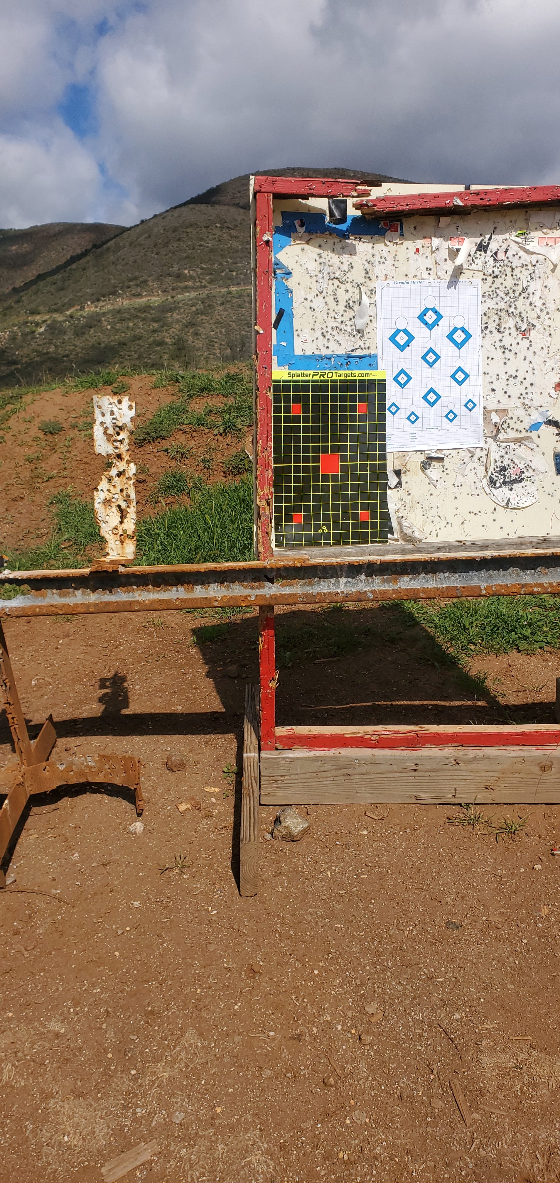

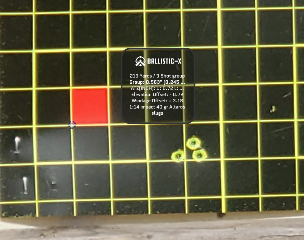

After about 25 rounds I immediately went to 220 yards and took out the little bunny silhouettes one by one with only a couple misses. I still need better eyes or glass as i still have issues seeing the impacts. I think most shots were a little bit low. I shot some paper at 220 yard to confirm and literally stacked 2 of them just like that. I couldn't believe it didn't want to try it a 3rd shotbut of course I was out of slugs in the magazine anyways when i tried. Which by the way was redesigned by Elis a while back, I just now got one of his new ones. Made just for slugs and it did not hang up one time with the 150 or so slugs I put thru it.
Of course when I got the magazine refilled the 3rd slug was not in the same hole. The conditions change a little. Since I had to leave earlier than normal I went for 300 yards and started pounding some crow silhouettes. I have no idea how large those are but they are larger. I guess next time I will drive up the to see the size as I was a bit of a bum and had to leave before the line was called. I put down a good 8-10 and I'm sure next time someone will figure it out that it was the guy shooting the airgun who did knocked them all down!
