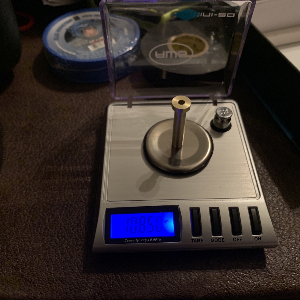

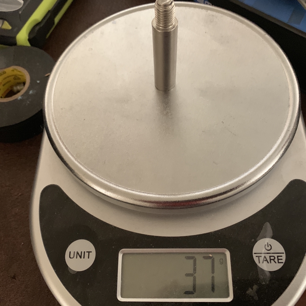

Made my first Impact hammer weight on my new lathe:
What lathe did you buy? I just picked up a new Grizzly G0602 this morning after waiting more than two months on the slow boat from china. I also have a G0704 mill.
Just a small 7-12" Grizzly that someone sold me with a ton of extras. I'm moving soon and didn't want to setup anything but a small single phase right now.

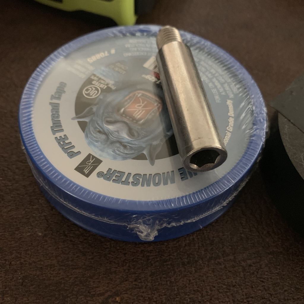

I think my next project is going to be making an entirely new hammer. I've had these two extra caliper bushings for the BMW M3 that I sold off last year, paid like $54 at the stealership for each bushing and they're just collecting dust. I should be able to machine some nice custom hammers out of them..

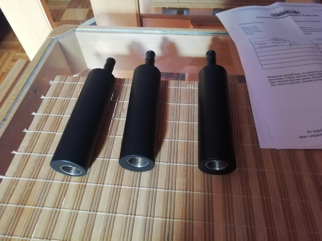

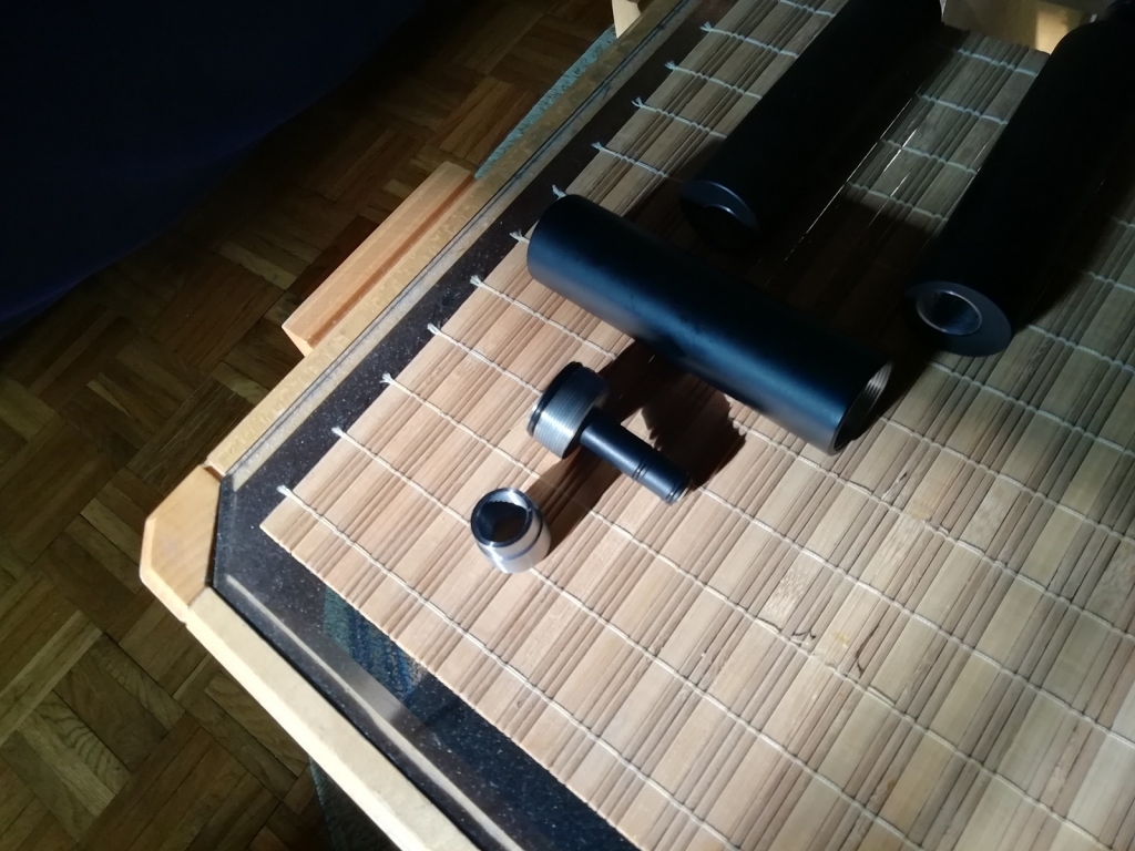

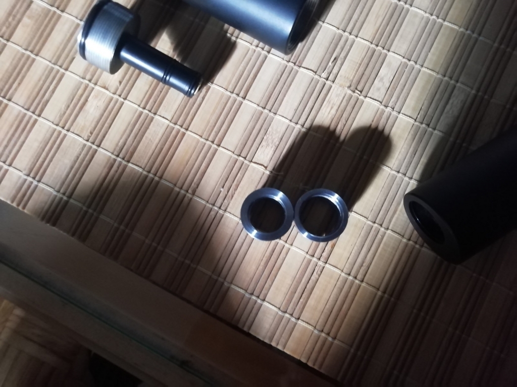

Arrived today from Poland to Serbia, nice looking plenums, good powder coating, all assembled, ready to put in a rifle. Ok, it needs a little cleaning but that is no biggie.One for me and two for my friends here. BTW, only difference between old and mk2 is in the adapter for valve housing, it is interchangeable.
That midle one is mine .... thanks for ordering for all 3 of us bro. At the moment just landed at London so true power test will be on Staurday ... cant wait 💪
