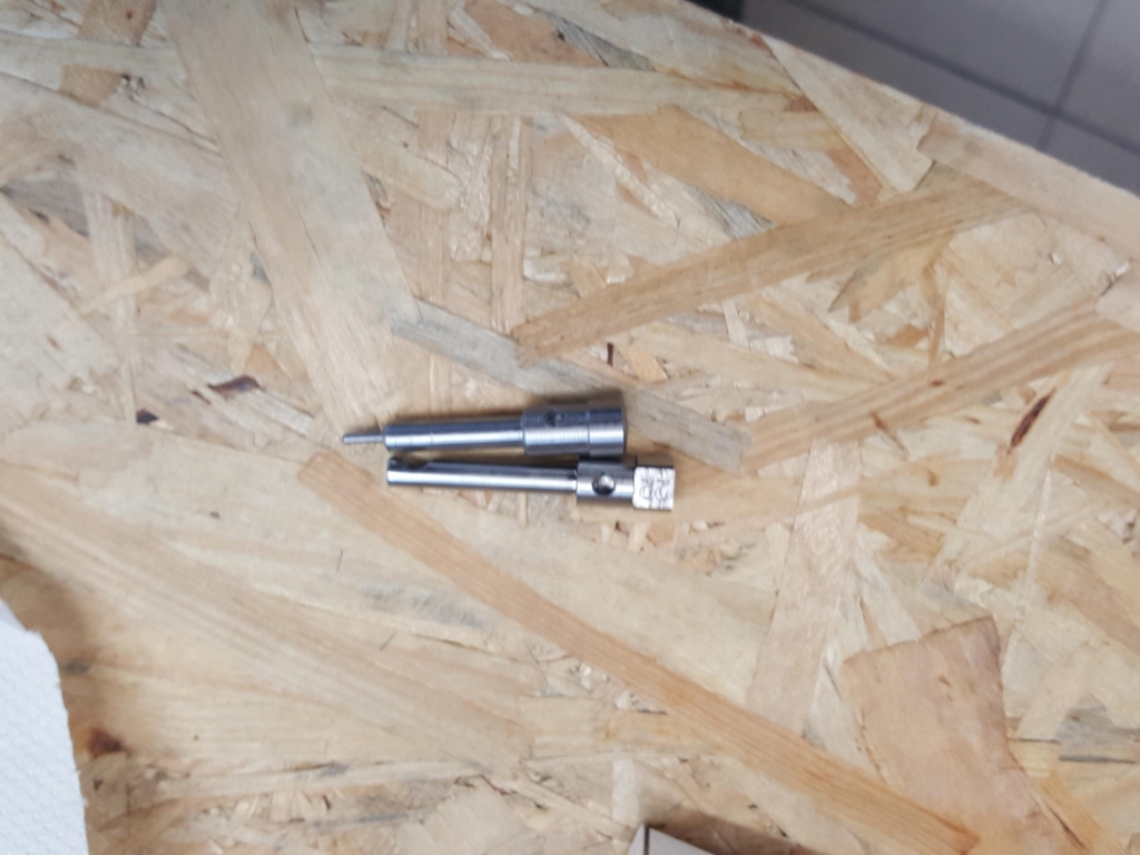

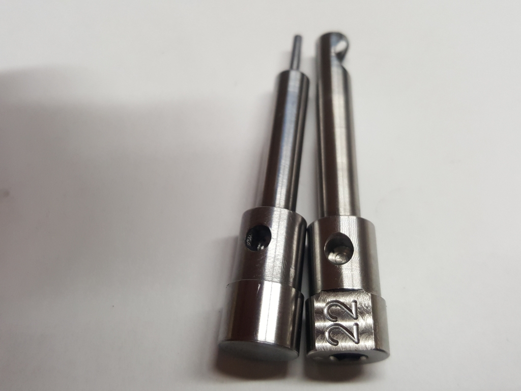

made with different weights slug.
needs to be tested.

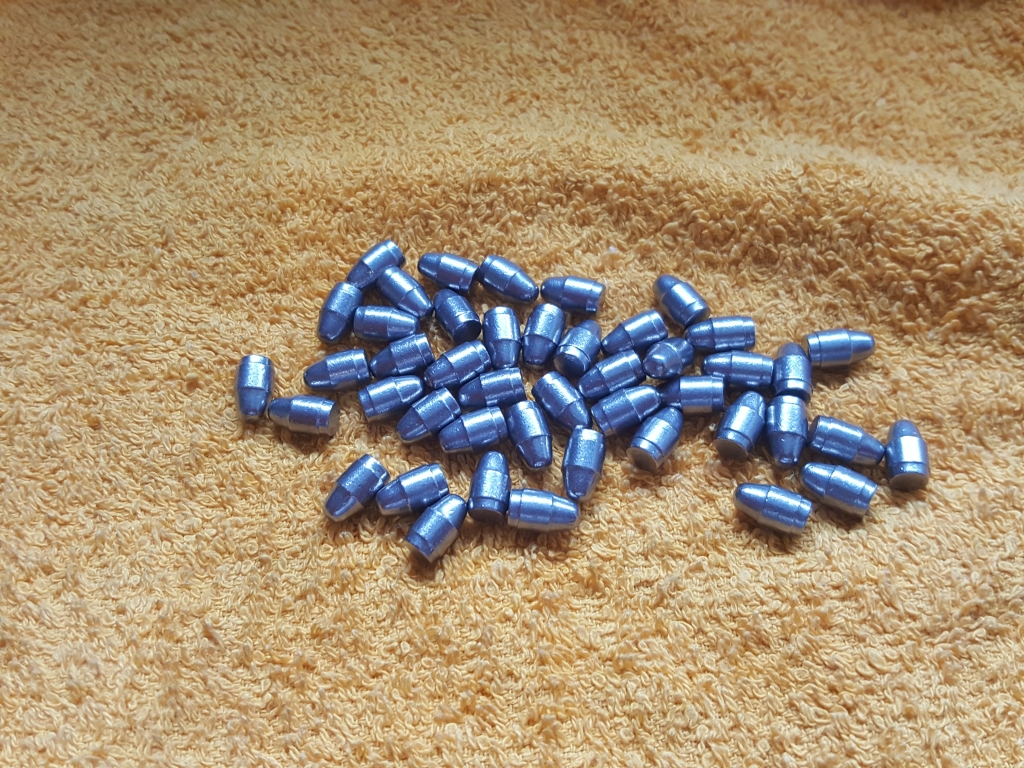

Quick question: Guys i just tested 34 grain mp mold sugs in my impact pellet liner a and its performing surprisingly well. I even checked it at 170 yards and its around 2-2.5 inches.
Just wanted to know if its okay to use slugs in a normal pellet barrel. I hope there wont be any problem. Its soft lead so i dont thnk it will be a problem. Please guide. Thankyou

no problem

Thanks mate
