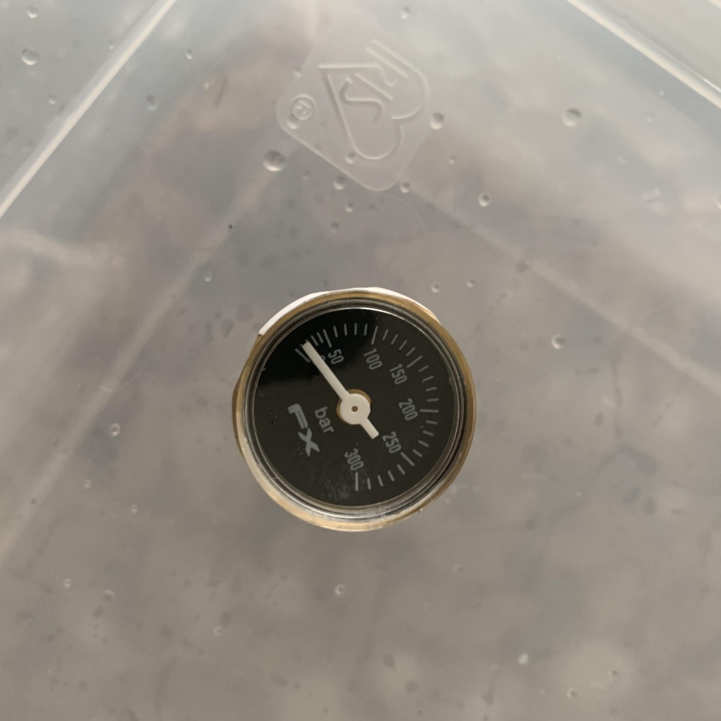

Guys just wanna tell you if you want to tune impact harder its good to start from changing the manometers to wika. My impact mk2 was off comparing to wika by at least 15b! Wika shows now 120b instead of 136b(reg).
I agree. The problem in my case was more of the dials being installed incorrectly. While my reg side seemed ok, my bottle-side manometer's dial is misaligned and has a fingerprint smudge on the right side of it. It sits exactly +15 bar with no pressure behind it.
1569359245_11591692005d8a858df04707.67073764_F69F451F-B612-4668-917C-EE76CCF5C484.jpeg
Even though these are just FX branded WIKAs, I put two new ones on, which are calibrated perfectly.

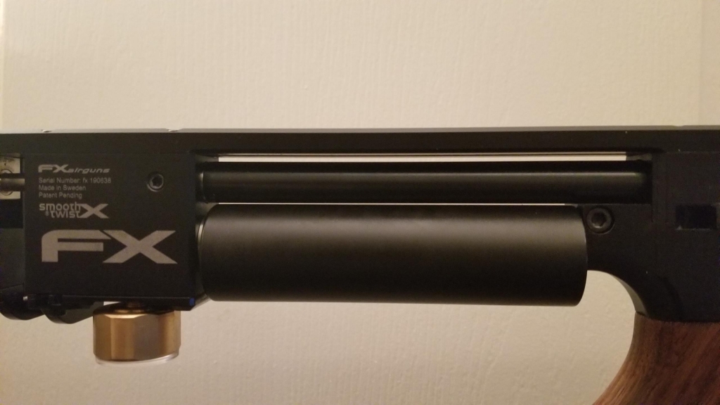

Ive had one and installed for a few weeks now i think. Very happy with it, the threads are very nice. They were a bit dirty but cut well, the outer diameter could have a nicer finish machining-wise. But all in all very happy with it.
No binding here and have a good 1/16th of clearance everywhere when aired up. (Doesn't appear to "inflate")
