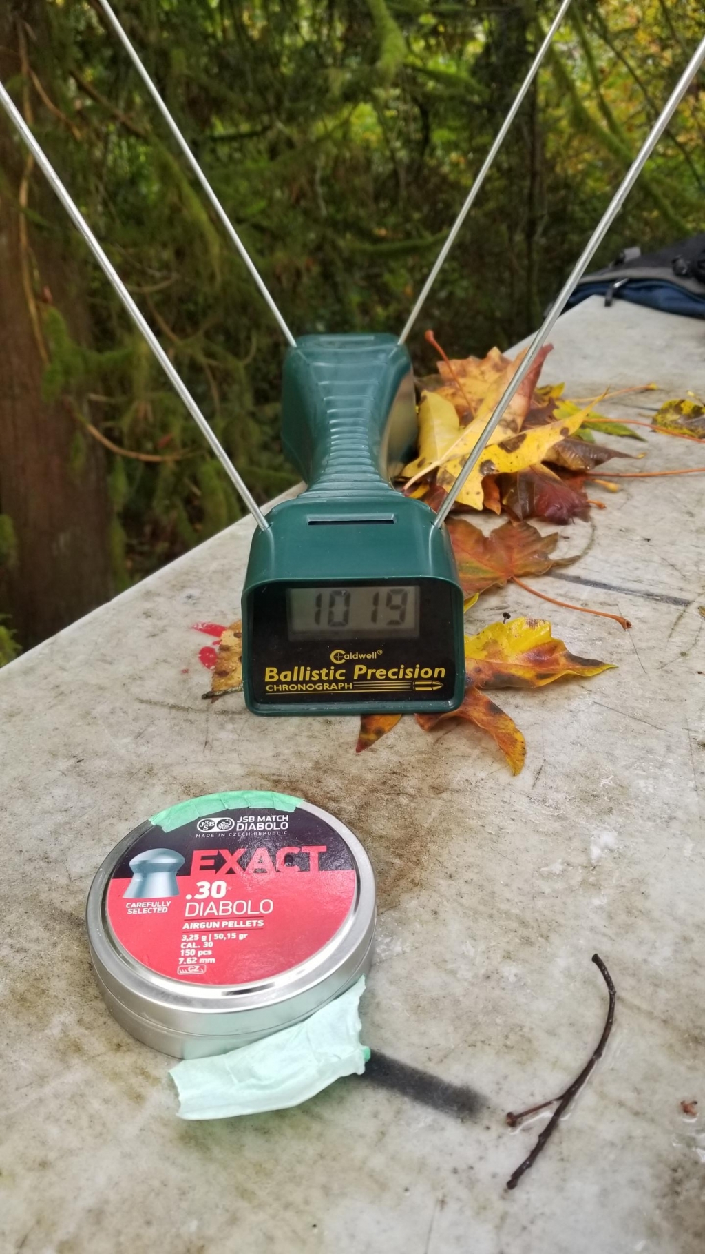

Surprise i bought a .30 setup! Got a few molds from NOE should be here end of next week hopefully. A 59gr magnum pellet and their 68gr HP but for now i bought a tin of the 45 and 50gr JSB. Brought the chrony out to my shooting spot and turned up the reg.
Got this at 130 reg with the 44.75, 999 at 150 bar.

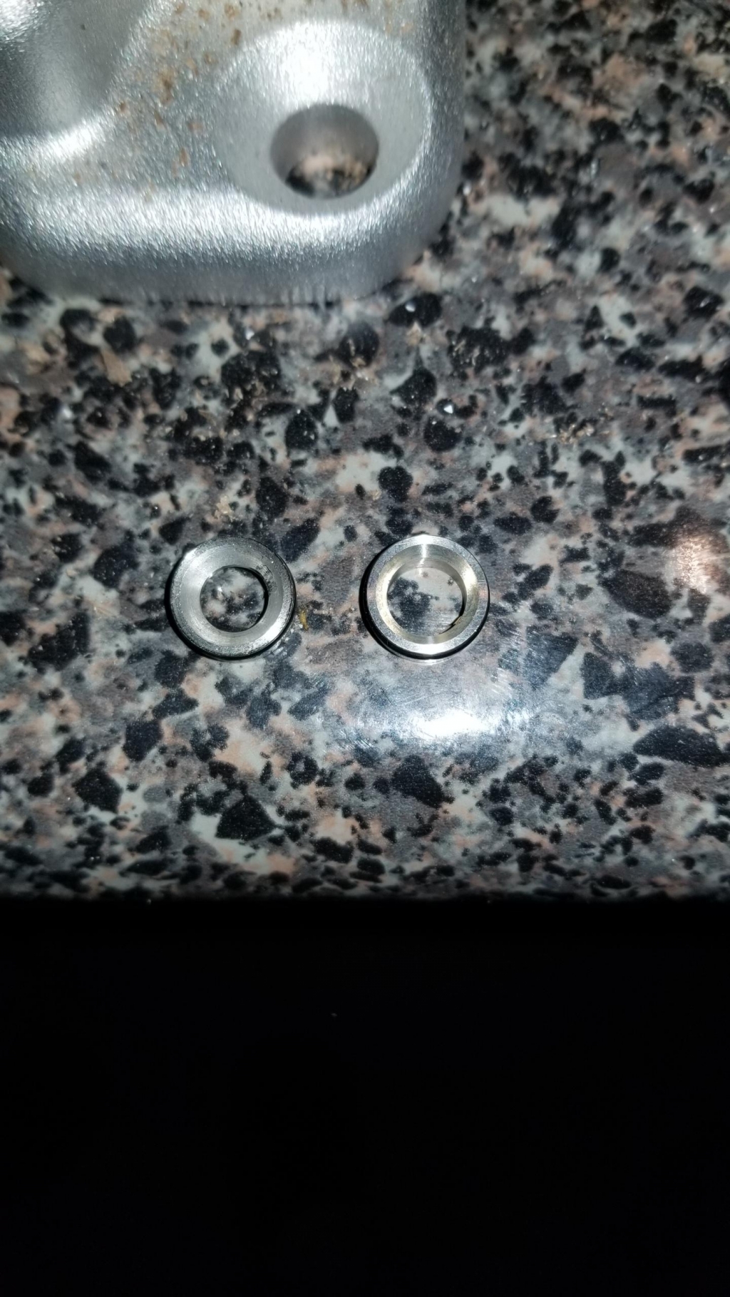

Do you guys do anything to .30 probe/inlet or not really anything to be had because they're already almost if not port size?

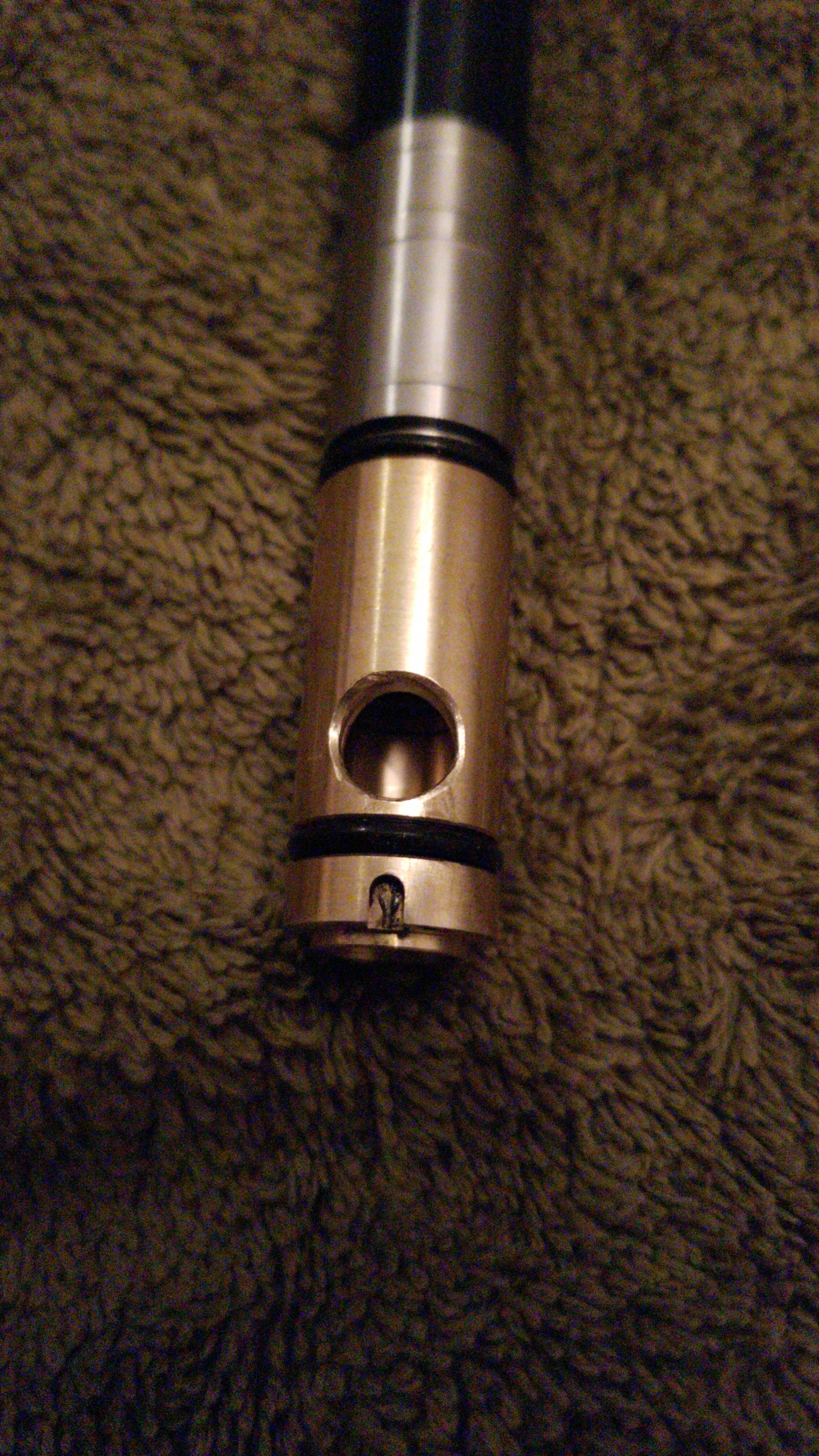

Edit well i flared it a bit and worked the probe a bit, i might not have had the valve adjuster all the way back too.

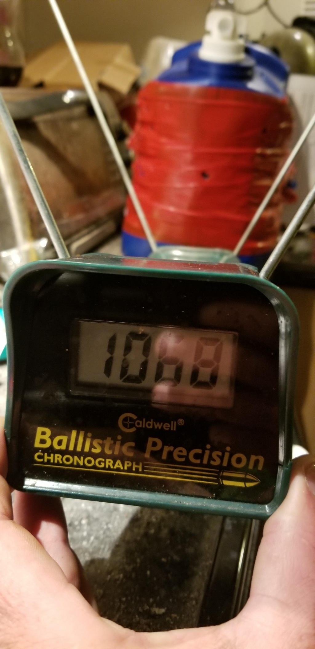

Got this with the 50.15gr, yowza 127fpe with pellets.

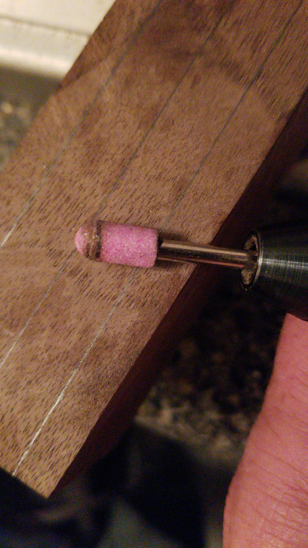

Used this and ran it in the end of the probe also.

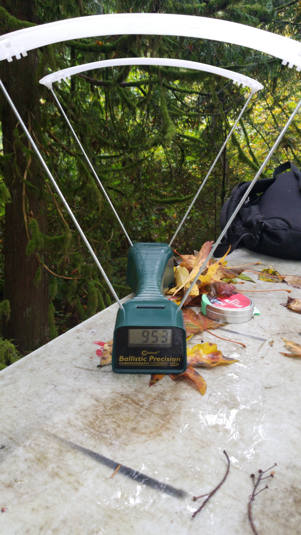

Just did a quick test with my new .30 700mm slug liner.
Brass port flared and elongated, top half of the pellet probe removed.
75cc air tube from Poland + 20cc yong heng external.
6.35mm valve seat, 4 gram hammer weight
Hammer on max and valve stop past the 4th line. Not tuned yet
150 bar
1072 fps with 50gn jsb - 128 fpe
948 fps with NSA 66gn fbhp - 132 fpe
