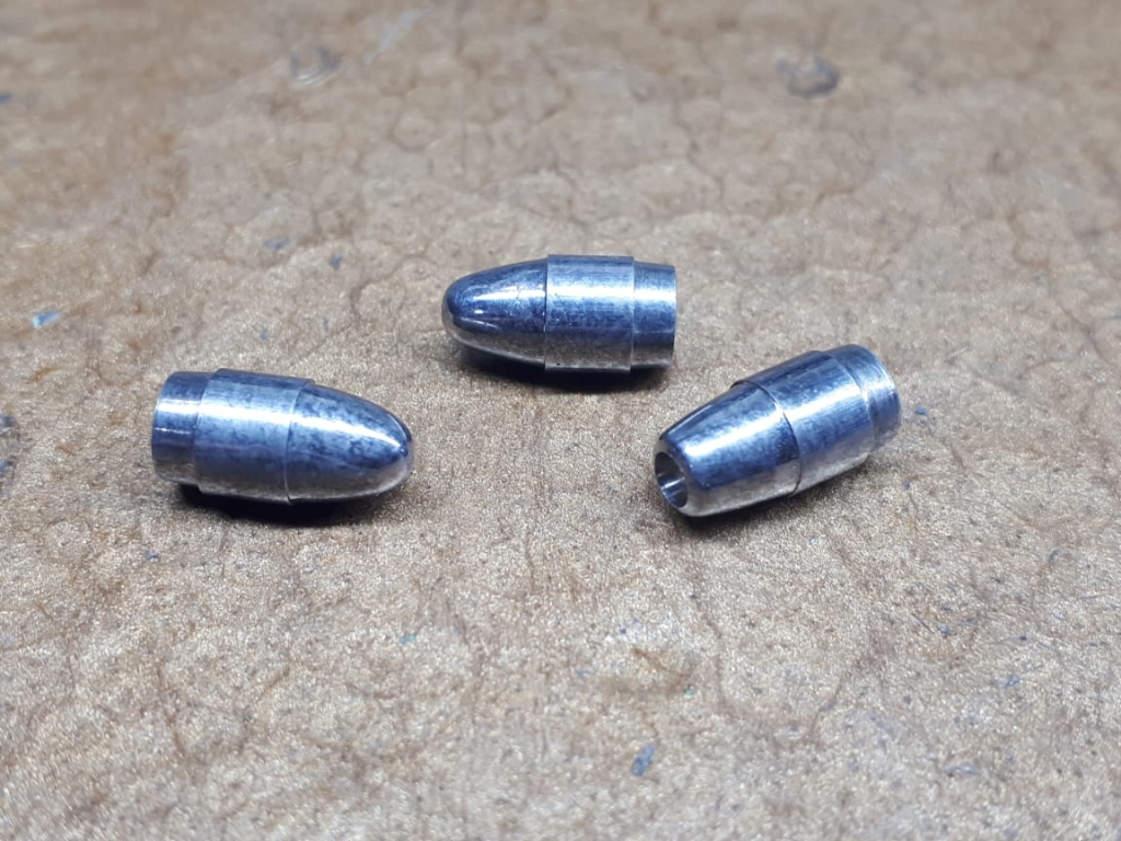

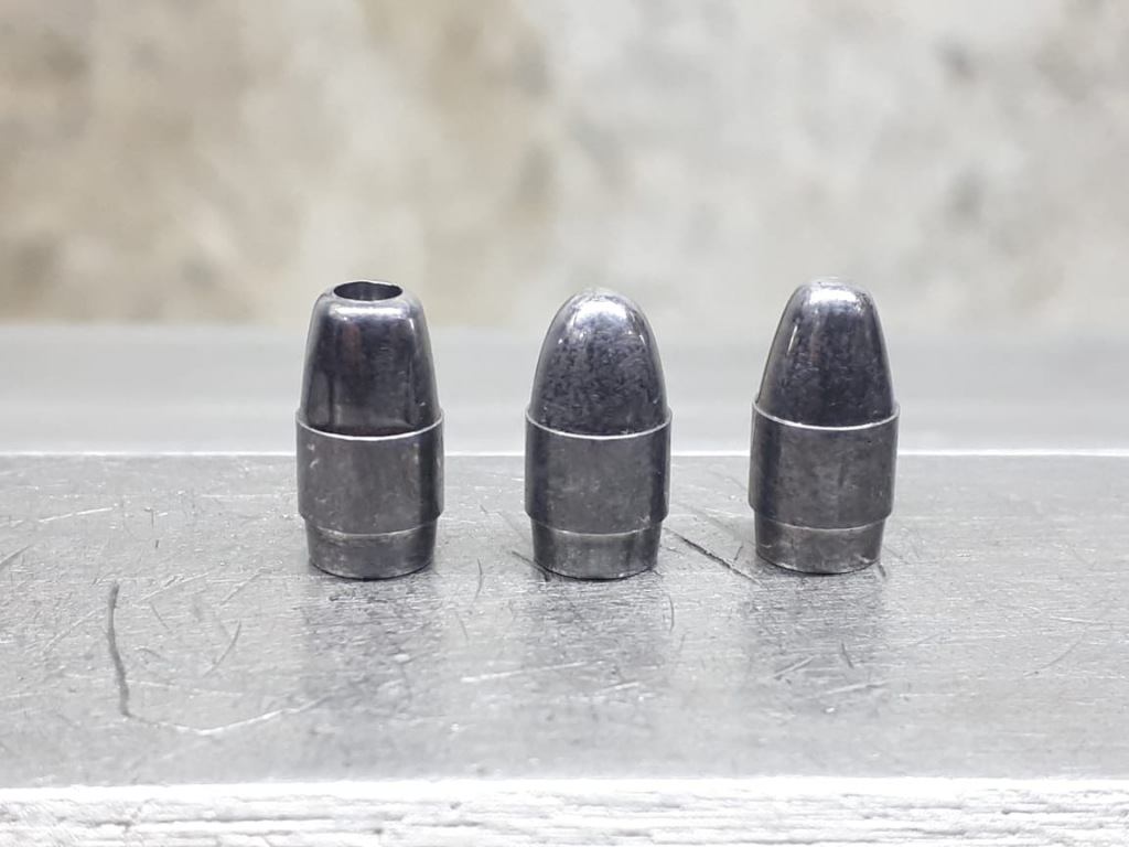

Just did a quick test with my new .30 700mm slug liner.
Brass port flared and elongated, top half of the pellet probe removed.
75cc air tube from Poland + 20cc yong heng external.
6.35mm valve seat, 4 gram hammer weight
Hammer on max and valve stop past the 4th line. Not tuned yet
150 bar
1072 fps with 50gn jsb - 128 fpe
948 fps with NSA 66gn fbhp - 132 fpe

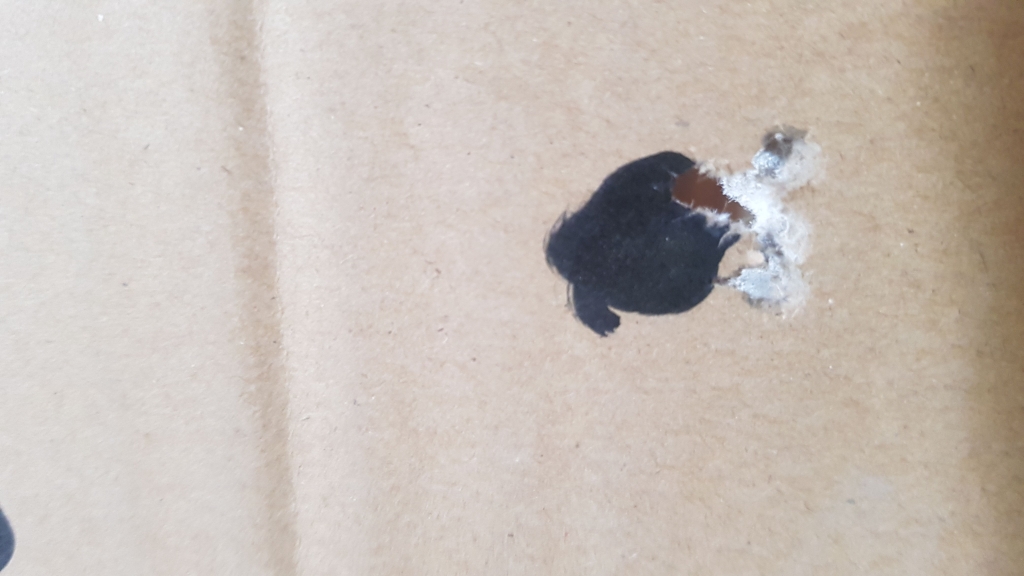

After fine tuning my mk2 impact. Shot a 8 shot group with jsb redesign at 945 fps at 50 yards.
Note: Shot with A pellet Liner

reg at 145

Any idea on groups at that just barely under sub sonic speed with the 50's or 44's? Be a heck of a coyote hunting gun.
