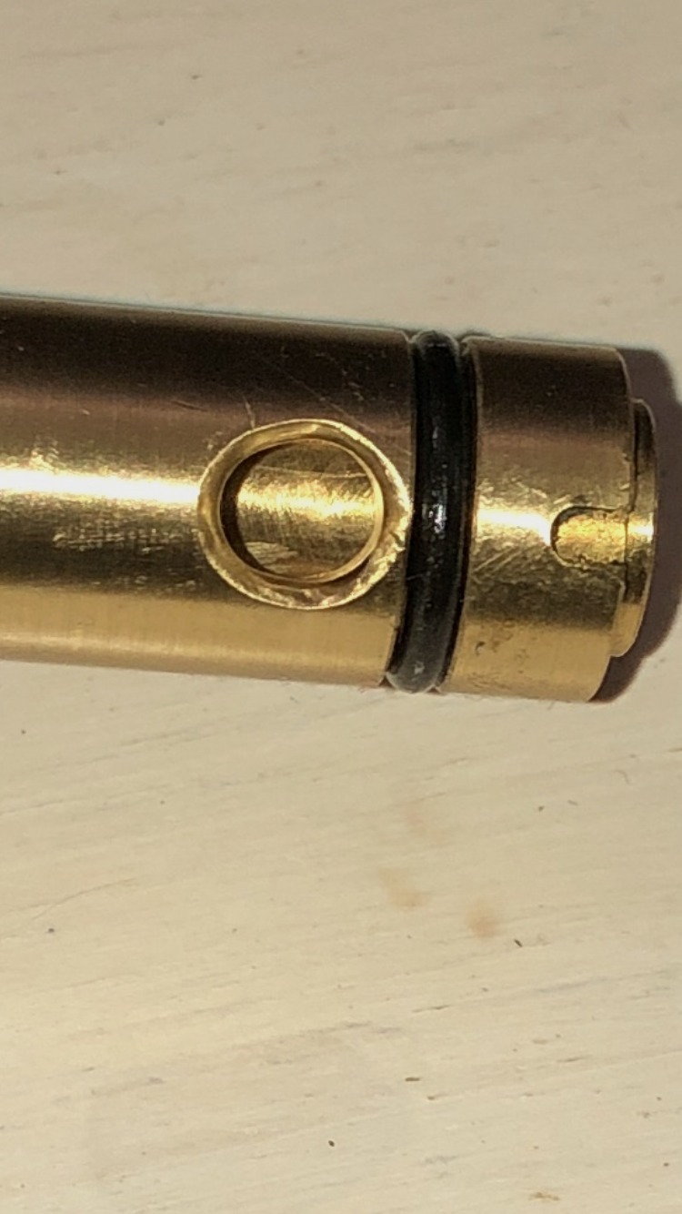

Every carbide burr that I have used likes to grab brass material violently. Might be fine in a proper endmill and vise to lock the workpeice, but it's not worth the risks in a Dremel.
Ya gotta work on that grip strength. 💪
I never noticed any grabbing. I use a tight grip and light pressure with the carbide burrs. Lower speed helps control when your getting close to the final shape.
heavy-impact
If I understand you well it is important that inside hole in the brass port where pellet slides to barrel must stay the same to avoid jam issue?
Airgun-hobbyist
The picture I found on the internet, if it is yours you did a excellent job
Where the pellet slides can not be wider or you will have feeding problems. Longer is Fine.
The picture you found on the internet is mine.

The dual port has a difference of 40fps from the standard port. so if you end up with an elongated port it makes no difference.
Is not only about getting more power, is about having 2 settings in one barrel.
It might have some good uses in fpe restricted competition. Changes on site.
Dual can be elongated too (original vs elongated).

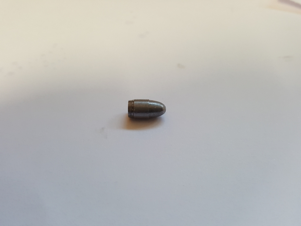

Each weapon needs to be assigned its own pellet or slug.
I only use slugs, and I adjust everything by one parameter.
I choose the best BC and accuracy I always use one slug.

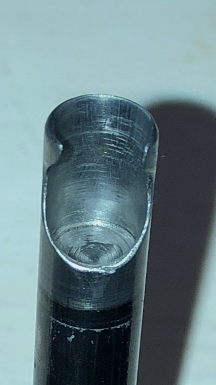

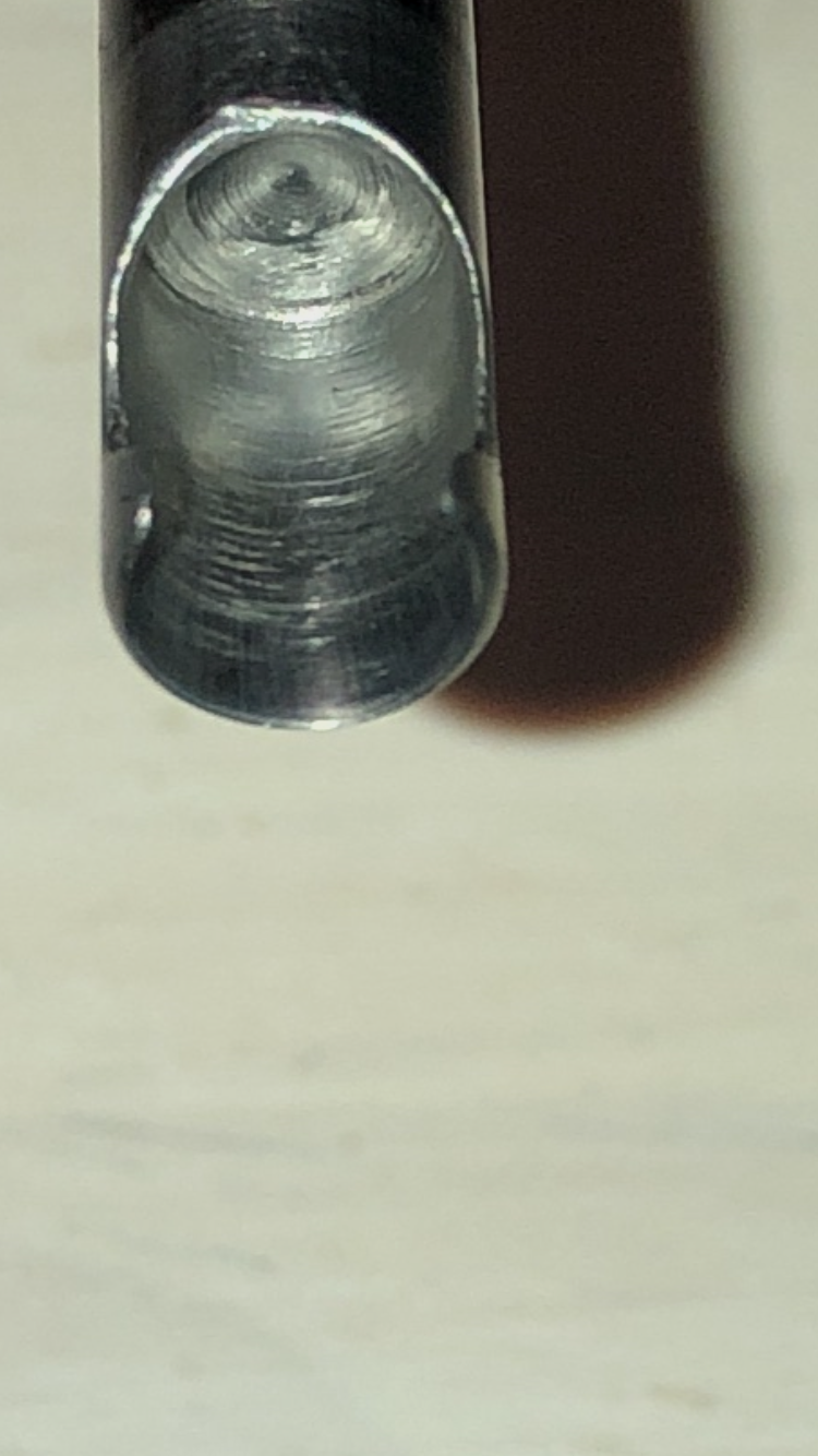

I don't think there will be any gain going above bore size on the port.
I think the gain is also from the pellet or slug not dropping off nose first into the port. So with the center supporting the projectile you can get an even bigger port area on either side of that, essentially making the ports the perfect size for the air volume needed and also contour shaping the port's exit into the barrel for optimal flow.
I agree. I have held back and been far more conservative with port enlargement due to jamming / loading issues (especially 30 cal). I also like this design better for deflecting the brunt of shot pressure on my hand made pellet (slug) pins. I'm also being conservative with the pin diameters, I'm just not sure how much pressure they can take (I'm sure there's math to ballpark that, but meh).
I explained in another thread but it's impossible for a projectile to tip into the port if the job was done correctly. FX made the port as wide as it can be reliable so it should never be made wider. You only need to flare the entry, lengthen slightly to match barrel area, radius the short turn and finish by blending all the cuts together for smooth airflow.
In a perfect world, maybe. There's been two inlets on different barrel kits that I bought that had undersized TPs drilled in them. Most recent was the 30 cal kit that had bought from UA, the inlet had to have been meant for a 17 cal. It was under 5mm and looked obscenely small.
An observation that I made - in terms of velocity, I never saw a performance hit by inadvertently going a little wider than the block's port. I'm also fairly certain that I have widened every inlet that I have modified unintentionally lol
