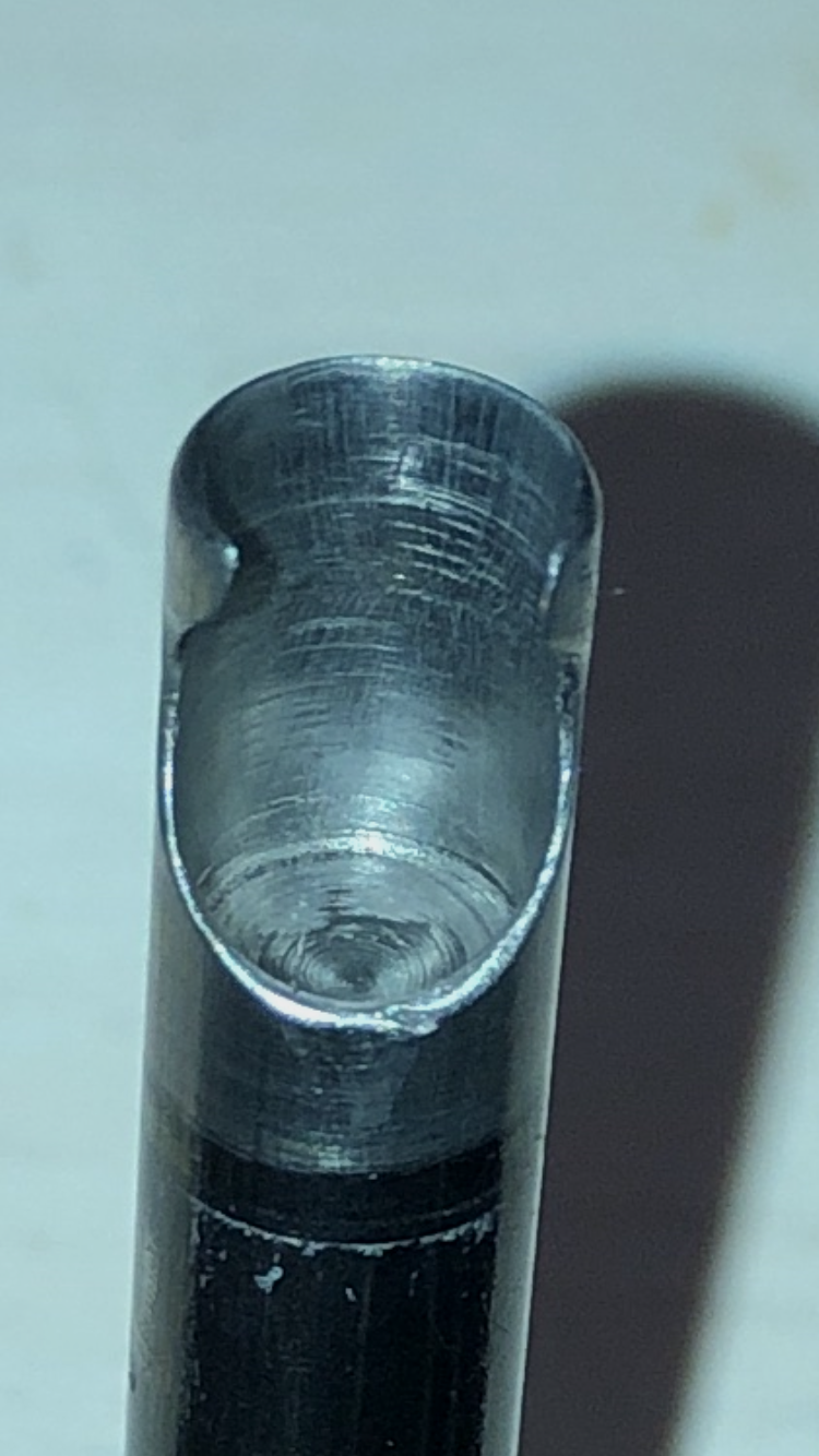

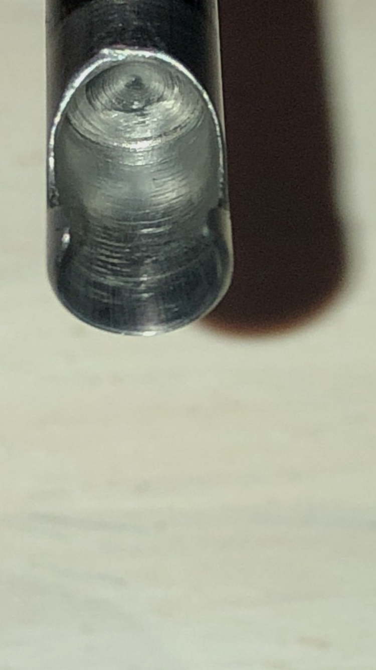

A few pics of the work. I removed a bit of material from the inside of the probe to thin and “knife edge” it. Used the blue Dremel chainsaw sharpener then polished with some fine grit rubbery type of bits I had from who knows where.
1575870172_19999803465deddedc5fb749.55025332_35E1A47E-3F32-4A4C-9BF7-480B19DADAE5.png
1575870172_14442552455deddedcab17b8.15473597_E151AC08-ADE6-4B53-B6B9-9806885538AA.png
Good job and great results!
