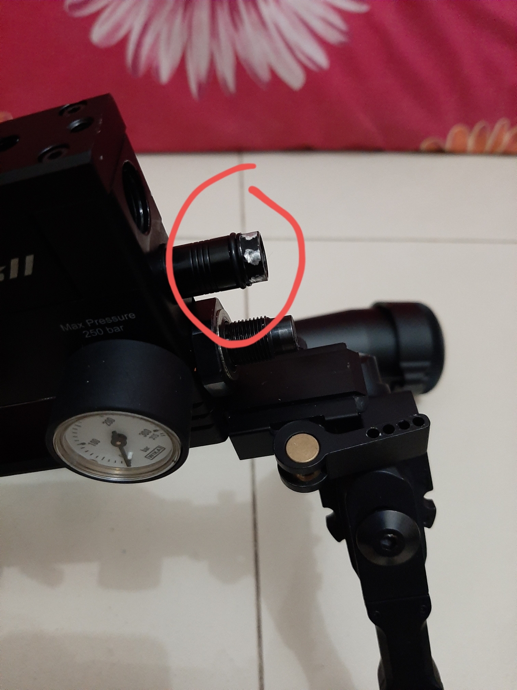

Intend to install power plenum...but i can't open this with 11 mm spaner...any comments? Now the shape become round circle
I highly recommend the Knipex - Pliers Wrench for applications like this where you need a secure non marking grip. These may look like pliers but it is a wrench that will never slip. You can't understand until you try them.

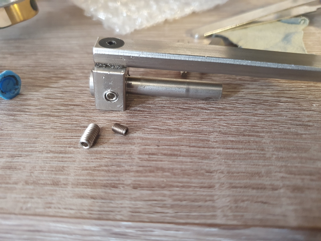

He is changing out that 3mm set screw to the larger 4mm for safety reasons. There is a lot of pressure on the pellet probe and that 3mm set screw, and there has been at least one reported failure of the 3mm screw, where the probe shot backwards causing damage.

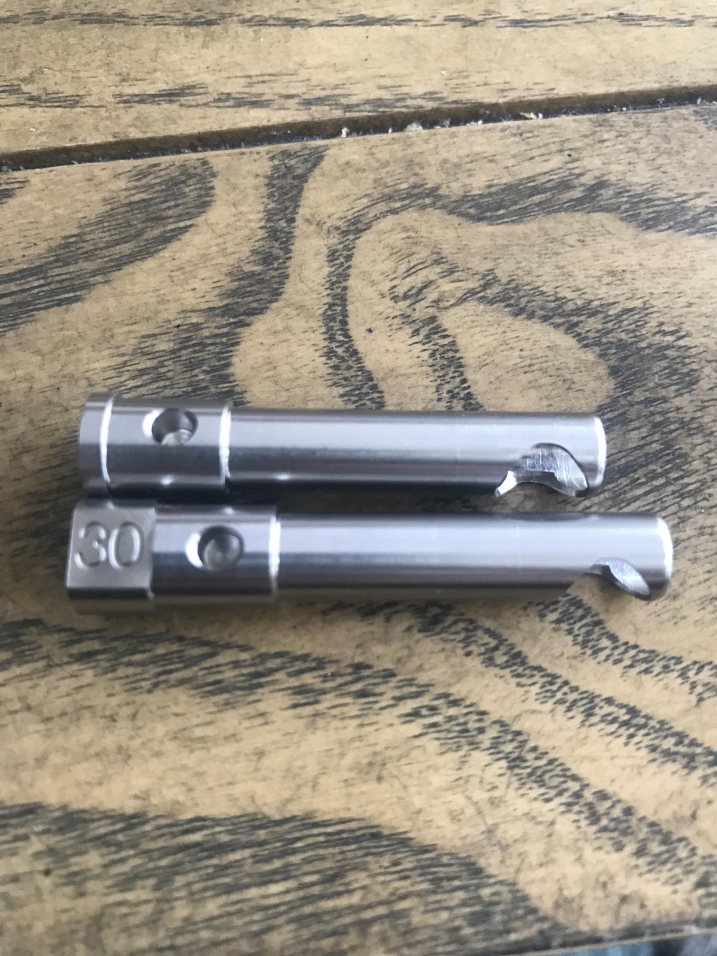

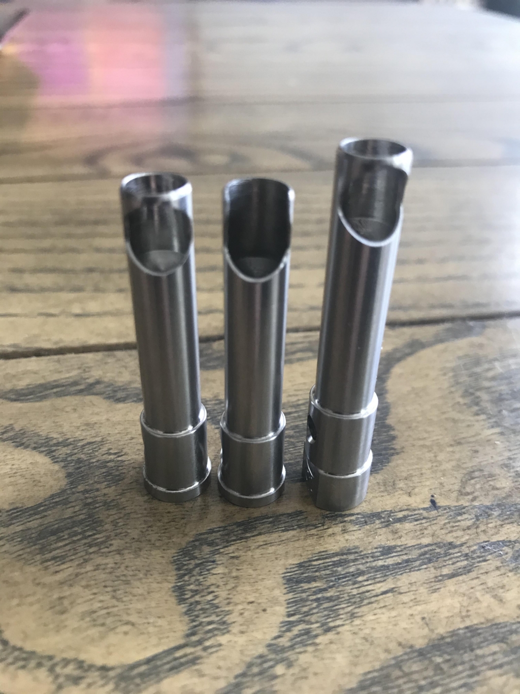

I was organizing some spare parts and I notice a different size probe that I bought without realize the difference.Three of them are for 30 cal . The first and the second I used them already and fit to my gun( impact x 3 generation). The third on the right side is bigger in the length seems stronger and the bottom ( neck ) is different . With a first look seems that is not matching to my probe holder . Even if it can fit will change the the pellet/slug position In the barrel because of its length.

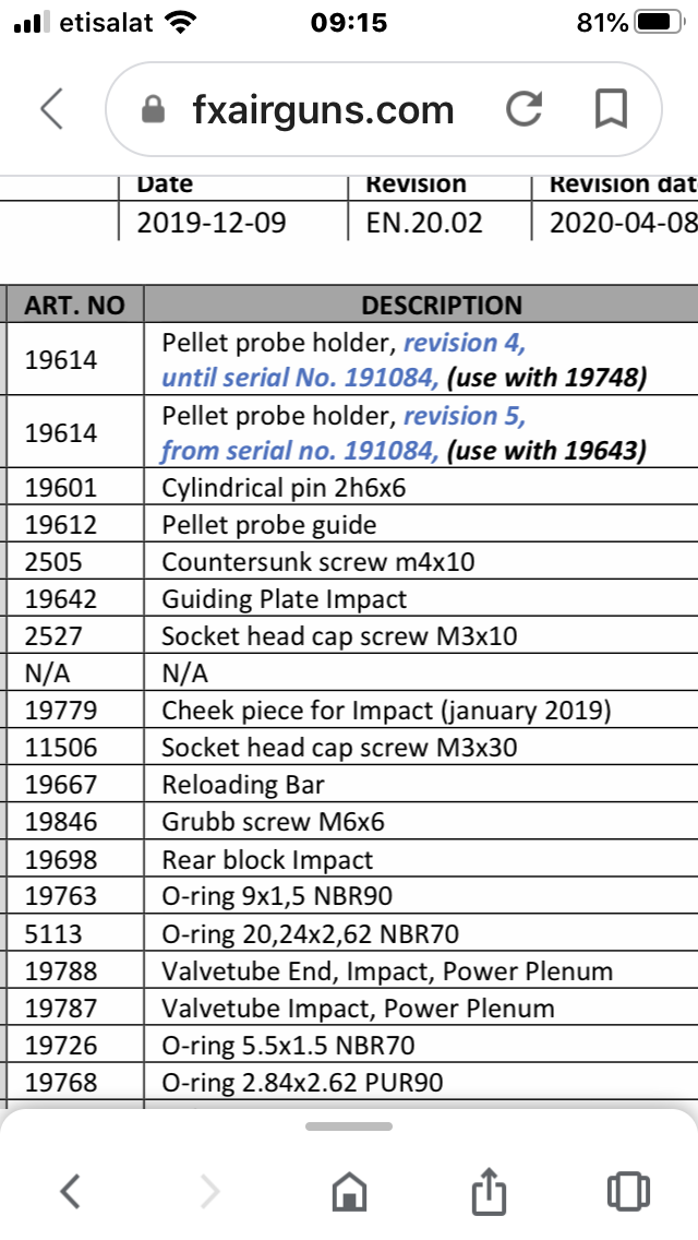

I knew that fx Improved the problem with m3 screw and they change it to m4 but I didn’t knew that they change and the pellet probe size.. So I opened the last fx diagram and I found that they changed as well and the probe holder . There are 2 types of probe holder . Obviously this probe I bought by mistake it fits only in the new improved probe holder.
They mention in the diagram that there are 2 revisions probe holders according the serial number of the gun but they have the same code 19614 and the retailer is confused and he doesn’t even know about this difference. Is a little bit confusing . I think it could be more clear if fx could change the code and add something like “19614-1”or whatever more understandable.
