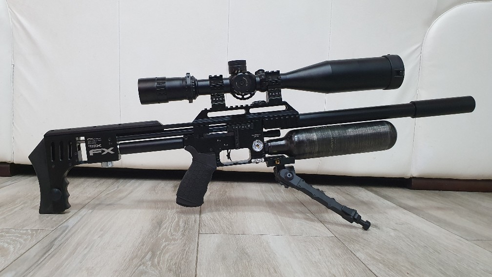

Beside that, just received from Johan FX new mk2 plenum and valve housing. Interesting thing about VH is that there is no valve seat ring.
Valve seat is integrated in VH ... and dia inside is 6.35 even maybe 6.5mm ... I cant measure it since is deep insode.So, I believe no more isue with VS.
Finaly, my Impact x has become Impact X mk2.
Will be fun to test 70cc plenum and see where we go with it.
My beauty and the beast

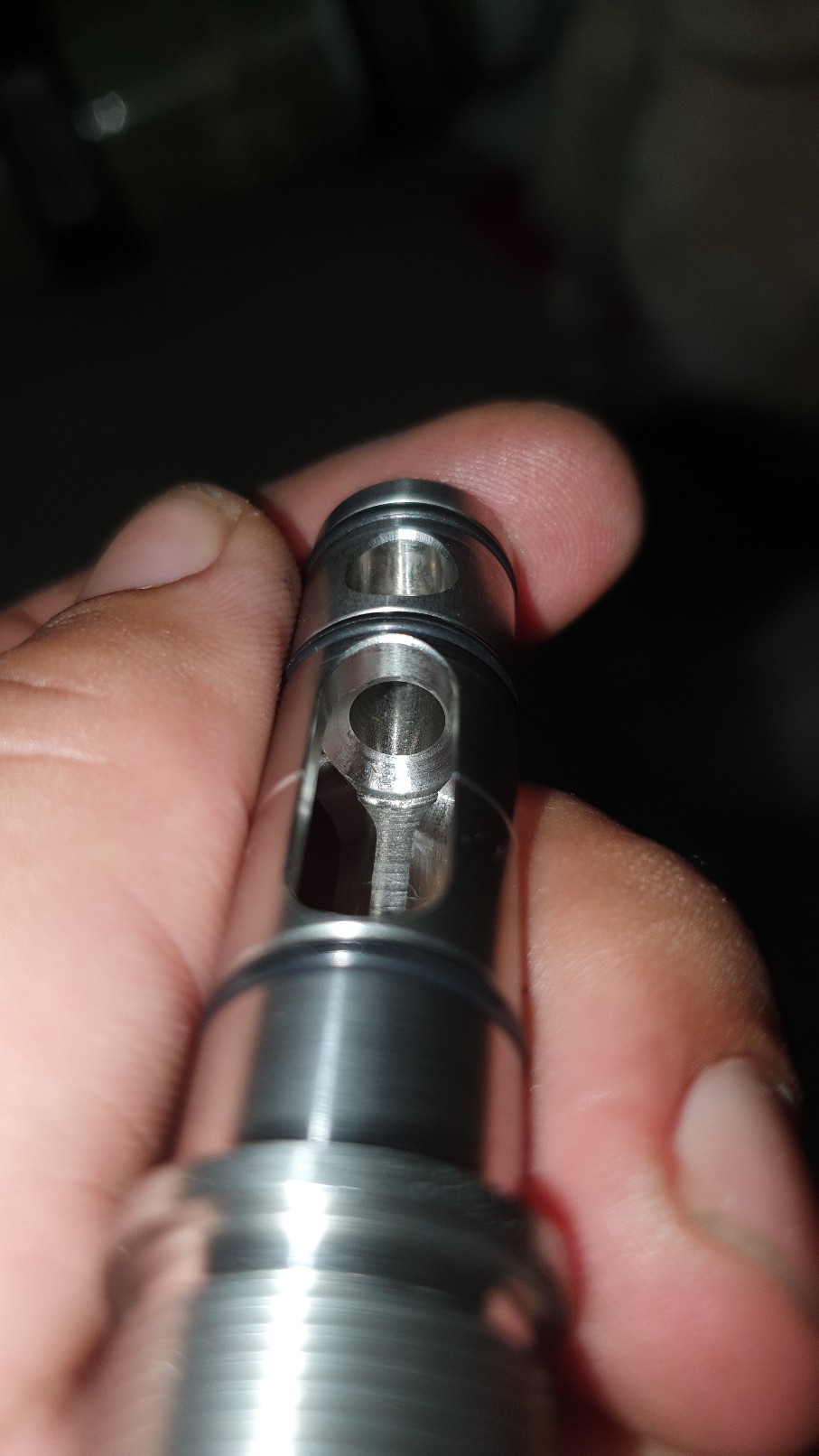

Can the transfer port mod can be improvised for more fps gain (pic below). Cuz i am getting around 945fps with 25 grains at 150 bars with the new valve housing and additional plenum of mk2.
I am also unable to install the 5.8valve seat in the new housing because its already built into it unfortunately.
Need to know if the below porting can be improvised. Thanks
If you have the integrated valve seat it's opening is 6.35mm. No need to go larger for your caliber.
For the porting you need to work on the port and pellet probe. Measurements in this post > https://www.airgunnation.com/topic/fx-impact-mods-for-more-fpe/page/29/#post-537397
