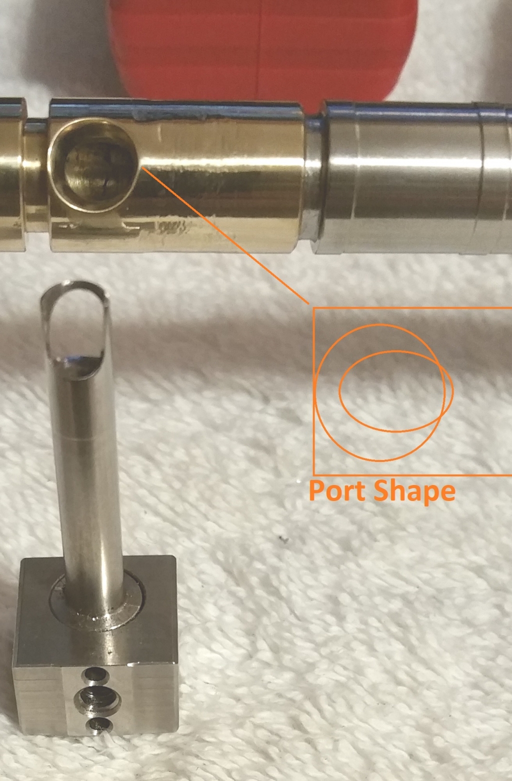

Ok but I believe you can get this speed under 140 bar. Here is a picture and drawing of the modified port if you need it. It's best to cut with a 1/8" carbide burr in your rotary tool then switch to something less aggressive to finish and polish. You don't have to take the top off the probe but it helps. A 7mm port feeds the brass one so you want the brass opening a little larger. You should not be able to see the pellet probe edges through the brass port. These dimensions work well for me.

When I go to amend the brass TP of my friend Wajih's Impact, I find that some measurements are missing in the picture referred above.
Outer hole size is 7.4mm. Inner oval shape has length of 6.3 mm and width of 5 mm.
But what is the measurement from where the oval shape has to be started with reference to round outer hole?
This measurement appears to be missing due to which I am reluctant to amend it.
Further will you please let me know that if you have done it on CNC or what other machine ?
Regards,
Umair Bhaur
Start at the outside making it 7.4mm then make the elongated portion and then smooth the transition between them.
I do this with a li-ion rotary tool and a carbide burr, second one from the right in pic ⑲.
Polish the area last using a felt tip and red polishing compound.
Use low to medium speed when removing metal for best control. Polish at high speed.

Regarding the brass TP I’ve seen that ER does it in a different way. He rather prefers just to elongate the TP starting at the breach end, just were the o-ring groove begins and then he goes up to 7mm towards the muzzle end. Then he elongates the pellet probe too but going backwards and not cutting it in a half moon shape. There are quite a few videos and pics on his Instagram account. I’m not quite sure on which way to go. Any thoughts?

The best possibility is a full bore sized transition from the transfer port into the bore. Removing the top of the probe gets you closer.
