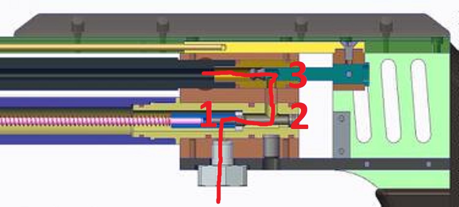

regarding the plenum, looks good, and will help a lot. The Ernest Rowe one IMO is a bit more efficient since the air goes to 1 90 degree angle instead of 2.
Don't you have that backwards?
Nop (unless I am missing something), the original ValveTube / Plenum, is parallel to the barrel with the air travelling to the oposite side of the barrel, so makes two 90 degree turns to reach the barrel (180 degree in total), same as Michal integrated plenum. (Impact it is designed like that, otherwise will be a long barrel airgun like the Dreamline specially with the 700mm)
ER plenum is attached directed in the block facing up, so it makes only one 90 degree turn to reach the barrel. (No exactly under the TP on the block, but close, enlarging to m14 or M16 helps a lot)
The external still makes a 90 into the valve so that's 3 for external and 2 for original location.
Yeah I feel that less turns and one source for the plenum air would be more efficient and higher flow than two sources converging making turbulence w eachother. Also I like the plenum looking like original just larger. IMHO Id use either one to get job done but aestheticly the larger original location would be my pick. Just my 2¢.
