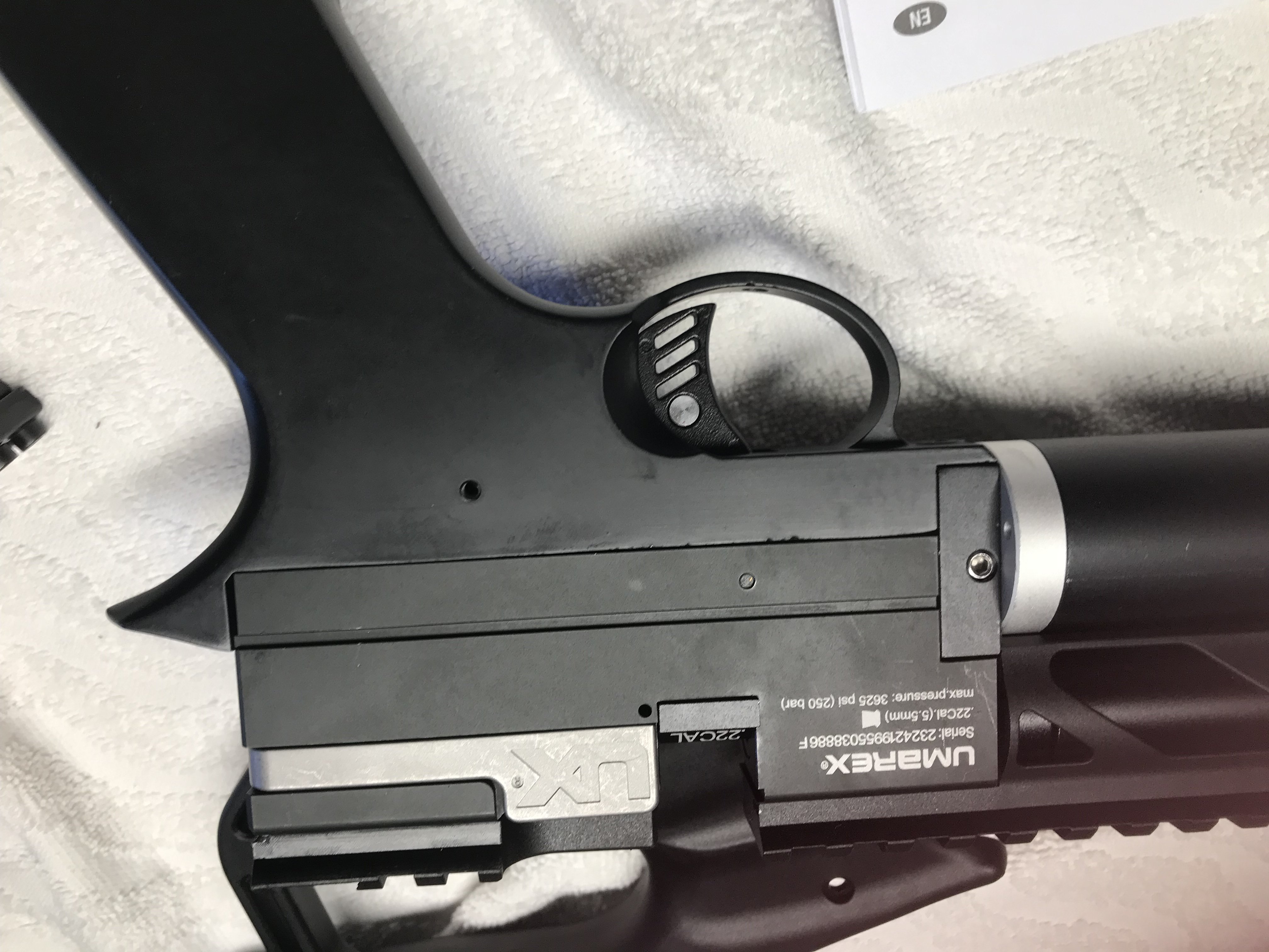

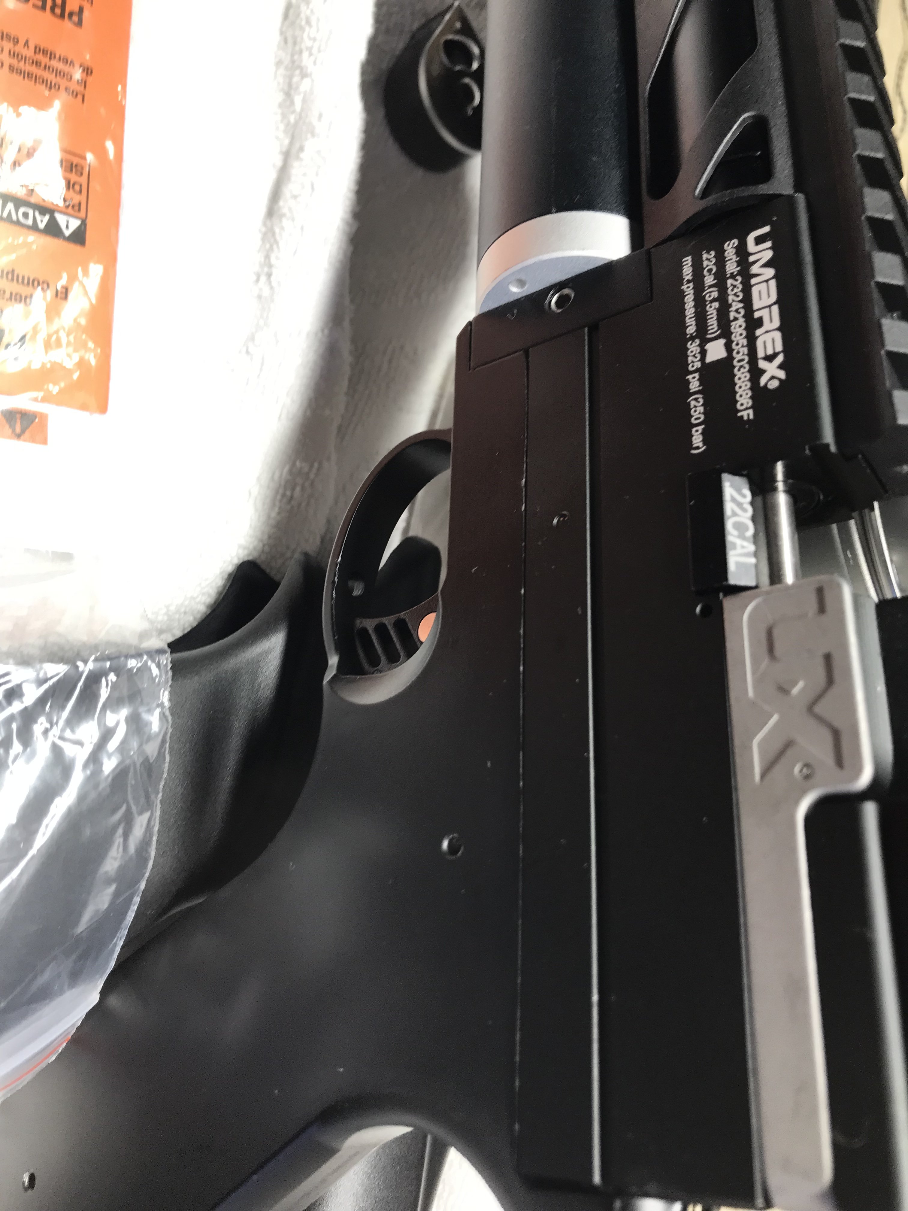

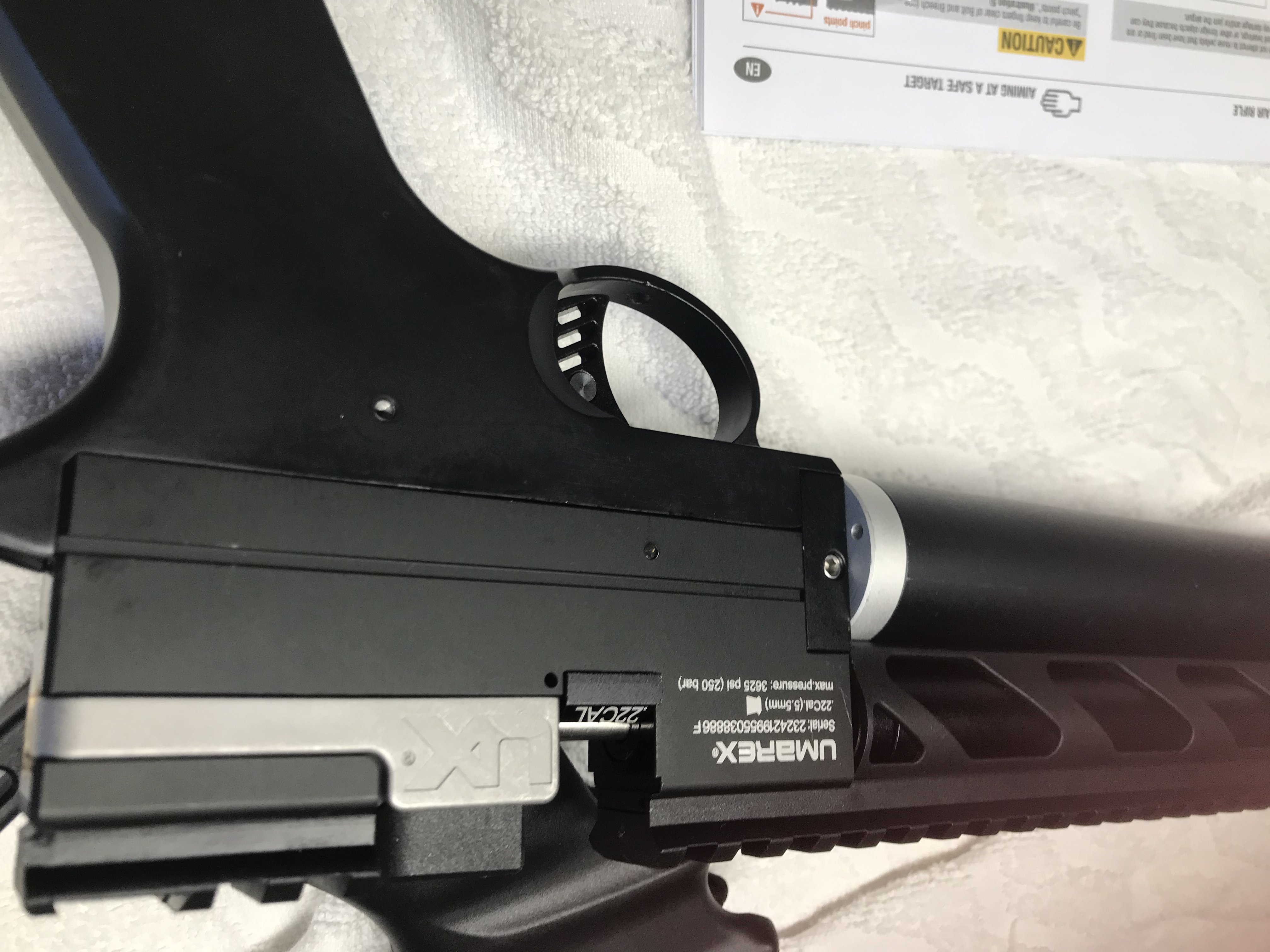

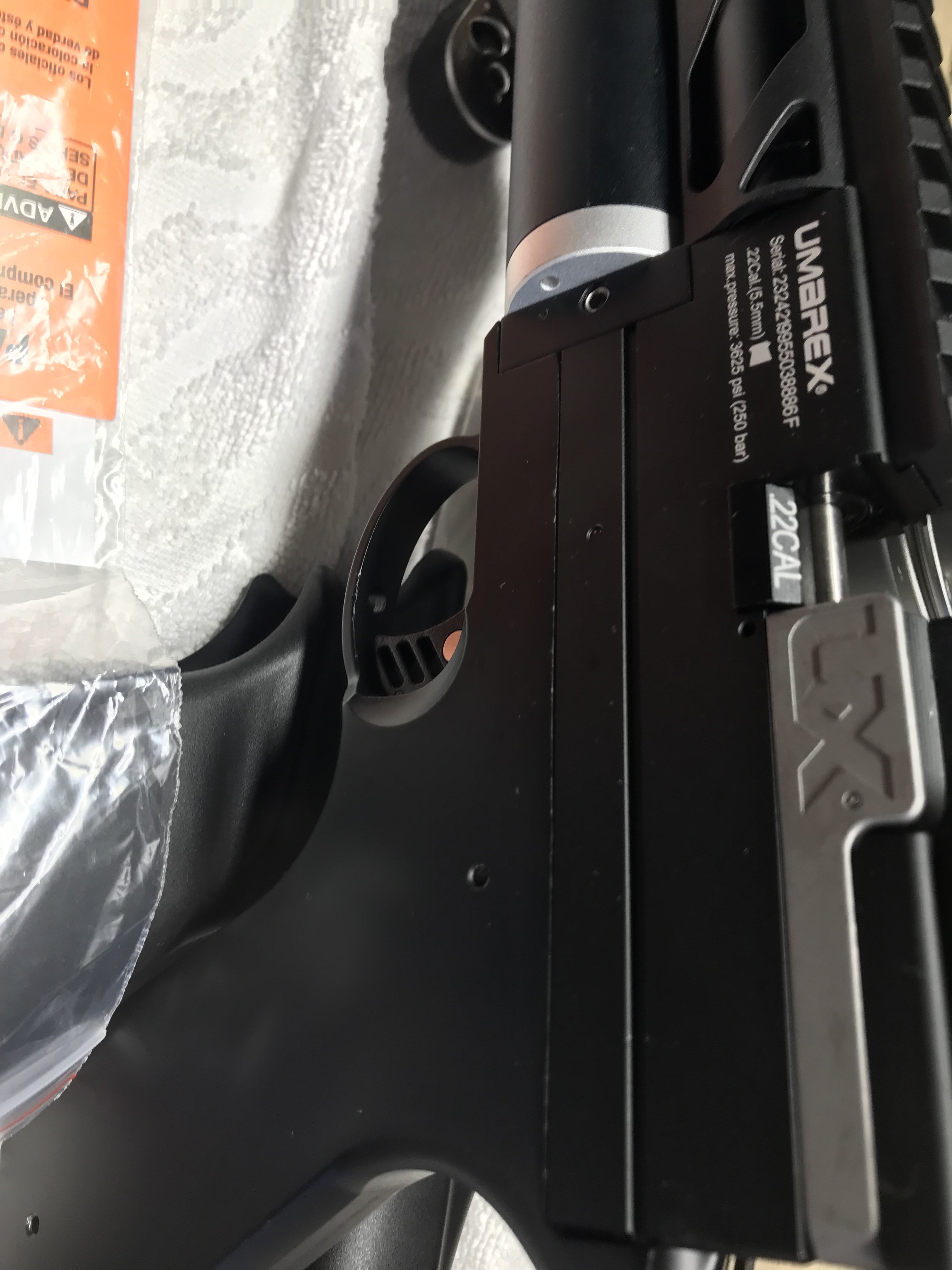

I recently purchased everything to start up my first pcp
Notos 22
Wingman carbon fiber bottle
2 tins of pellets
Cleaning kit
Very excited did all the research saved close to $800 decided to order all from UA, everything arrived pretty quick.
Upon opening noticed right away Umarex notos cardboard box was previously ripped open, partially aired up,chips and pry marks covered up by a sharpie ink pen, couldn’t see through the plastic on the seven shot magazine and clearly see where optics had previously been mounted, big bummer! Immediately called UA they wanted pics I sent their reply was look’s ok nothing out of the ordinary, bigger bummer.
Spoke with Umarex curious if they shipped out used rifles NO.
Every time I see my rad Umarex notos my eyes are drawn to all the blemishes like a bad car accident.
Here’s some pictures
  • Wow
