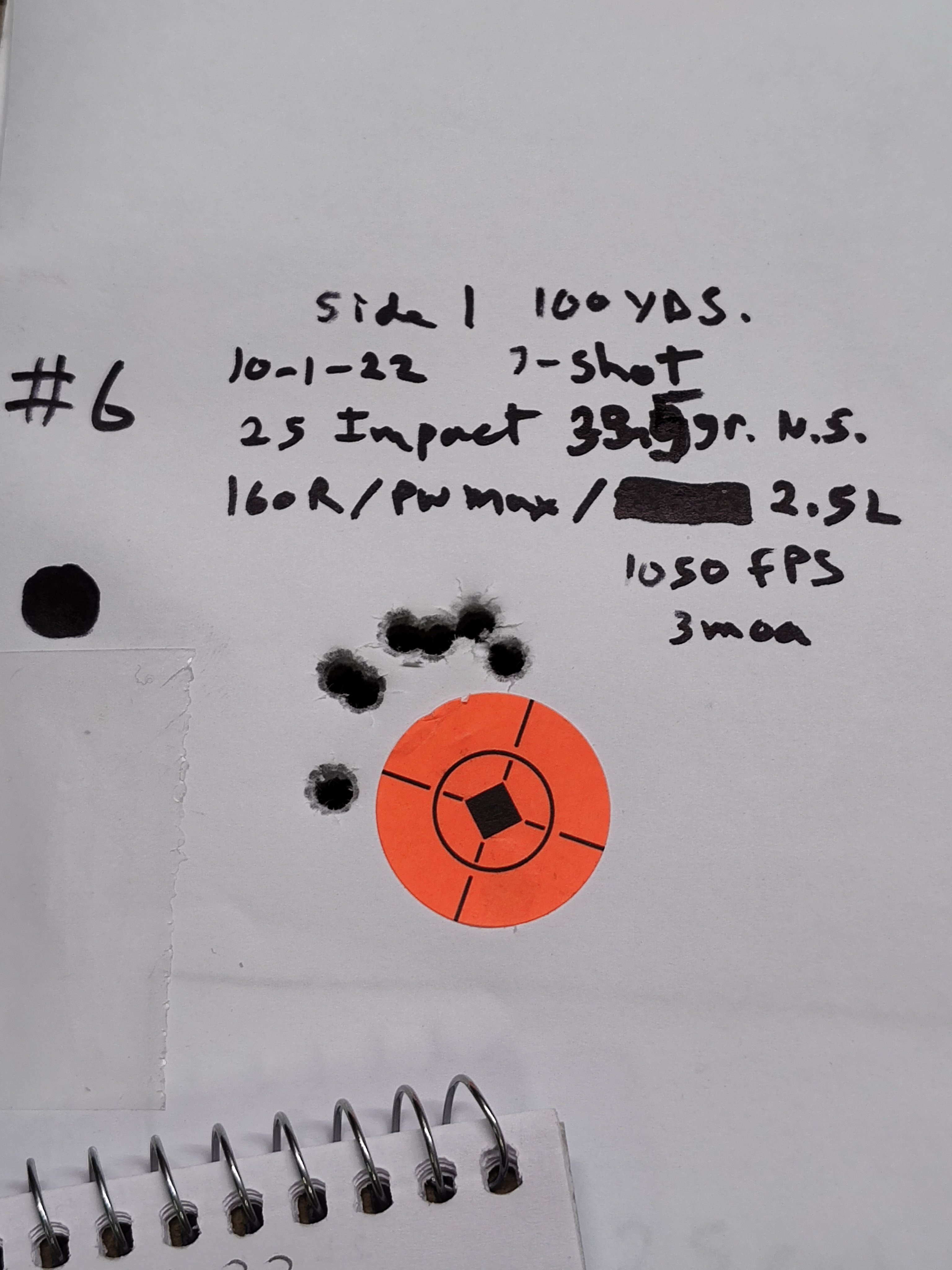

33.5 gr. Nielsen slugs -Standard 700 mm liner - FX Impact - Orange sticky is 1" dia. - 100 yds.
Never had good luck with the Hybrid 26 gr.
