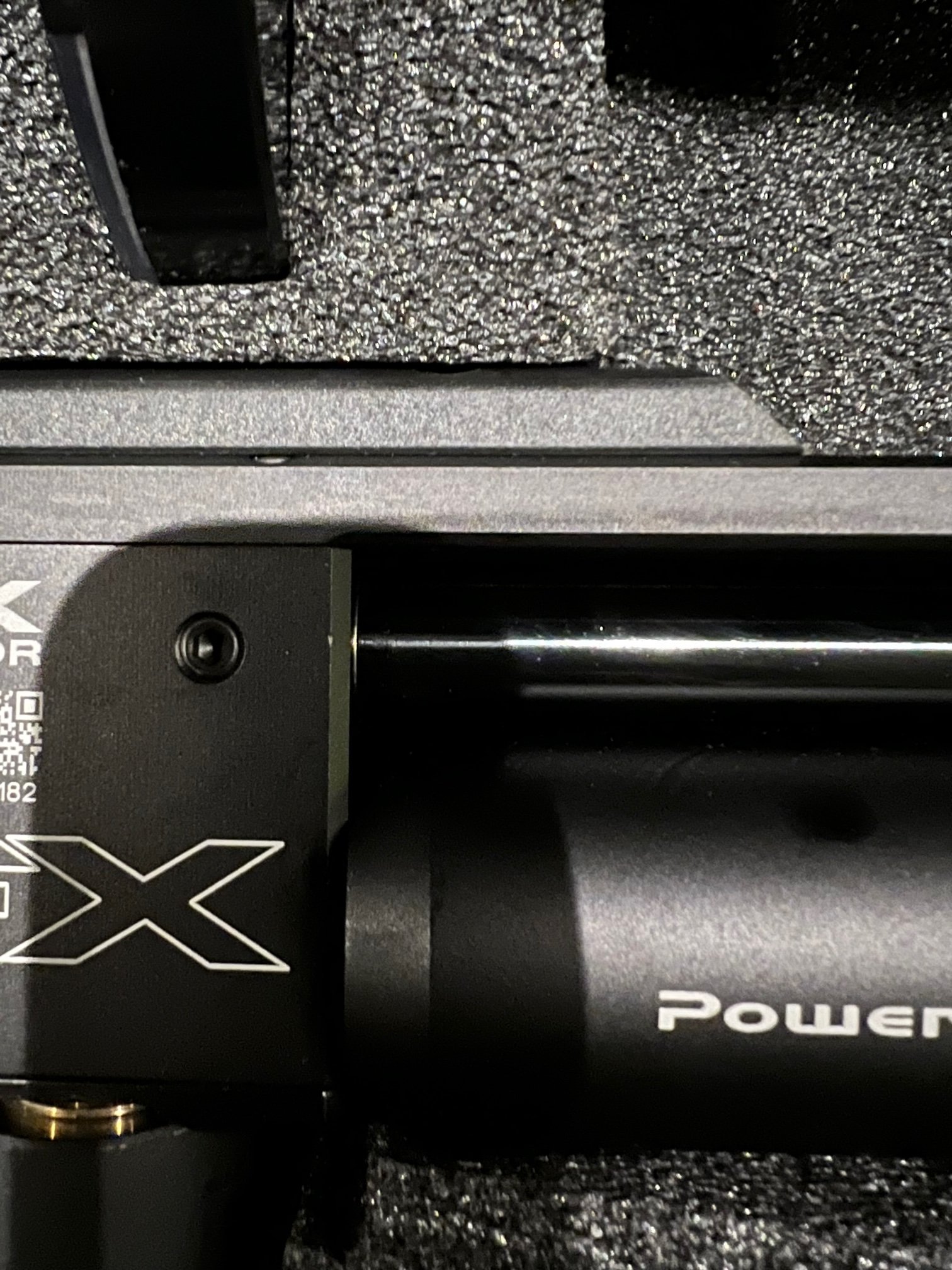

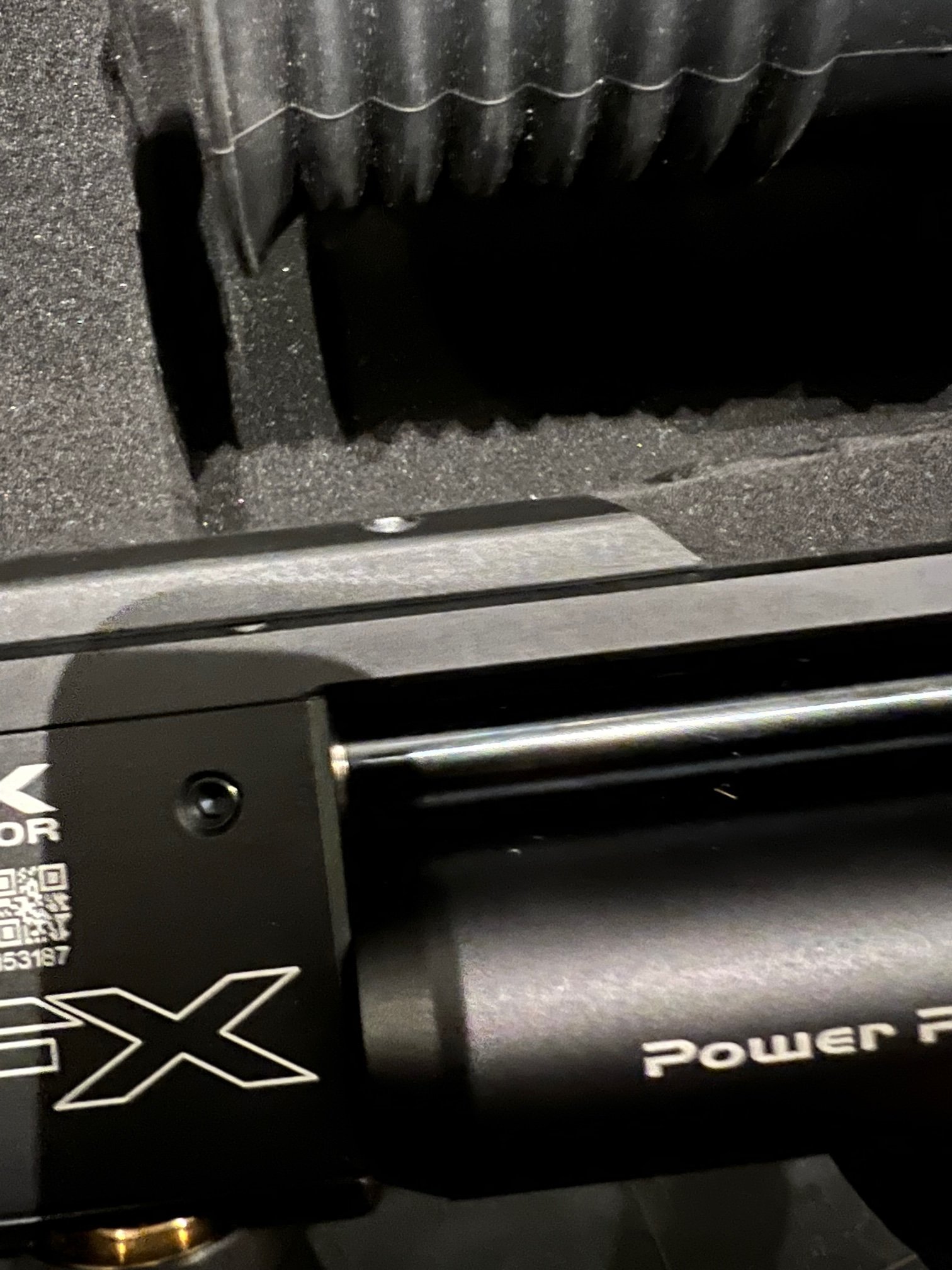

Took some photos as comparison:
Huma Air Dual Hole installed, you see a small silver line:
Original FX (My dads FX M3 .30). bigger silver line:
As if the Huma Dual sits back deeper, but when looking at the actual probe insert (bronze transfer port), they are both equal.

I see what you mean now. Loaded up a pellet from the magazine and took the barrel out to see how it fits:
Looks like it's properly pushed in.

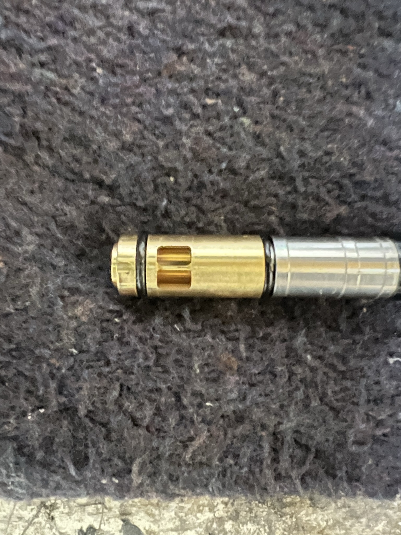

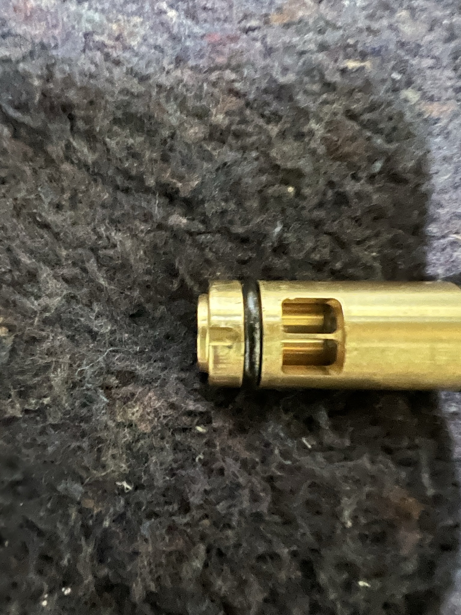

Next step was marking the probe on how it sits on the transfer port:
Pellet was already loaded before I took out the barrel and probe, couldn't even push in the probe further. So this was not the problem (can even see the sharpie markings.) Huma Dual Hole + Pellet/Slug probe fits perfectly!
