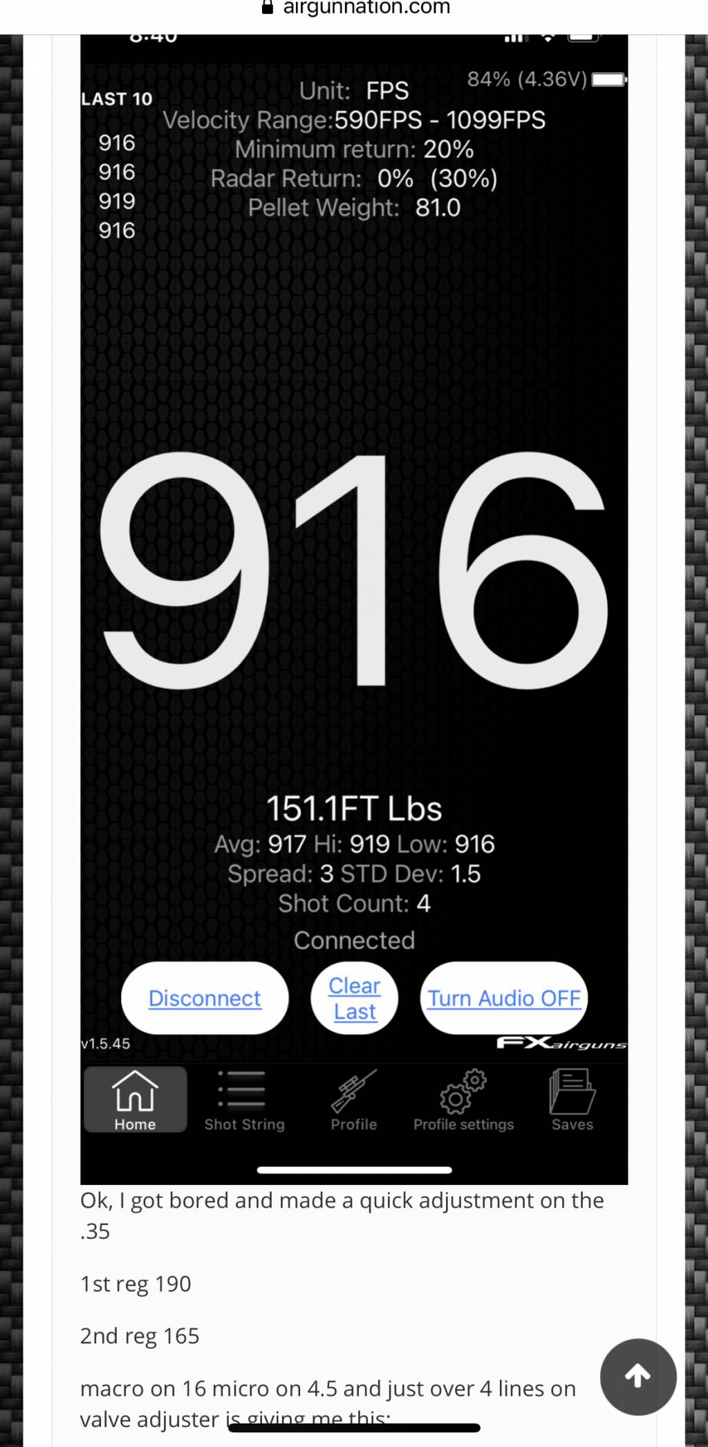

Awesome work you have put in. I can share my results with the M3 in .35 and I know a few others have the .35 as well and we have been pm each other with our results. As you have noted not many have or post about the .35. I have sent emails to FX about the heavy liner for shooting slugs and have told they are working on perfecting it at this time although the .35 platform has been out for over a year.
I installed the NSA probe but have since removed it because I didn't see any real gains from it at the present time: I'm waiting for the slug liner to use it. As far as settings go I have been able to get the JSB 81gr up to 916fps and gave the tune in the tune thread for M3. When i tried to shoot with the nsa pin probe the rifle had a weird sound so i switched back to the regular probe and didn't see any loss in fps. When at the range the initial groups at the higher fps were terrible and I ended up dropping the fps to @870fps with the jsb pellets and groups at 100 yards were great.

That tune is very similar to what I found with the 35 and JSB's. Only real difference is I set the 1st reg slightly lower to about 145 bar. It seemed to help a little on reg creep. I adjusted the valve adjuster in until I was getting around 858 to 860 consistently. After the gun sat for a bit, the shot would be low 850's

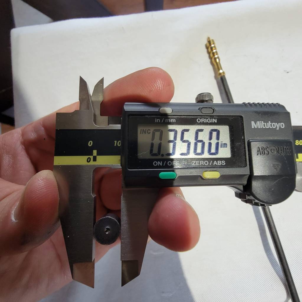

So I went out and performed another test with the 9 gram hammer installed this time. The first reg was some where around 185+ bar. I also discovered removing the two rubber balls and piston stop really has little effect with this setup.
I first went through with just the hammer installed from 130 to 170 bar. I did nearly the same thing with the two rubber balls and piston stop removed. However, this time I stopped as soon as the velocity drop off.

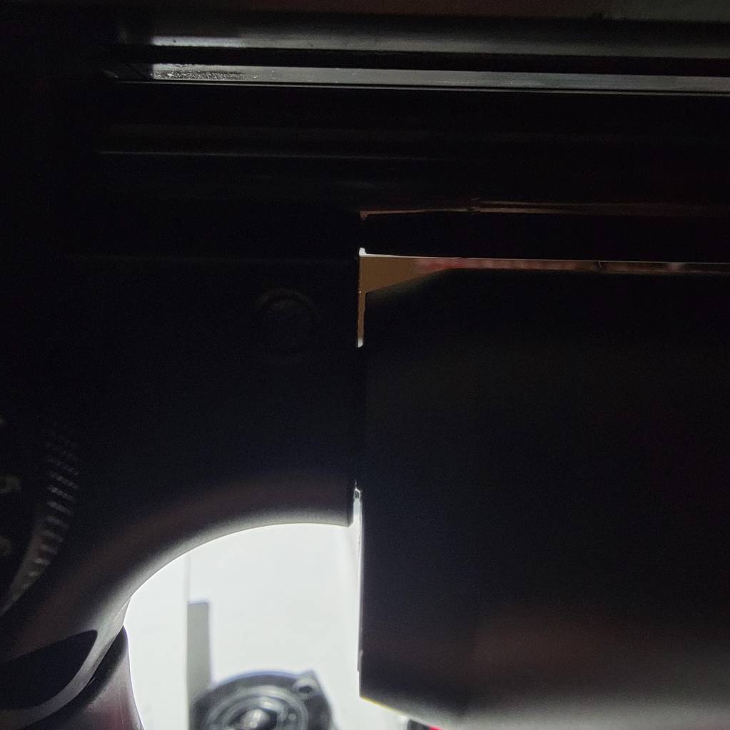

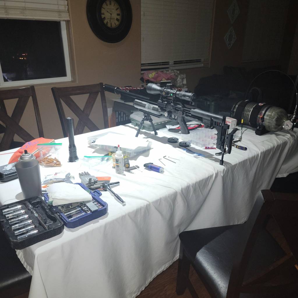

Tonight I stripped the gun down. Upon re-assembly I thought of a way to get the C1 to measure just over 5.5 mm from the frame. Bare in mind it was originally 6.13. I am now around 5.6. I cheated around .5mm at the power plenum. The top rail (A6) has plenty of play and doesn't stress the other parts when screwed down. The holes lined up the same as before. I am very cautious about causing un-needed torque anywhere on the gun when I put it back together. Last, I re-adjusted the cocking linkage (B32, B33, and B17) length and the NSA slug probe depth.
Fx informed me the C1 should measure 5.5 to 6.5 off the frame. Mine was as tight as I could get it at 6.13mm before. I am curious if the extra half mm will give me a little more valve time, since the hammer will open the valve sooner. Maybe the fps will jump some.
I will check tomorrow sometime and report back. The gun is ready to roll and nothing bad happened with 4 test fires of the gun. Wish me luck lol.
Below is a photo of the change. I suggest using a micrometer and feeler gauges to set the spacing if anyone has the same issue.

My wife thinks I am nuts and have a problem, since all I do is take up her table space and tinker all day. I can't help but seek perfection.
😂, I've been pushed to the garage.
