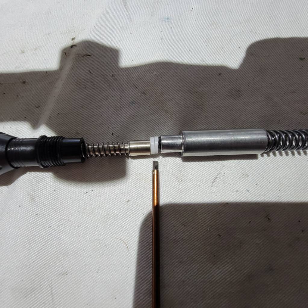

Can anyone who owns the FX M3 in a 35 cal let me know if they have a spacer where my tool is pointing at the 2 delrin spacers.
The spacers did not come with my gun and I am wondering if the additional preload has anything to do with the velocities.
For those new to viewing this thread, I placed those spacers there to show an idea I have.

With that mentioned, Scott and I discovered my gun was built with the wrong parts on the valve assembly. Specifically involving the C1 (#C52) and the hammer (#C53).
On the .357, the delrin spacer (#C53) is supposed to be attach to the C1 and not the hammer. By doing this, the hammer doesn't have the delrin insert, so it weighs more. The cavity/void the insert is pressed inside of on the hammer, is instead solid piece of metal because that void doesn't have the material removed.

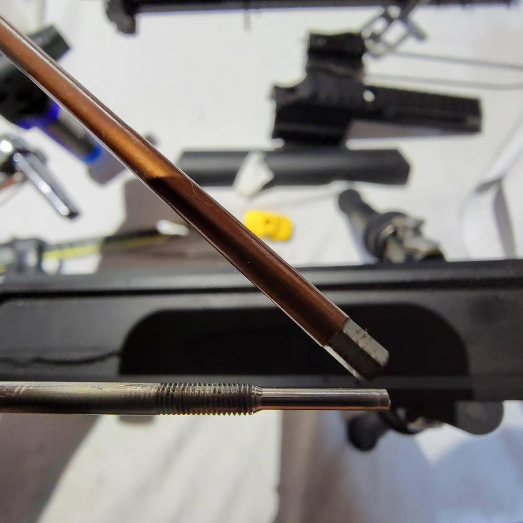

We also spoke about the valve rod the C1 screws and attaches to. If you recall, I could only get 6.13 mm off of the block. He suggested I slowly file it down until the C1 can bottom out at the 5.5 mm measurement.
Looking closely at the rod tip, you can see it was manufactured a little long. I didn't notice this before because I didn't look that close.

This evening I was able to file the valve rod tip down to where the C1 measured right at 5.5mm. Ironically, I had to file to that distorted spot in the photo I posted previously.
