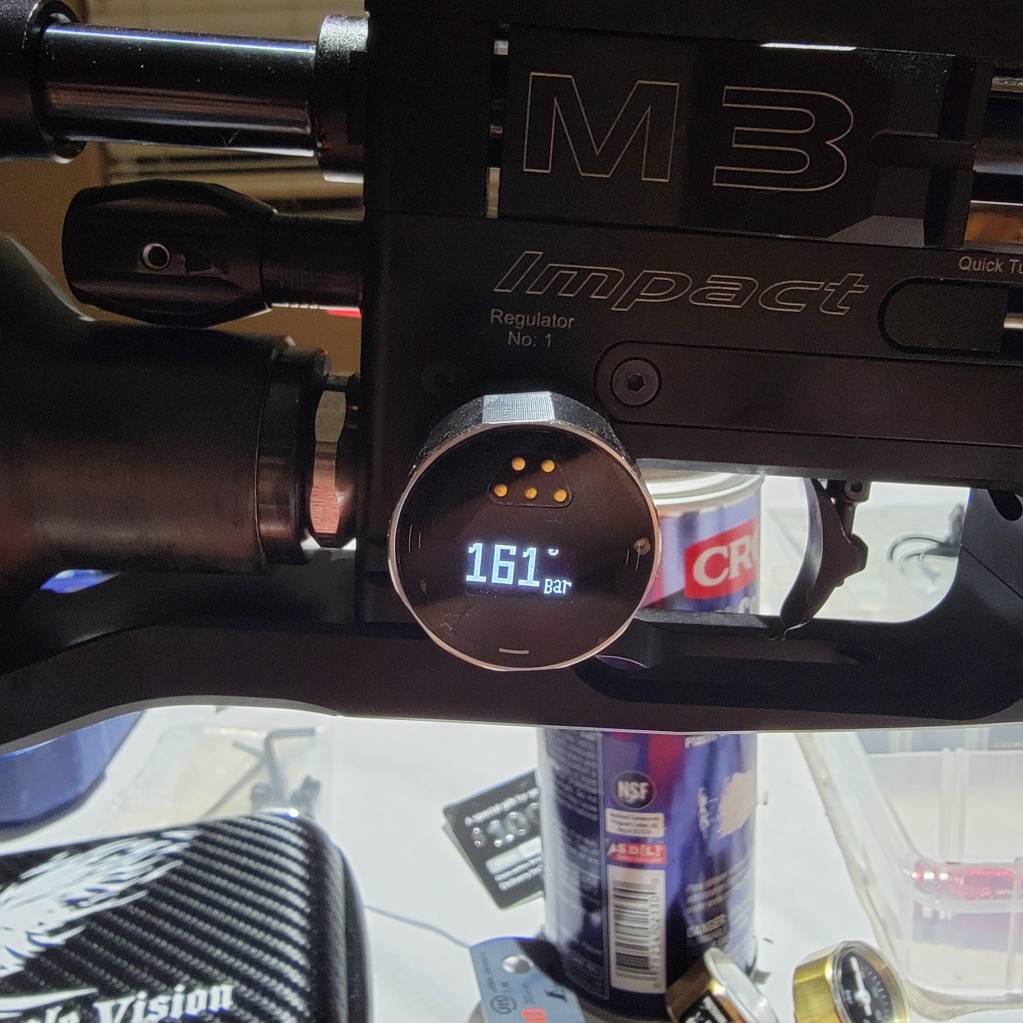

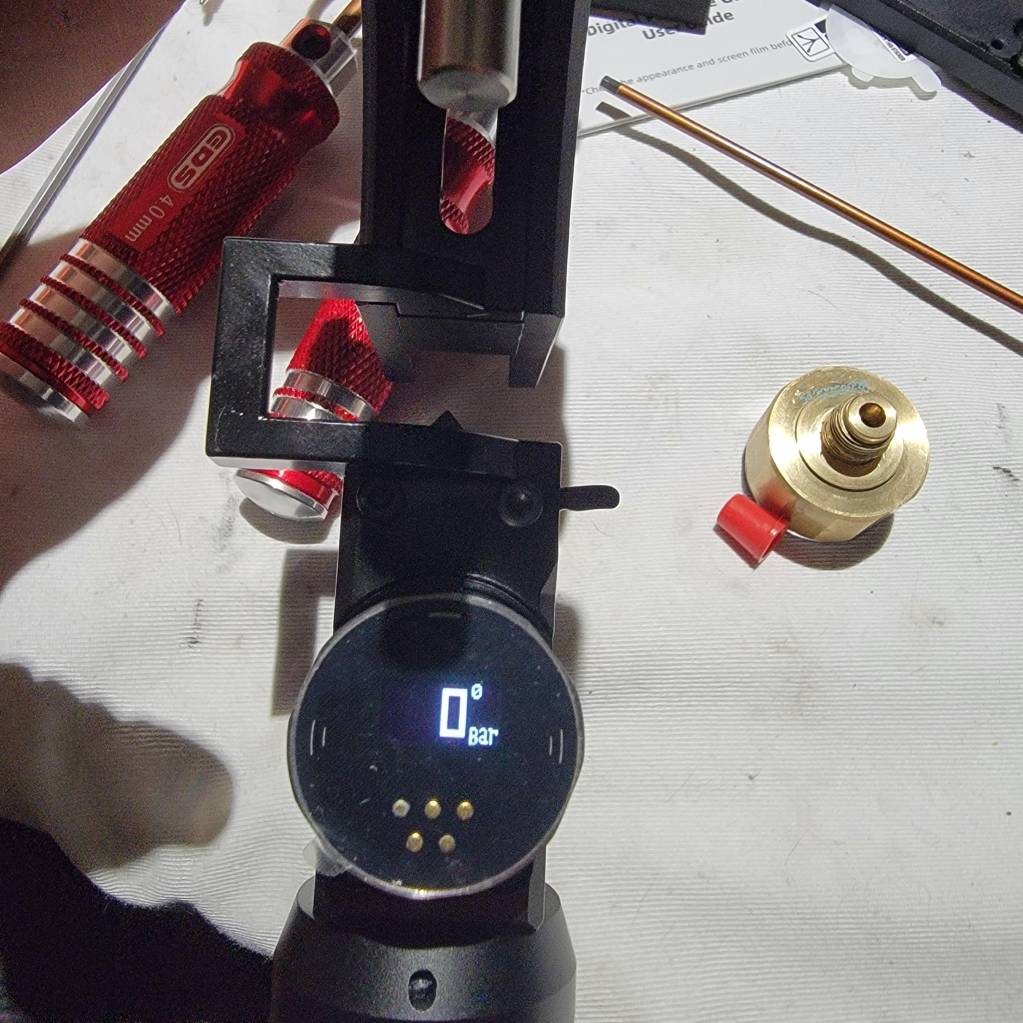

Well, when I got home tonight my Sekhmet gauges showed up, so I installed them and replaced the blown o-ring.

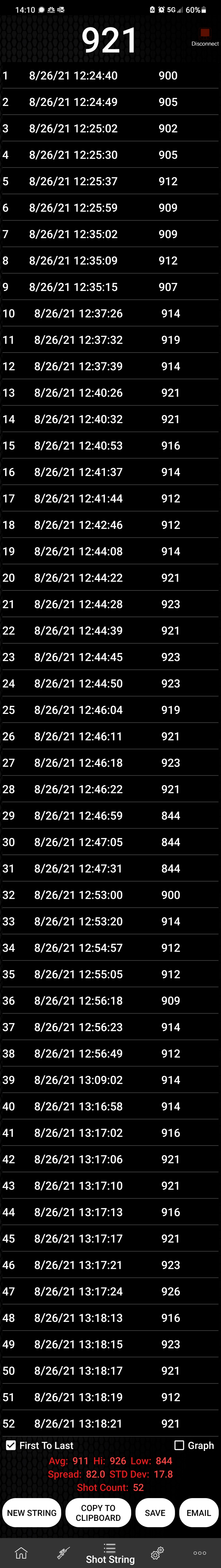

So today I installed the two washers with the 9 gram brass hammer installed. If you remember, I also recently shaved the rod the C1 connects to slightly so it would measure 5.5 mm off the frame. My hammer now has close to 3 grams over the weight from the one the wrong one gun came with. Below proves parts make a big difference.
I set the macro wheel at 16, micro adjuster set as far as it will go for the gun to engage the sear and the valve adjuster opened up to imaginary line 6 or so. 170 bar 1st reg, 152 bar 2nd reg. Any higher or lower reg pressure and I lost 5 to 10 fps. Peak speed with 81 JSB's was 926 fps with most around 921 to 923 fps. 93 grain NSA's showed 844 fps, but I only was able to shoot a couple because I am out. I would not doubt some may hit 850 fps if I had more to test.
If you recall I hit 835 fps with NSA's and 909 fps with JSB's previously.
I ordered some more 79 and 93 grain NSA's, which have already shipped. I purchased some in .356 and .357 sizes to try.
In summary, my theory is proving it takes more hammer weight to open the valve with high reg pressures. The distance/space beween the hammer and sear is limited. With heavier hammer weights, you gain hammer length, which limits the micro adjusters availability of travel adjustment. Mine is currently only able to go to 3.1 or so before it peaks, due to the brass hammer's length. I wonder what material FX uses for the hammer? A denser metal, which weighs more may prove to be beneficial, as would lighter valve adjuster spring or heavier hammer spring. Perhaps a smaller spring inside the hammer spring and to the rear of the hammer weight would aid in even more hammer spring power...hmm.
My next purchase is going to be the Huma 2nd stage reg, as the FX one seems finicky past 140 to 145 bar. Hopefully Huma will come out with a first stage one soon too. Past 155 bar on the 1st stage and the reg gets finicky too, as it bounces up way high before dropping back down slowly.

Another thing I noticed and will start paying more attention to soon, is at this setting the gun uses about 4 or 5 bar a shot.
In theory a full mag will burn approx. 90 bar for 18 shots. At a full fill, it would put shot count around 18 to 20. More testing will be needed to confirm this, as it was just something I noticed.
Also when analyzing data for the 81 grain JSB's,
130-135 bar 2nd reg yielded 880's to mid 890's with wrong oem valve parts. Low 900 to 905 fps with NSA slug probe installed. Very neglible difference and may have been in the tuning.
130-145 bar with a 9 gram brass hammer weight, no washers, and NSA slug probe, yielded slightly better fps and peaked at 909 fps.
150-155 bar with 9 gram hammer weight, two washers installed (9.86 grams total weight when combined), and NSA slug probe, yielded 926 fps peak.
An approx. 20 bar increase netted 20 to 30 fps gain with the NSA slug probe installed.
Regarding efficiency, I have know idea how long the valve remains open during the shot, nor do I know how much of the air in the power plenum is being consumed during the shot cycle. However, there is 15-20 bar with the factory 2nd reg still available and maybe more with the Huma reg installed. The trick will be figuring out how to open it at the higher bar level to gain even more fps/fpe.
Following the aforementioned logic, the extreme Huma goes from 135 to 200 bar. If one were to purchase a new 300 bar rated air tank (simply for the sake of shot count), there may be the potential to fling the JSB's at 1000 fps if you could get the valve to open at 200 bar. This could also put the 93 grain NSA's into the low to mid 900'-950 fps range.
Just some food for thought.
