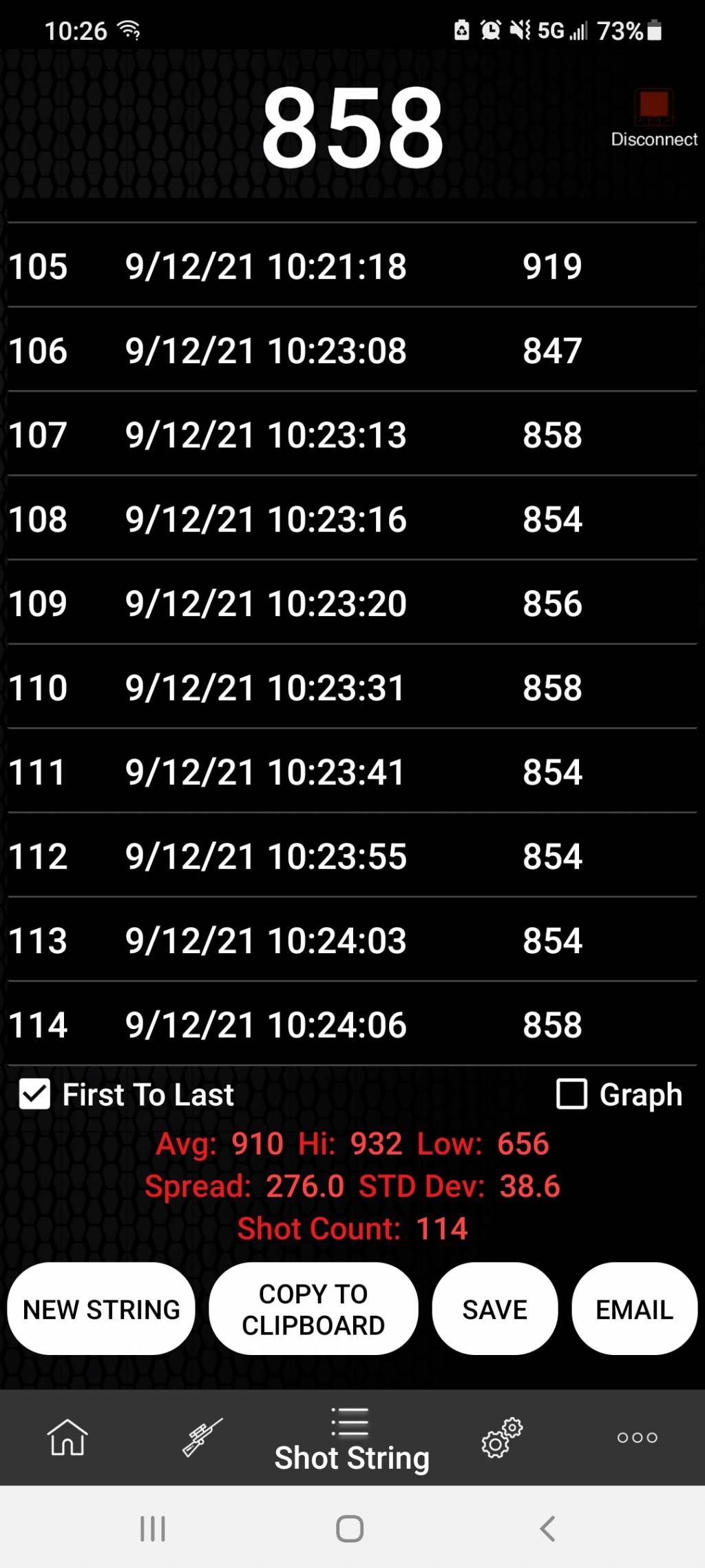

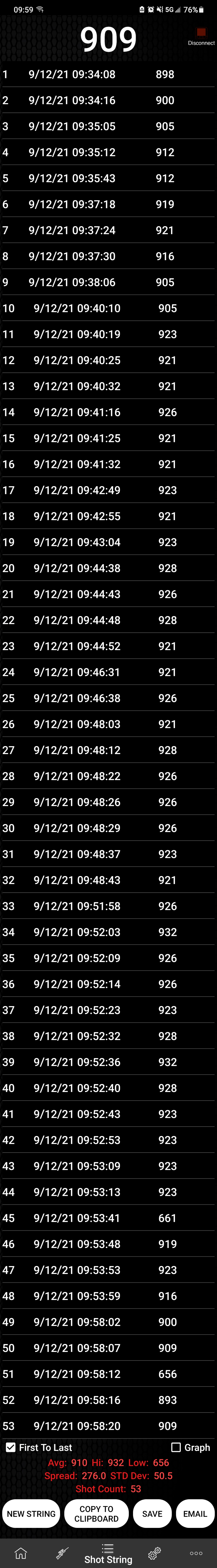

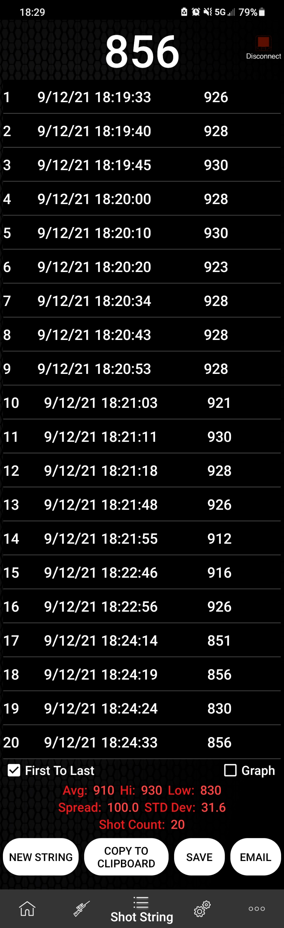

1st reg 180 to 200 bar, Huma 2nd stage regulator, sekhmet digital gauges. 9 gram brass hammer weight, with two washers, and the new 19.26 gram hammer. This shows the combined weight of the hammer is critical. The couple 660 fps ones were me screwing with the micro and accidental double feeds. It is quite picky at max settings. I get about 3 to 3.1 max on the micro with this setup. Very consistent speeds though when set right.
134 bar 900 fps peak
140 bar 912 fps peak
145 bar 921 fps peak
150 bar 926 fps peak
156 bar 928 fps peak
168 bar 932 fps peak
174 bar 909 fps peak

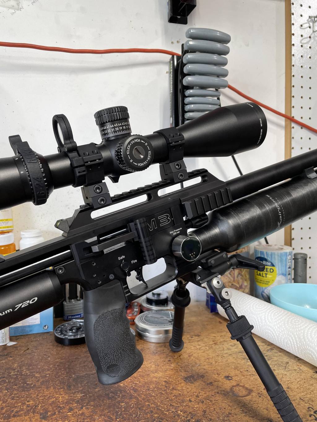

Yeah, I got tired of taking it apart and puting it together. Past couple days, I ended up just leaving the scope, scope rail, and cheek rest off of it for testing.
I am debating if I put it back together now or try some other ideas. The Tungsten inserts are really perking my interests. I may be able to get more micro adjustment range by using them with a modified hammer. I have 3 hammers now, so I can mess around.

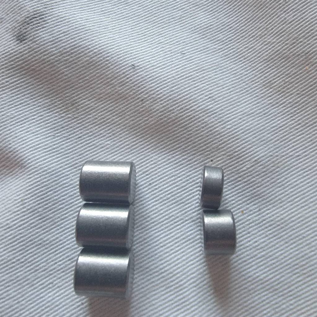

An 1/8 oz of Tungsten weighs around 3.54 grams. It is very dense at around 19g/cc, so an 1/8 oz is quite small.

You can see in my post that the hammer couldn't open the valve enough past the 168 bar peak and the velocity fell.
The 25.12 gram combined hammer weight from the factory yielded around 893fps at 130 to 135 bar and couldn't open the valve enough beyond it. It should be mentioned that with todays setup at that pressure range I hit right around 900 fps, as the heavier hammer is slightly more efficient I guess.
A combined weight, 28 gram hammer yielded 926 fps. 93 grain NSA's hit mid 840's fps if I recall correctly. This was in the 150 to 155 bar range before velocity dropped off.
Todays hammer weight of 29.12 grams peaked at 932 fps with 81 Jsb's, but really shined with the 93 grain NSA's, hitting 858 fps. These speeds occurred in the 165 bar range.
In summary, 4 grams of additional hammer weight yielded an addition 30 bar of pressure and around 35 to 40 fps in velocity. In theory, another 4 grams may be enough to open my Huma regulator at 190 to 200 bar. What I don't know is at what point does the weight of the hammer peak or become too much.

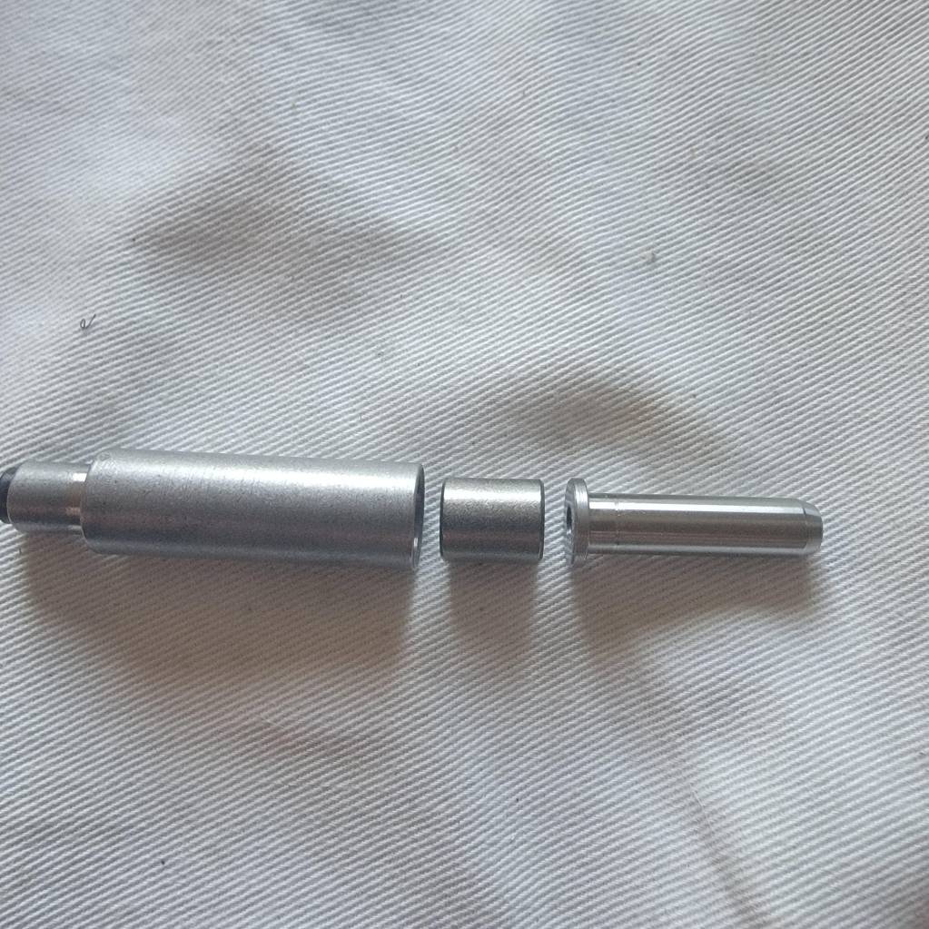

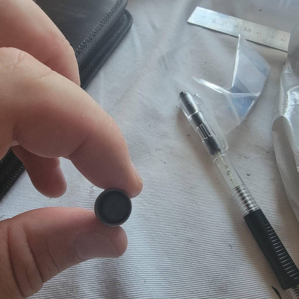

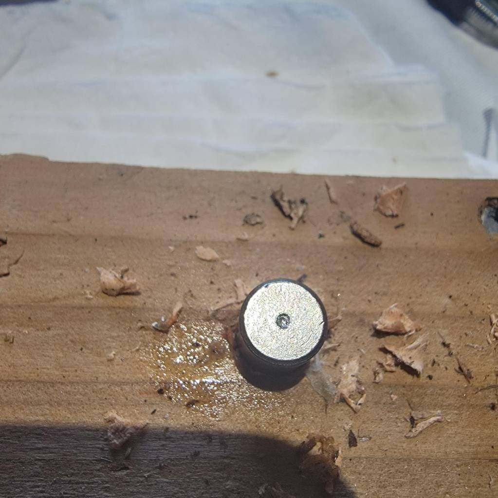

Here are my next thoughts. Below are Tunsten spacers in various sizes. From about 5.5 grams to 14 grams. Thought is to drill out the hammer enough to recess what ever size inside and epoxy it in. Maybe I will use probed 2000 gun bedding, since I have some laying around. From there, drill out the center hole to slide on the valve rod. They fit perfect inside the hammer.
The hammer void is approx. 20mm deep inside. If I drill that portion deeper, I could set the weight deeper inside and possibly allow more range of adjustment on the micro dial. It will definately be a trial and error type of project, but it sounds promising.
If I can't drill the tungsten, due to how hard it may be; I may try and see if I can get all of the parts (hammer, hammer weight, and washers) made out of brass. I am pretty sure the parts are made of soft steel, as they are magnetic. If so, steel has a density of 7.75 to 8 g/cc. Brass has a density of around 8.4 to 8.75 g/cc.
I am trying to develope a combined weight of 33 to 35 grams.
