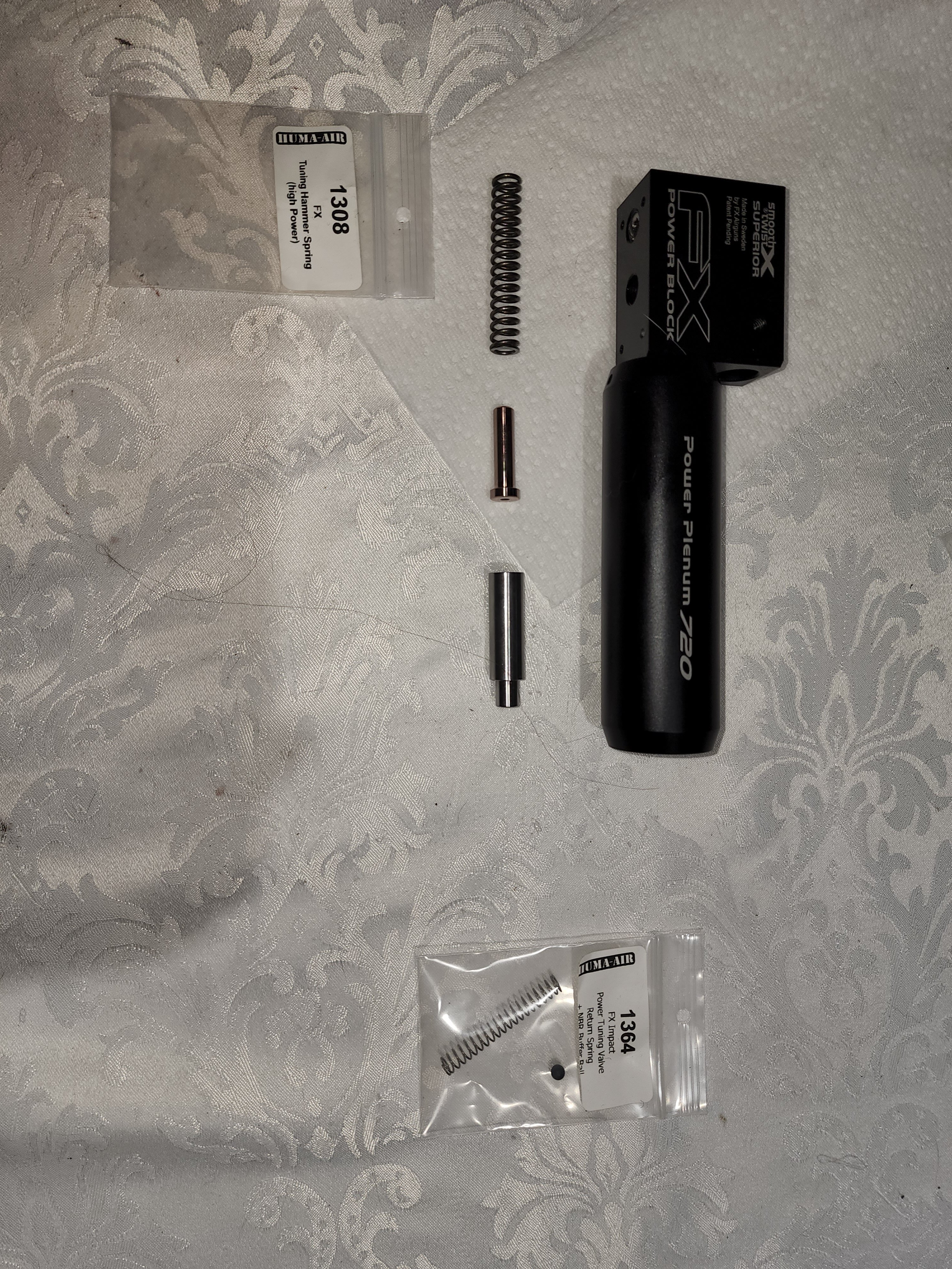

Installed now are:

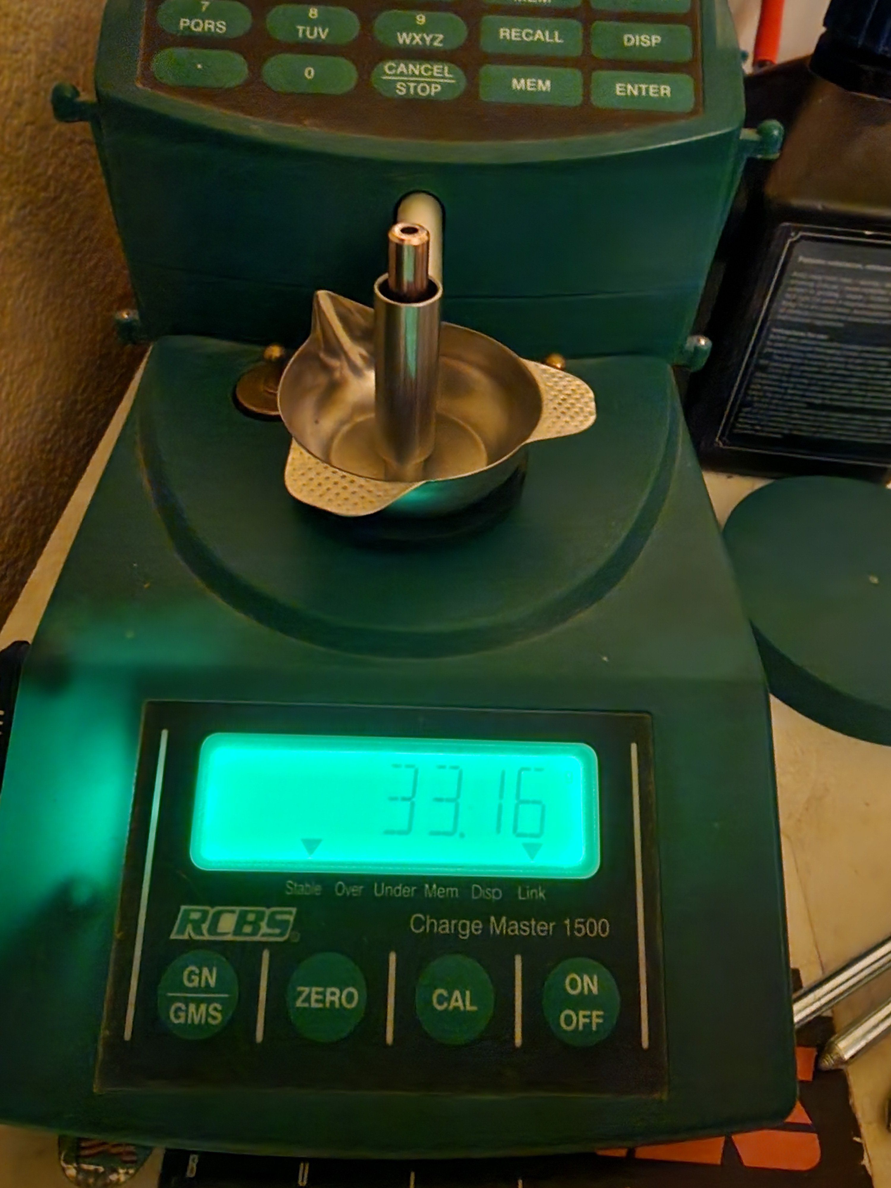

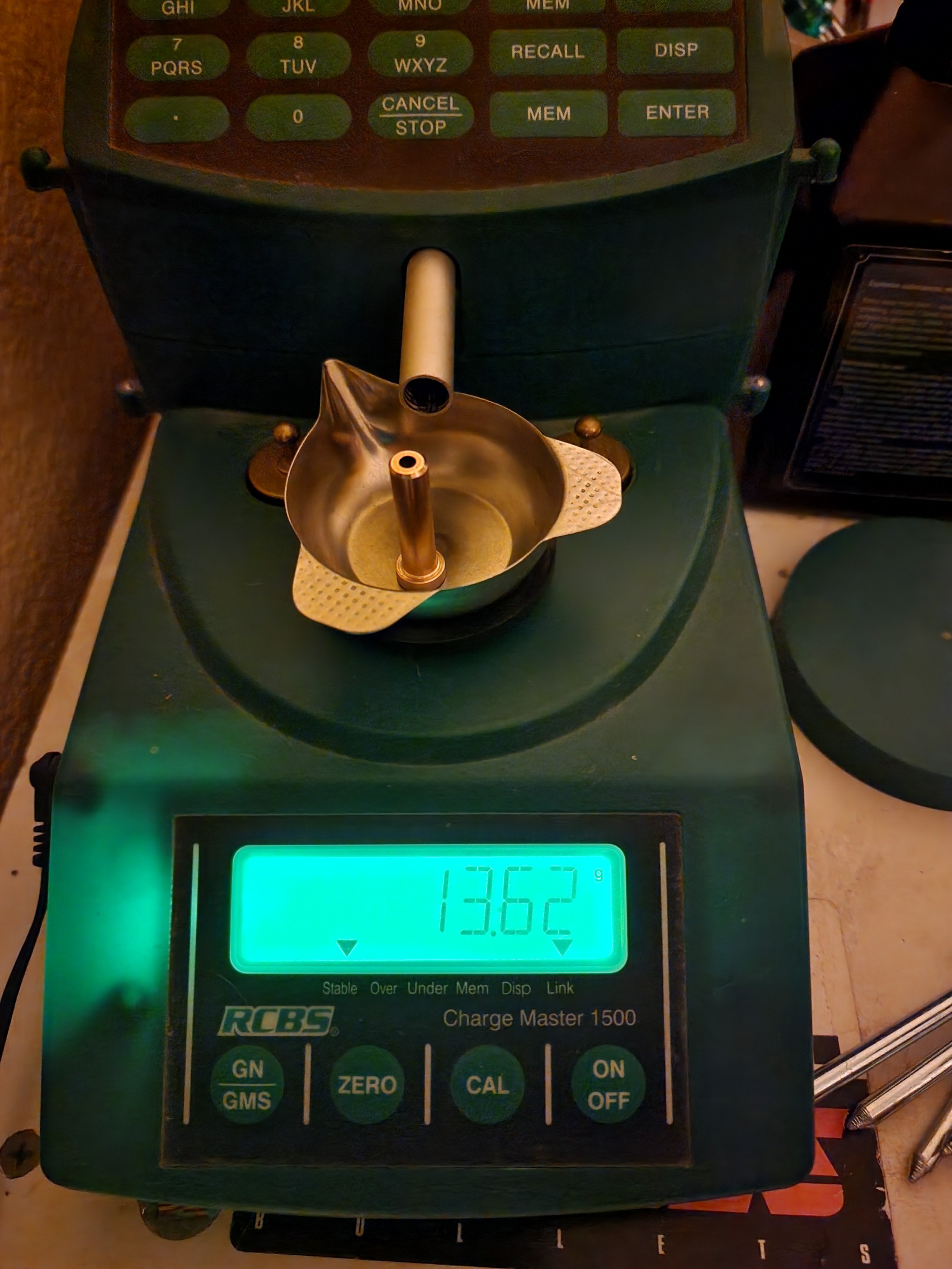

-13.6 gram tungsten hammer. Head measure 3mm and is 30mm long. Total assembly weight is now around 33 grams.
-Huma power spring kit. The hammer spring is 56mm vs 52mm from FX.
-Power block

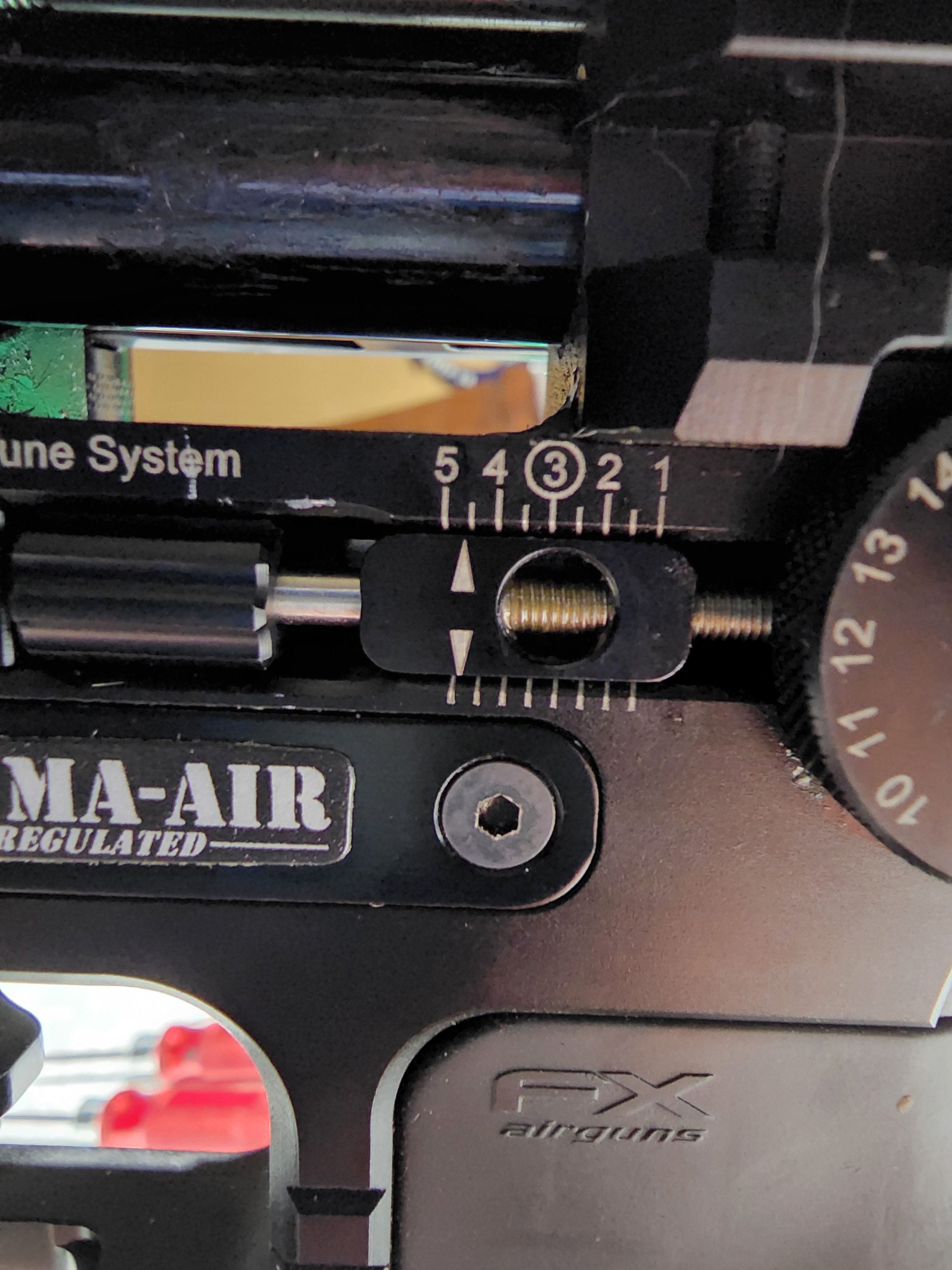

The new tungsten hammer allows me to adjust the micro dial to approx. 4.6 before it maxes. To get full rotation to the number 5 (I know I am picky) I either need a hammer that measures 1.85mm at the head and 30mm long or 28mm long and with a 3mm head. I am unsure if the spring is fully compressed or if the 30mm hammer bottoms out first. Future project I guess.

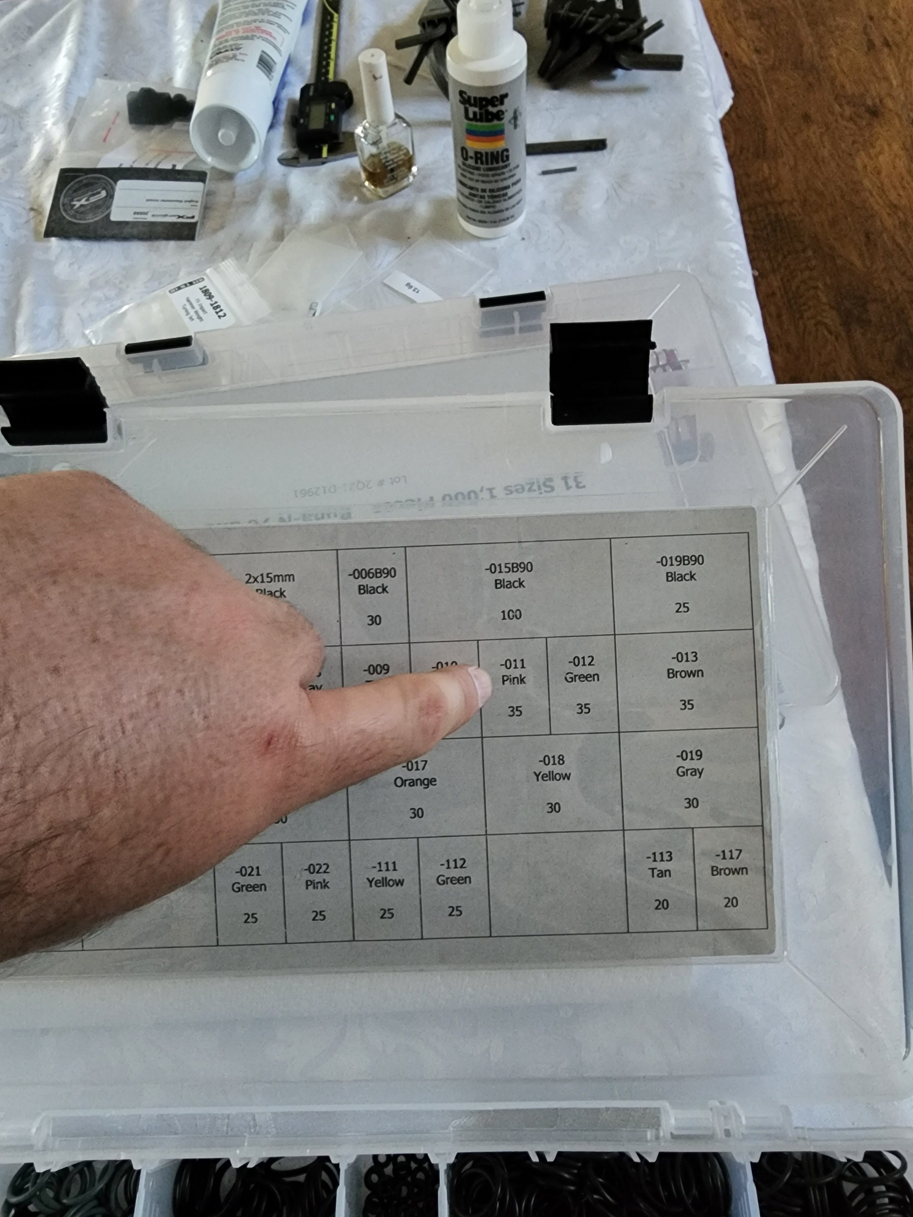

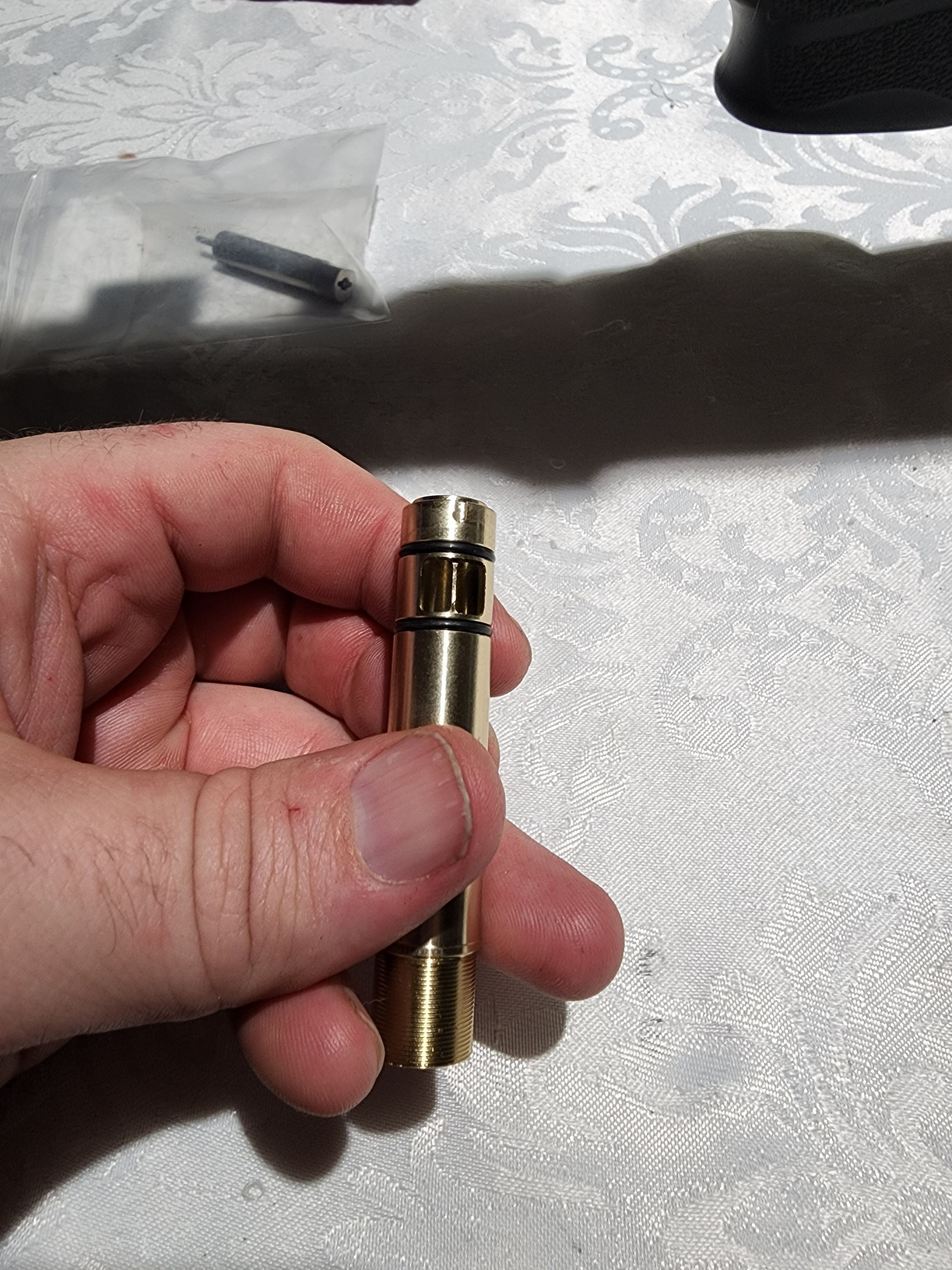

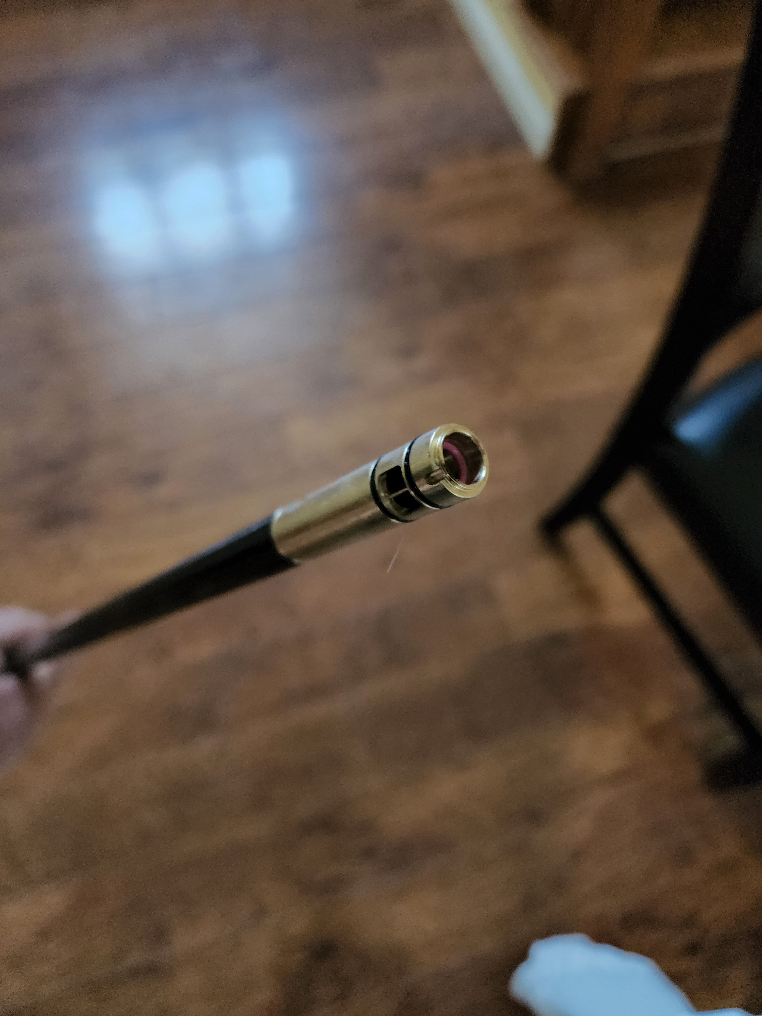

If you notice the pink o-ring inside, it is slightly smaller and thicker than the original. The NSA slug probe works well with it and I find it may have a better seal. As I close the slug probe you can feel a slight resistance before it pushes through. I was using the same o-ring on the prior transfer port, so I know it works. I'm not sure the exact size because it is part of an airsoft kit I bought at the o-ring store.

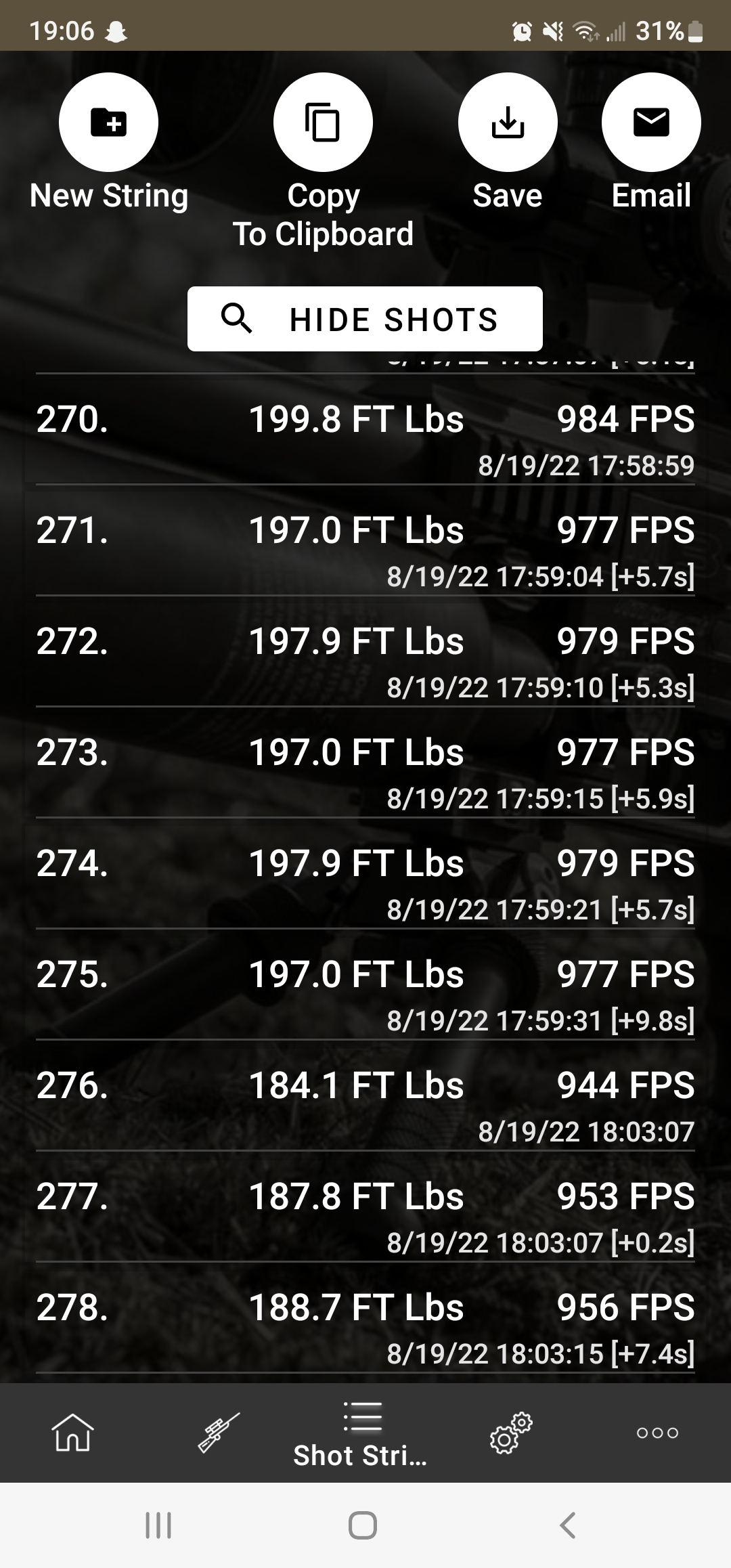

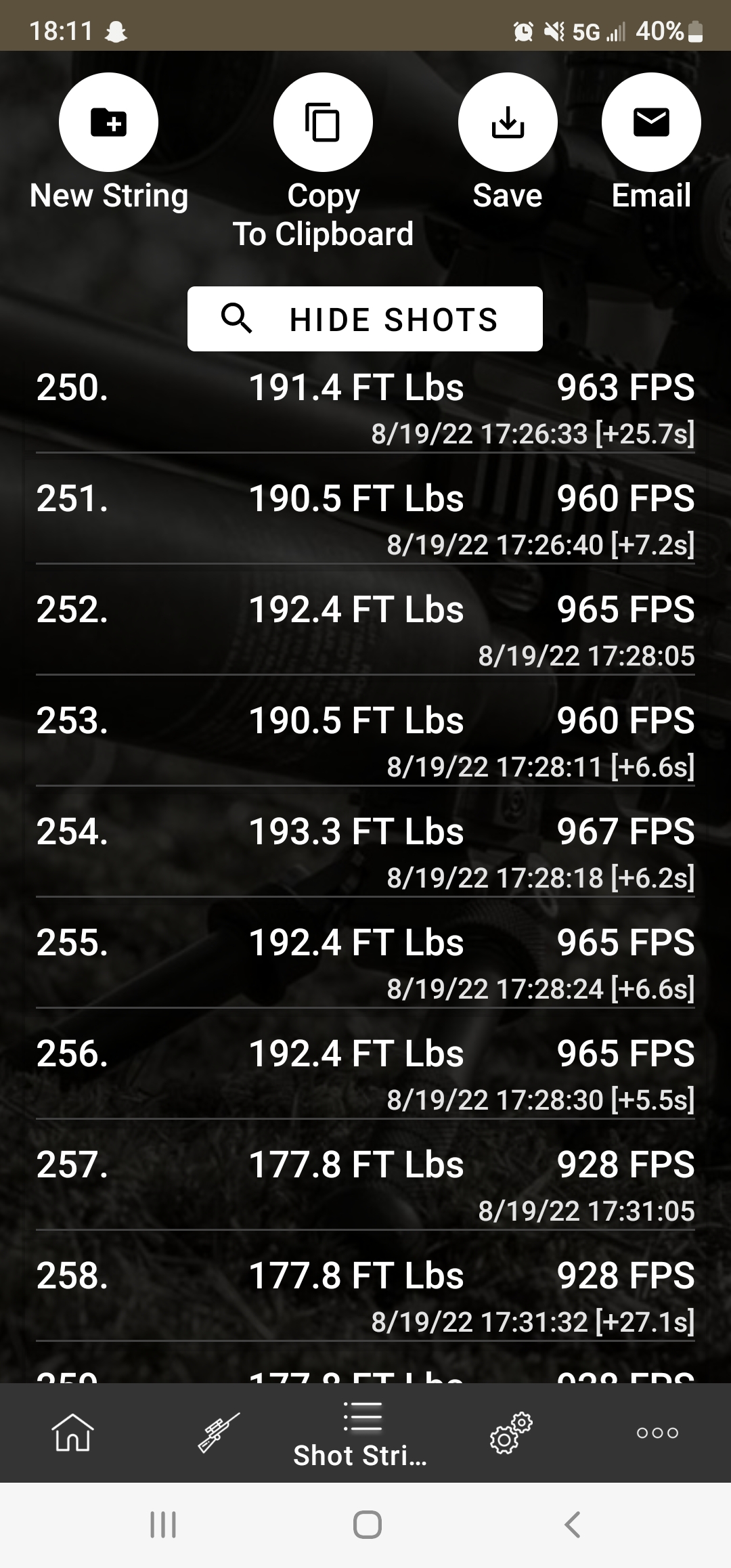

I also attach my SCBA tank and dry fired a couple shots. 9 bar a shot drop. She must be breathing good now. I am really curious about the speeds I will see. Plan on launching some lead tomorrow.
I was very impressed with the power level's after all the mods I have done, as 193fpe is no joke. Now I just need a tensioned slug barrel. Hurry up FX.

-huma dual tranfer port with one size tighter oring installed inside

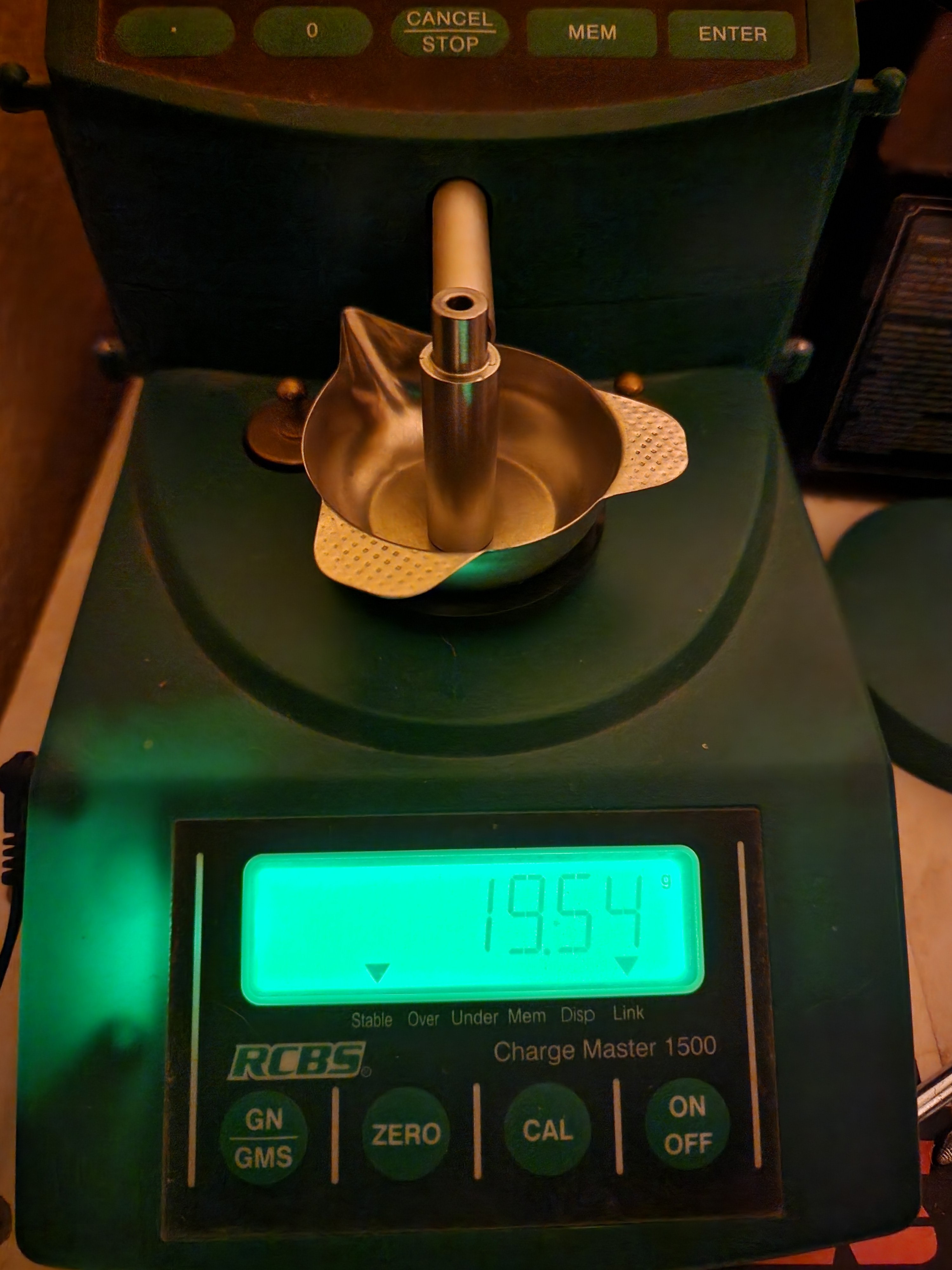

-19.5 gram hammer
