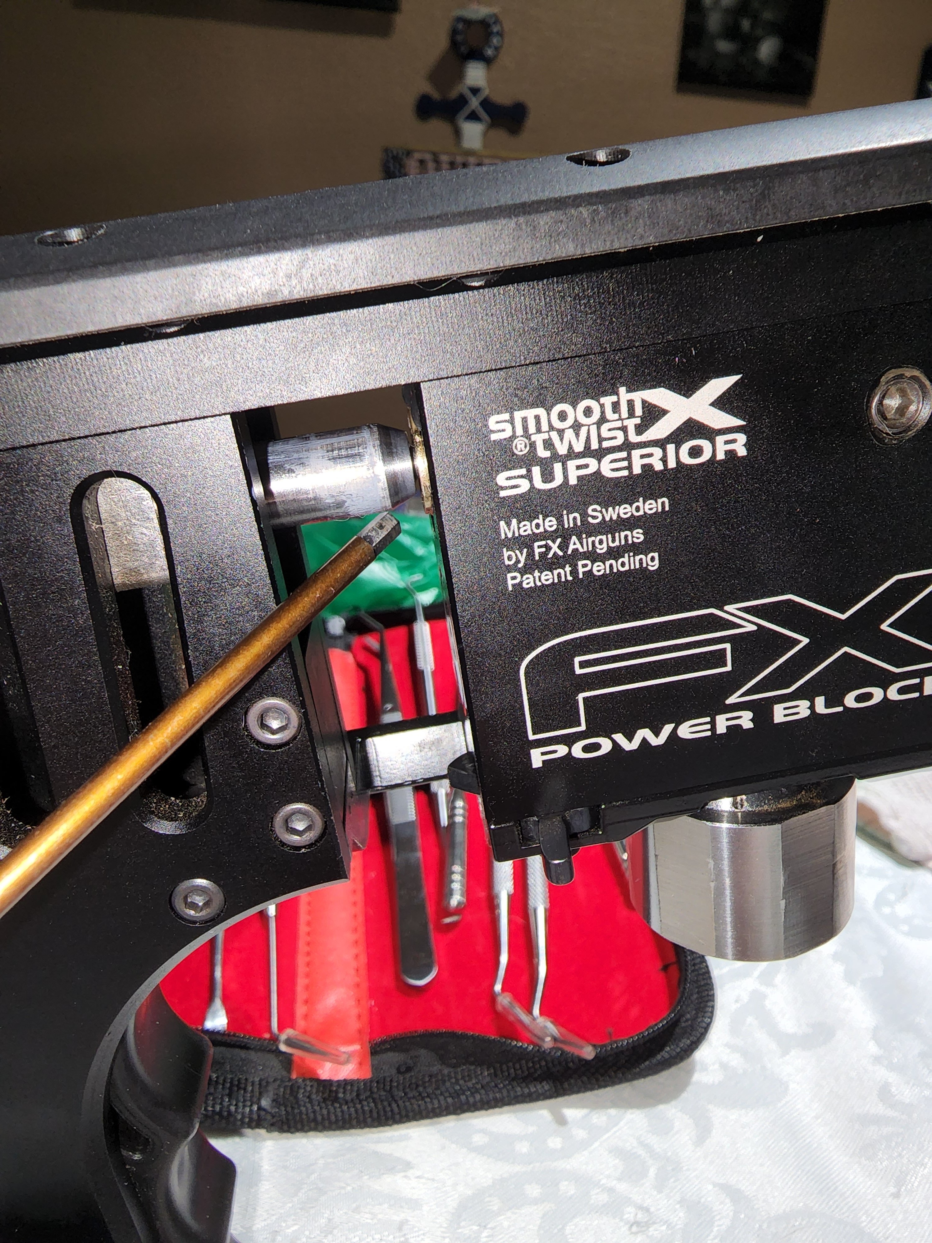

Yeah, another reason why I like the nsa slug probe. It has a heavy hex bolt behind the probe.
But it's all hanging on that little weak rod. The probe, the block and the heavy hex bolt behind it will exit to the rear once the rod fails. Take a good look at that rod and it's attachment. At that power level it's not a matter of if but when. A chain is only as strong as it's weakest link.
Admittedly, if the connection points could be welded or one solid piece, it would be a stronger, better design.
The sealing point, as in the oring only contacts the very front of the nsa probe slightly too. You can see my grease line here.
I wonder what the actual sheer strength the 3mm rod is, since the force is linear. I also wonder what it is made out of...titanium, steel, aluminum etc....
We are also not dealing with firearm pressures, considerably lower. 60k psi vs less than 3k psi after the regulators. 180 bar is 2600 psi roughly. You also need to account for the loss of pressure, or more appropriately, the division of pressure, as it is easier for the pressure to force the round out than in reverse and force the probe out.
Most probably aren't aware of this, but with a semi-auto handgun, you can physically hold the slide closed to keep it in battery and fire one round. The small amount of back pressure used to normally cycle the action won't hurt you and you will barely notice it because it is easier for the pressure to exit the path of the bullet than the action. However, you will have to cycle the slide to shoot again.
I am not saying the design can not be better. We all know it can. I just think there is a little too much worry there. Just my opinion, and we all know what opinion are like...lol
I do partially agree though and I hope FX starts to address some of our concerns.

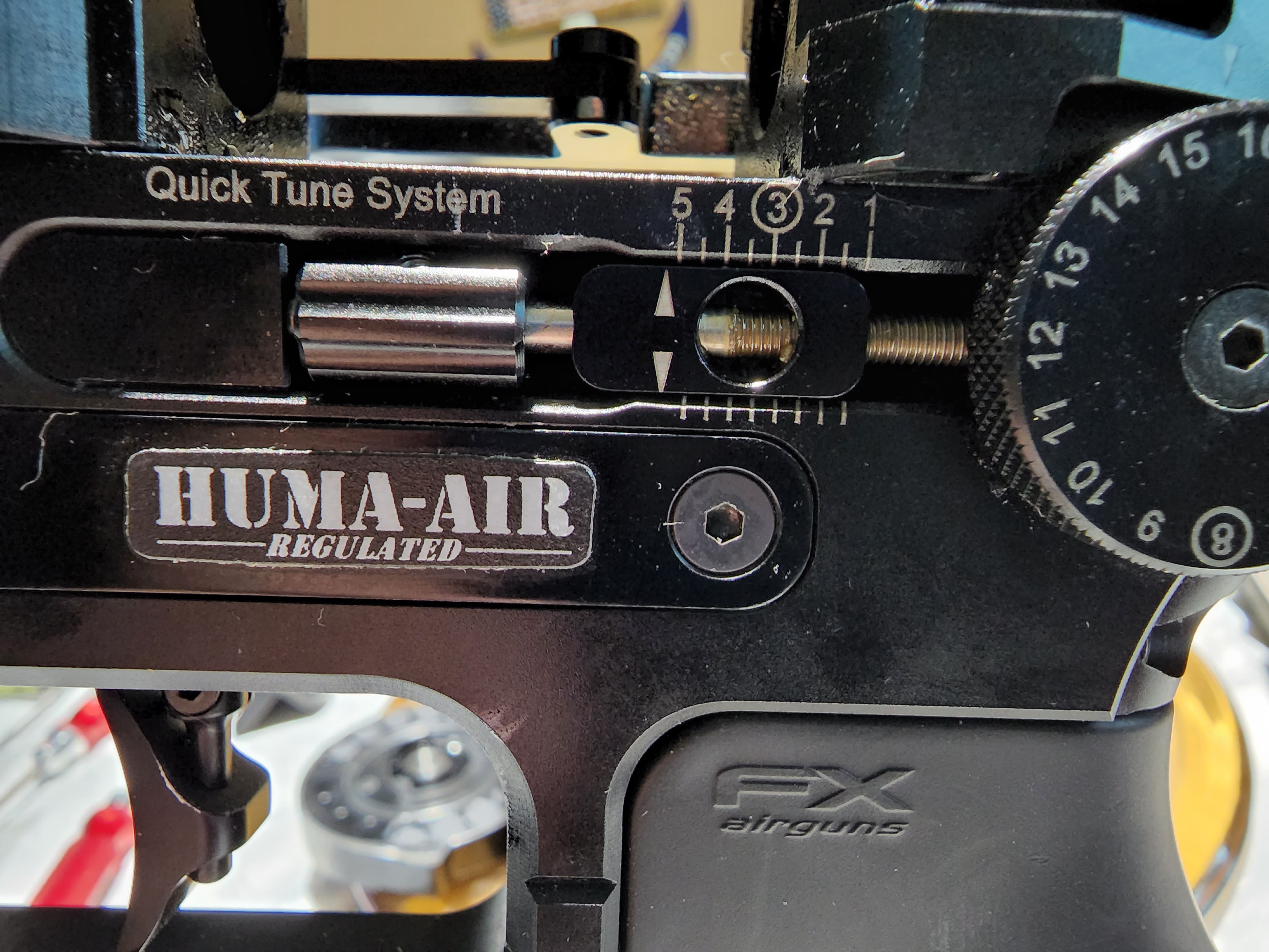

Well this morning, I went ahead and put new o-rings in the first reg and restacked the bellville washers. I then set it at around 190 bar and reset my huma reg to about 165 bar. I'll need to mess with the macro dial to see where accuracy and speed start to like eachother. From what I have read, some where between my old 860's and 890 fps is a common sweet spot.

Update.
It appears with the huma power spring the hammer weight needs to be no more than 28mm long to allow for full compression of the spring. A 3.5mm head will land you on the number 5 of the microdial. Below is a picture with a 3mm head x 28mm length. Total assembly weight is 32.2 grams or about a gram less than before, but with more adjustment of the gun.
Good to know. I was ironically trying to take my shroud and liner apart today too. However, the dang thing seems to have permanently attach itself to the liner. I need a vice to get it apart, so for now I left it be. I am curious if the bc shroud/barrel tensioner sleeve will fit over a 12 x 14mm carbon tube. If so, I will replace the factory metal liner with that and tap epoxy the transfer port in it and tap the opposing end for the shroud attachment.
He also makes custom tungsten hammer weights that he sells on ebay, so no need to wait for fx on something so simple to get. A 3.5mm head by 28mm length will yield adjustability number 5 on the micro dial when used with huma's 56 mm spring. A 3mm head x 28mm length will provide about 5.25 adjustability on the micro dial.
