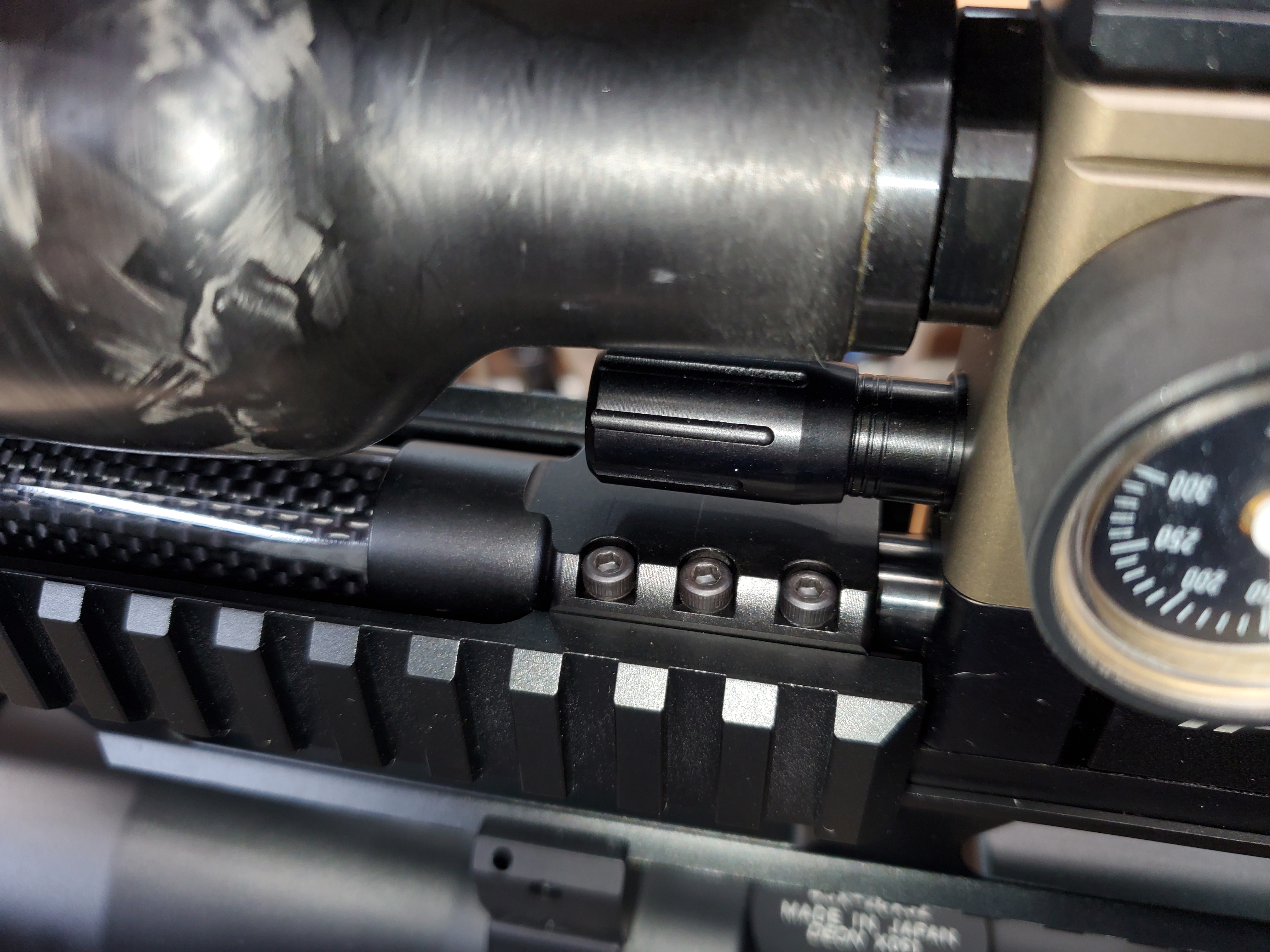

Here is what the Huma barrel stiffner looks like. When you tighten down all 6 bolts the carbon fiber tube can't be moved and it holds the barrel tightly also.
Reactions: 7Green
