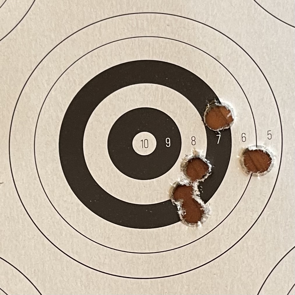

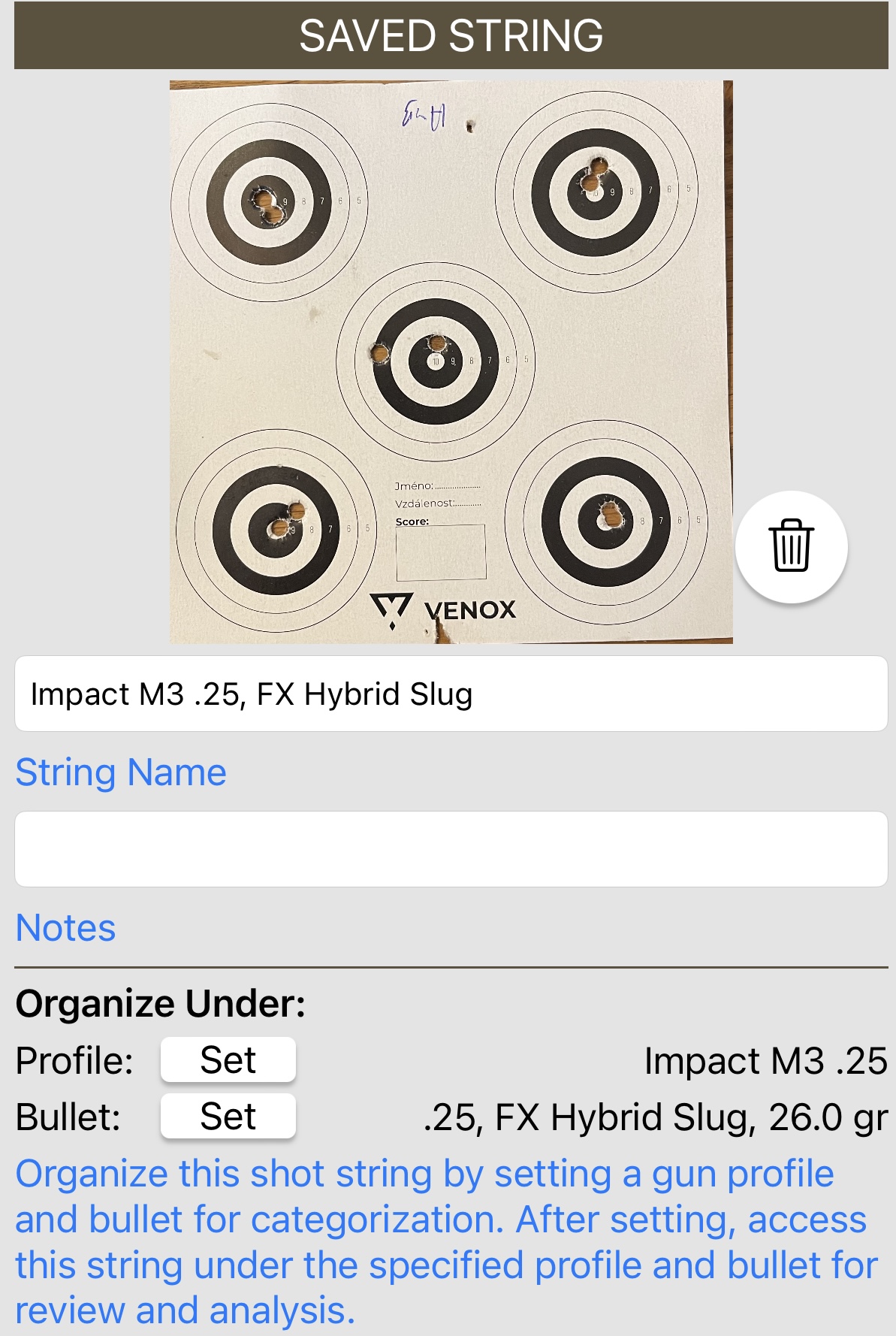

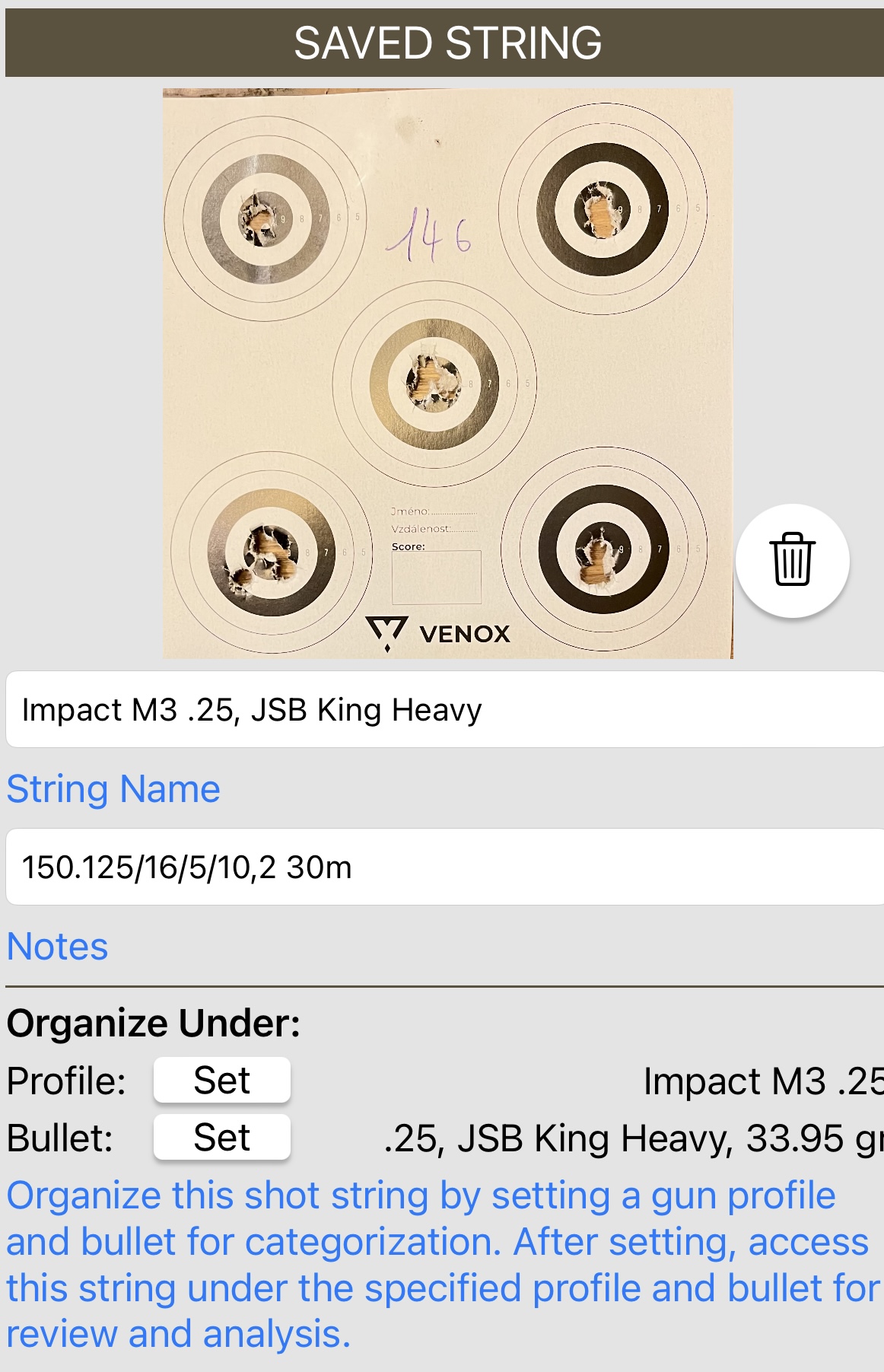

Hi , I’ve a question, how to get better
Results with the spreads ? Here are my chronographs results :
Your standard deviation is not bad. As Vetmx said, closing your SD is not necessarily going to shrink your groups. All of your groups except the bottom left look pretty good. The flyer on the bottom left could be from any number of factors like a punched trigger pull, loss of focus at the shot, damaged pellet skirt, errant breeze etc..
I seriously doubt it was caused by deviation in velocity.
Reactions: coastal drifter
I tried to lower the speed but it’s still disappointing…
