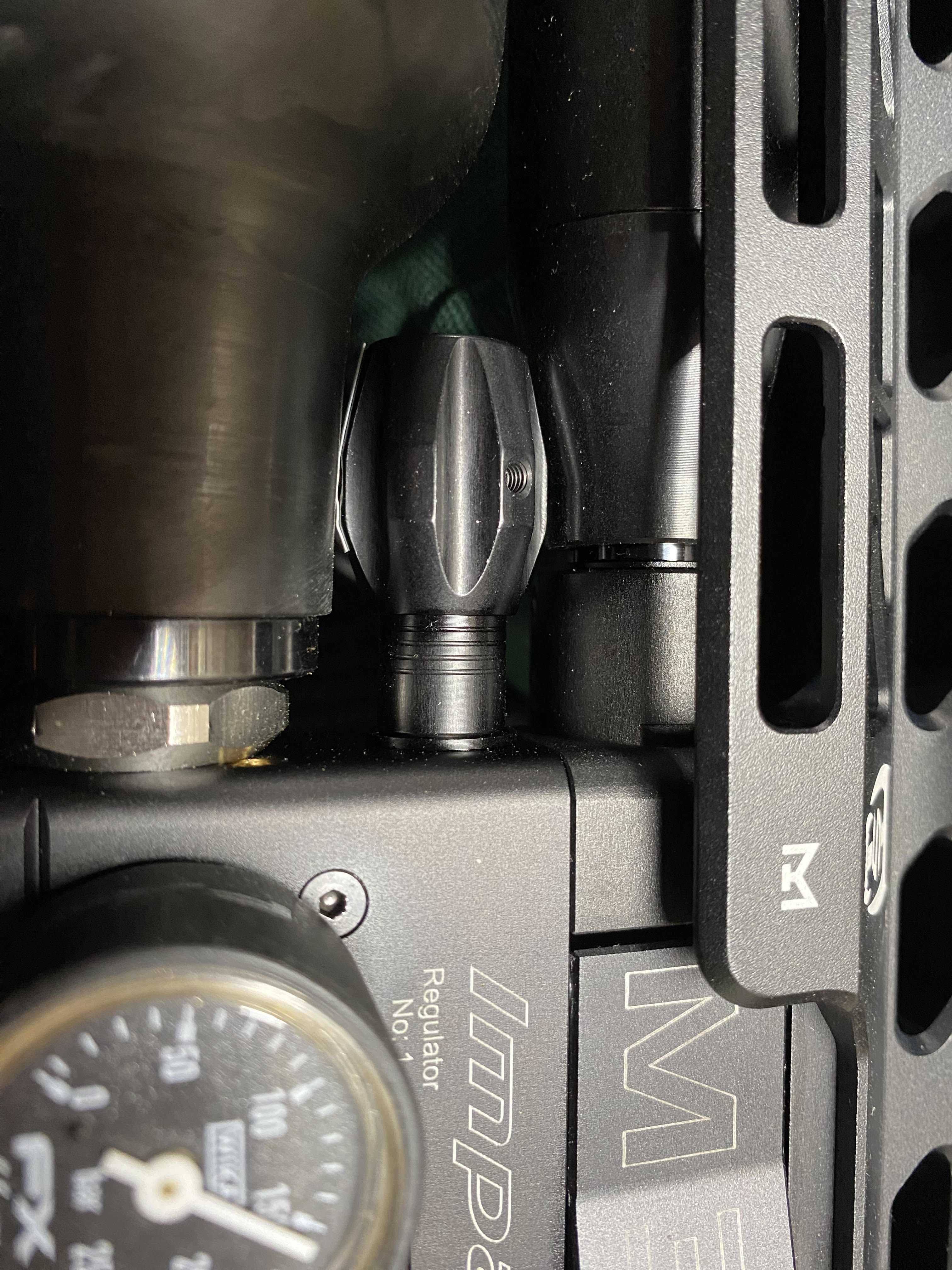

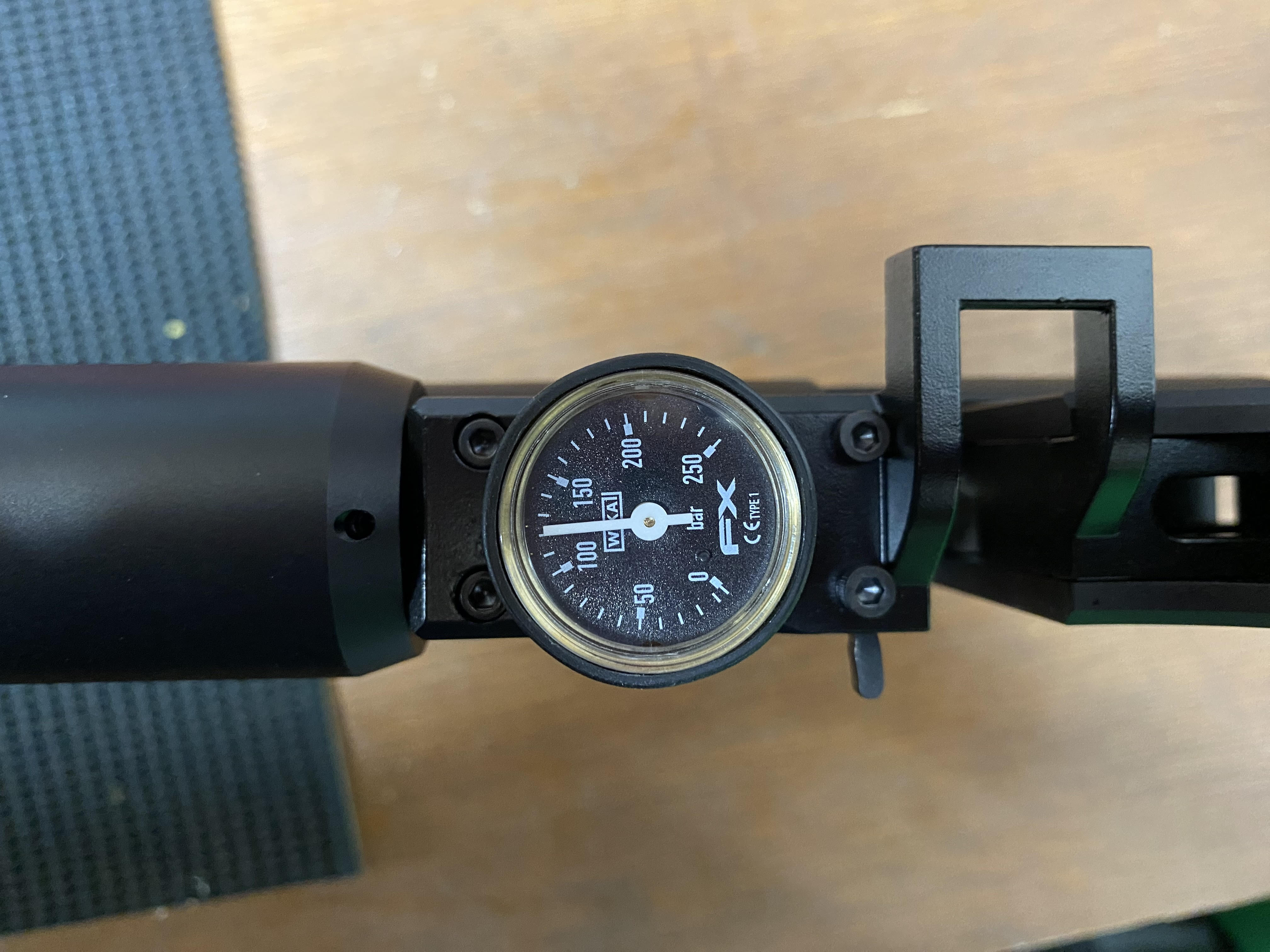

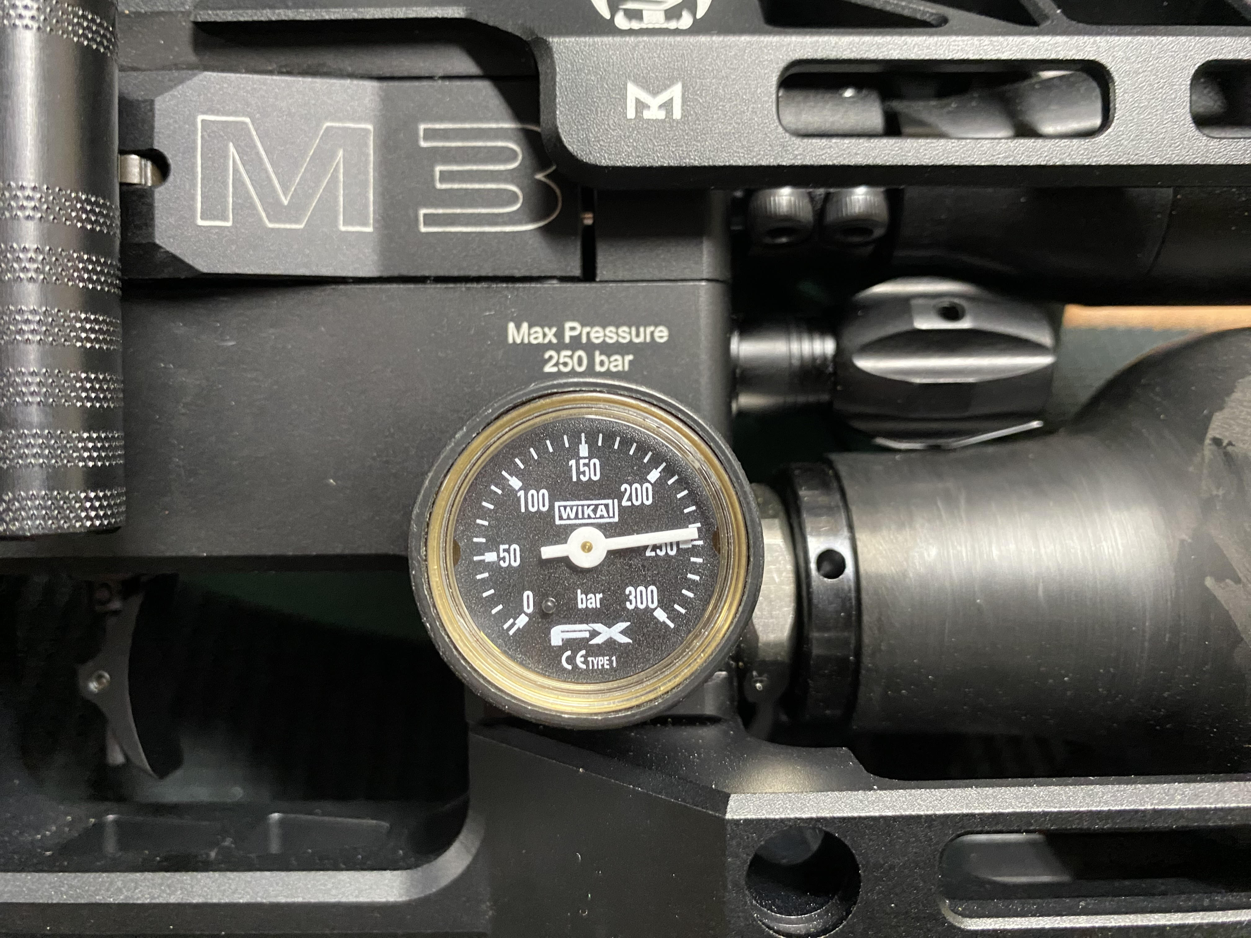

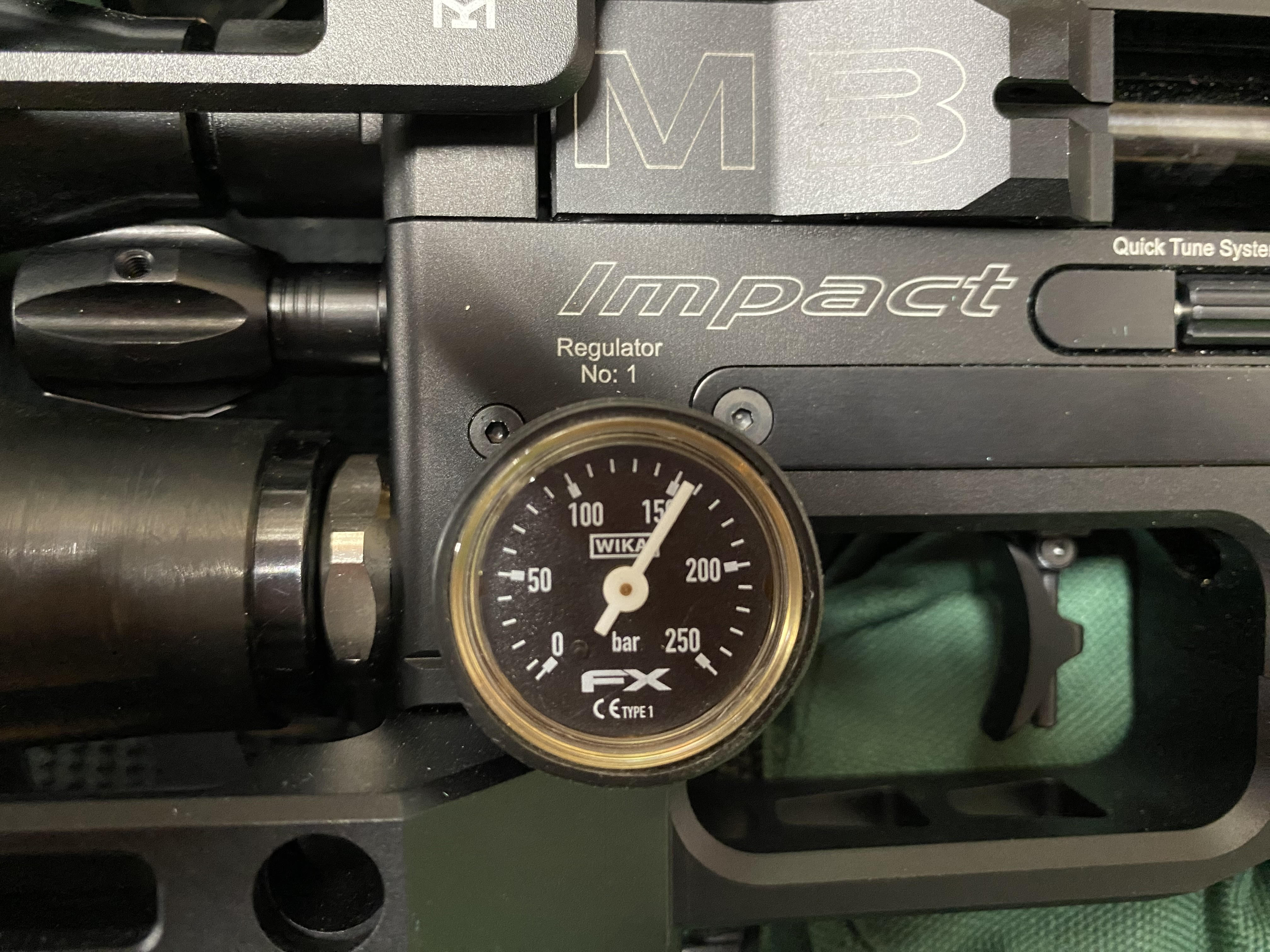

Also, besides changing out the barrels is there anything else I should know NOT to do with my FX Impact M3 as not to damage it. Such as if I adjusted the 1st regulator pressure (because right now t=my garage is at 71 degrees and the 1st regulator has gone up to the point that the left side of the needle is touching 160 and the needle is kinda more toward 170, i feel like this could be a bit too high, but at this temp if I let my gun set over night it goes that high, during normal shooting conditions outside (since it is colder right now) I feel it stays more in the 150 range or lower. But if I need toa adjust the 1st regulator, do I dry fire the gun after taking the tank off to expel the air out of the second regulator before adjusting the first regulator or not? Is that a no no or is it the proper way? Also, It is better to try and keep the 1st and second regulators within 30 bar of each other or is it bad to do that? I heard you want to keep them that way, but maybe I mis understood, because of the default tunes in the manual I do not understand the 30 bar between regulators thing. Also, what is the max fill of the tank/ air gun itself? I have the big tank and my air gun regulator goes to 300 bar, but I have only been filling it to 250bar. And are there any things that you should avoid at all cost, such as certain regulator pressures or certain pressures on certain regulators to watch out for and never fire your gun at. Because I have seen " Never fire your FX IMPACT M3 below regulator pressure" but I do not understand what that means. I assumed it meant never fire below 150bar on the tank/airgun regulator, but I was not for certain.

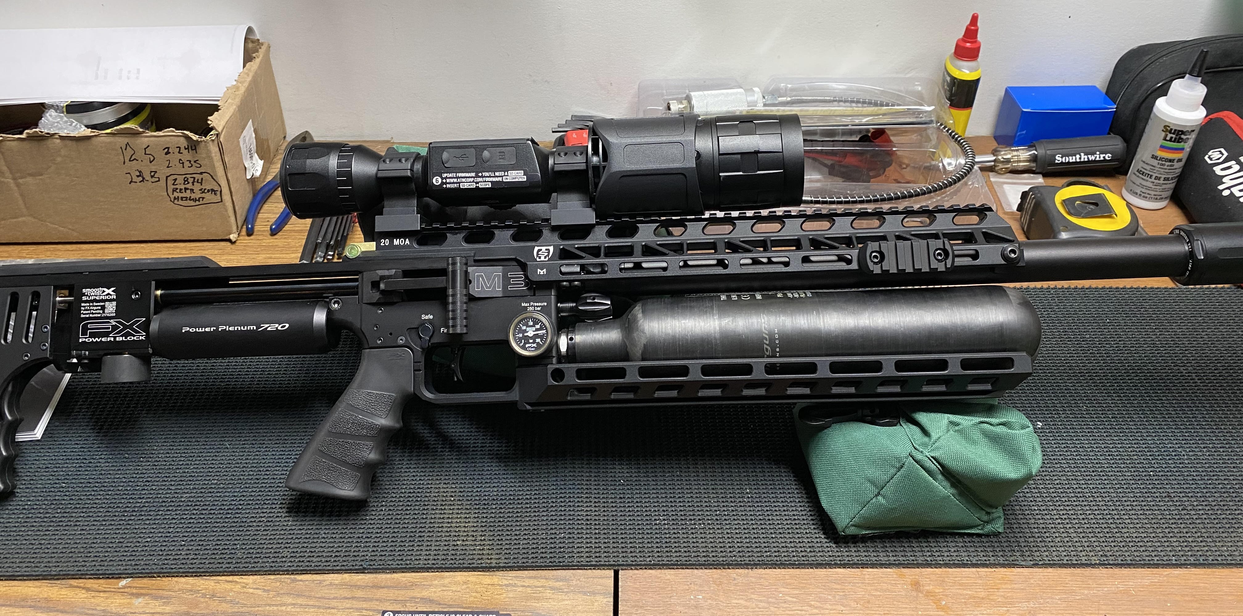

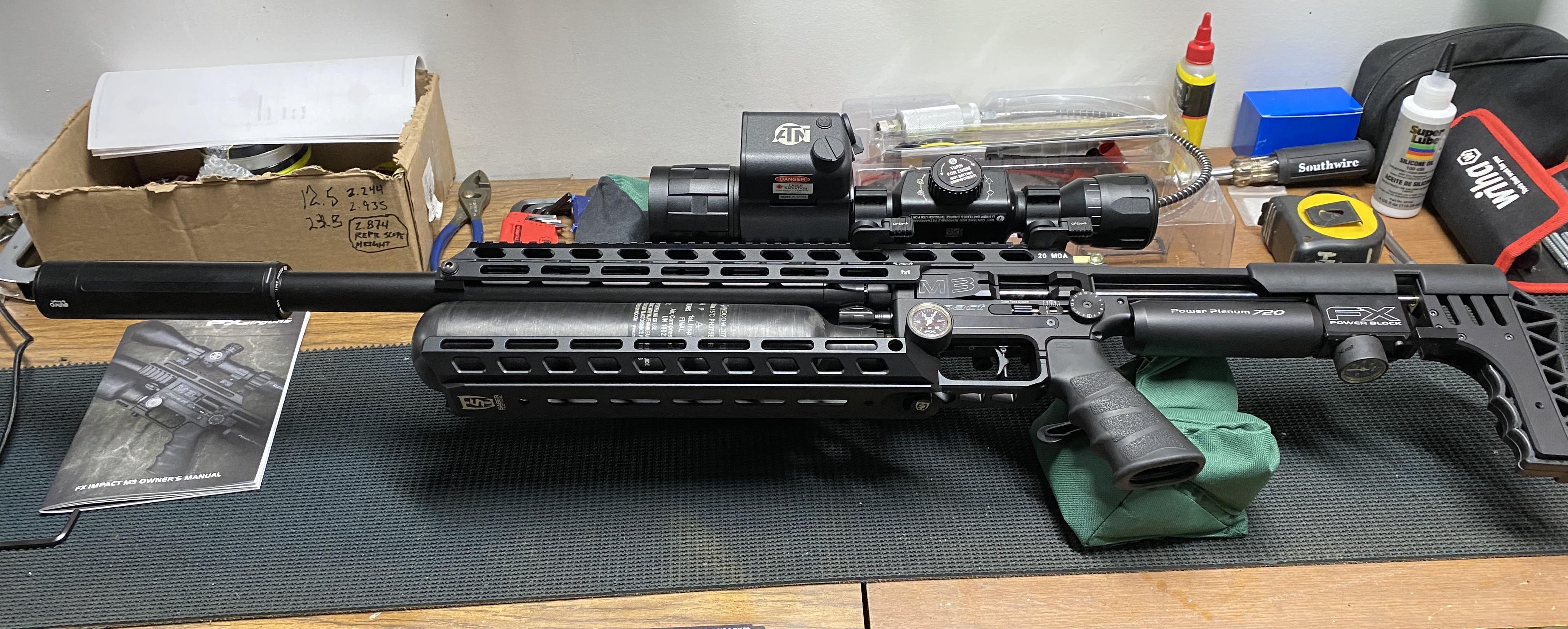

I will try to attach files of my current .22cal 25grain JSB redesign tune and my gun setup for all that are interested.
