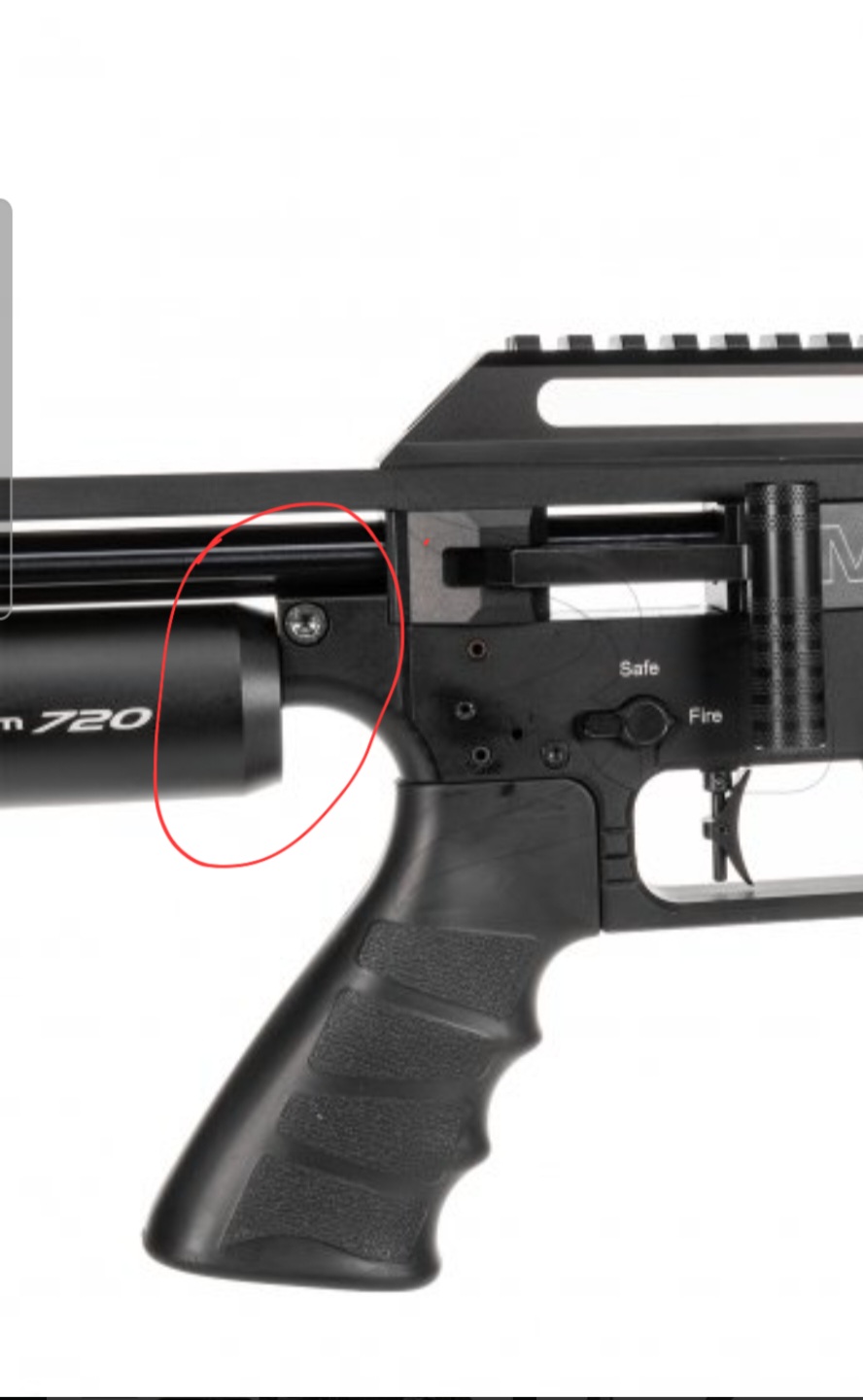

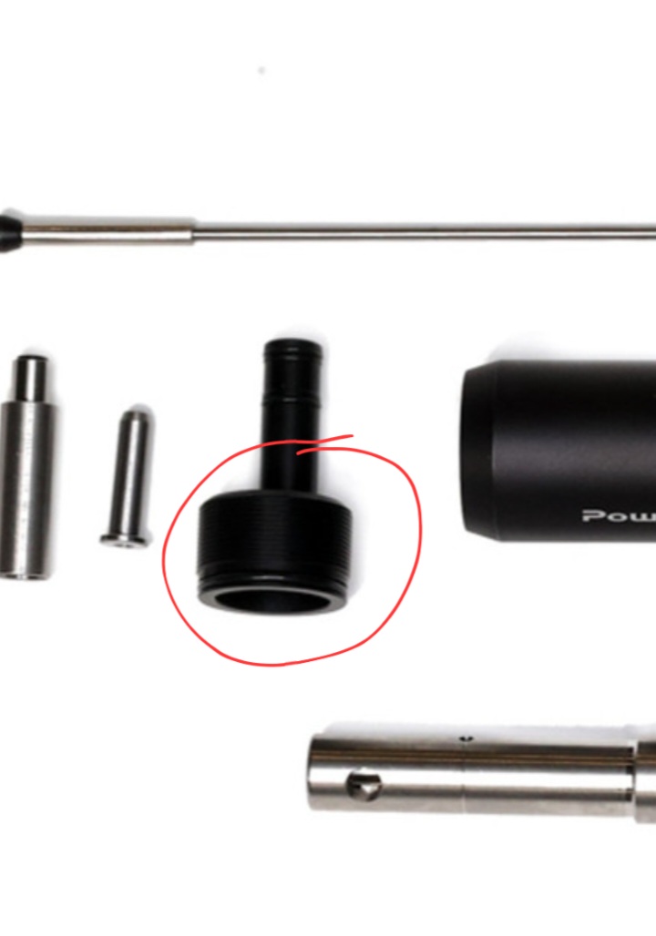

I won't claim to have figured it out either but I've always been a little suspicious of the power plenum.
I've always noticed a little bit of play in the threads where the "stem" screws into the plenum. In my mind, this play would transfer into the upper rail/spine of the Impact directly above it and possibly cause some flex.
I've never seen it mentioned before and I'm curious of what you guys think about it.

From memory, the barrel passes through the front block ( which is where the scope is mounted) and is only held concentric with a couple of o rings, then is attached to the rear butt block by a thumbscrew. The only connection between the front and rear blocks are the top rail made from a flat section of aluminium (approximately 25mm x 5mm) which adds little to torsional stiffness. Then there is the plenum, however only one end has a firm connection to the block, the other end is a push fit with an o ring for the seal and a grubscrew to hold it in place.
By holding the front pistol grip and the rear butt grip it is not difficult to twist and flex the gun, only a guess but I would say that’s probably not a good thing for consistent poi placement.

I have fixed the regulator creep issues with better regulator pistons. Also fixed the issue of 1st slow fps shot by making a modified front part of the plenum. In OEM plenum, there is the issue of O ring extrusion that the revised design successfully fixed.
I have made the top rail of around 20mm thickness instead of OEM that is around 5 or 6mm.

Yes as the thicker top rail eliminated the flex, it helps in fixing the wandering POI.
