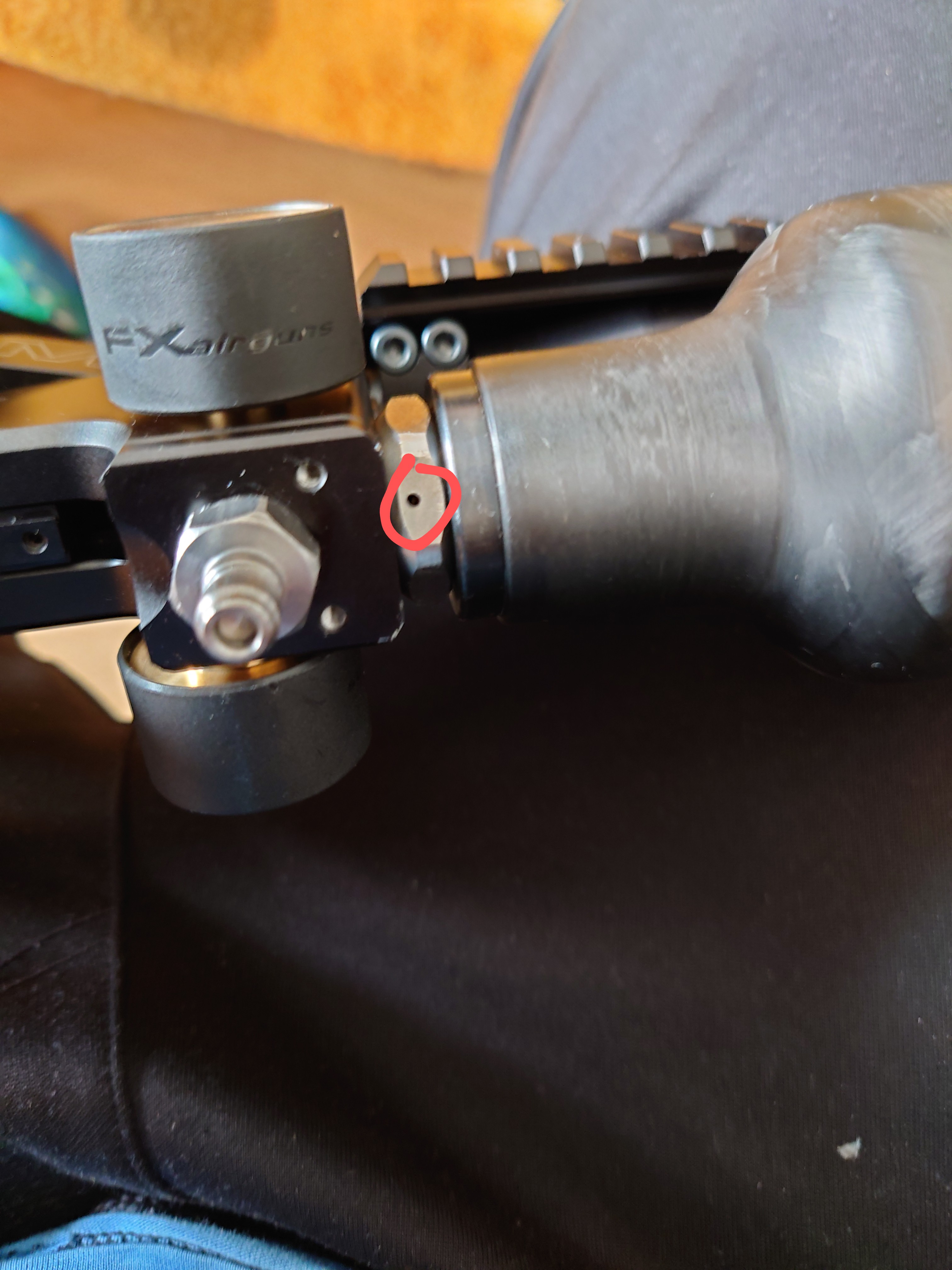

Now, I have a bit of a problem. I just received my new FX Impact M3 Sniper, and when I tried to pump air into it for the first time, it won't gain pressure, and there is air leaking from the small hole in the bottle adapter.
Anyone has experienced this problem, and if so, is there a way to fix it?
1.5mm thick x 4mm buna 70 if I recall. It doesn't hurt to have both buna 90 and 70 available just in case. It isn't a hard change. Start one side of the oring. The other end that protrudes into the cavity, lightly push against with something like an allen head. From the opposing side I use a flat blade screw driver to slowly turn the oring while keeping the pressure from the opposing side. It will slowly works its way into the groove.
When you push with the allen head right, you will see a small crease like your *** crack develop. That is what I use the small flat blade between. Probably an 1/8 to 3/16" flat blade head size.

Fixing my leak there right now but I can’t find my 23mm wrench. It’s caused by a oring way inside the reg.
Got my 23mm deep impact socket at Lowe’s home improvement. Harbour Freight has a whole set for under $30. I bought that also, check out their website.
Good luck, been trying to get my first regulator aka Bottle Adapter fixed for weeks. Changed every o’ring multiple times. I am a hair from ordering a Huma regulator replacement for the 1st regulator.
For the 1st time removing the 1st regulator from the action, please note that the regulator threads also have thread locker applied from the factory. So if one can hold the action in a voice, it becomes easy and there becomes no chance of making any scratches on the action.
After 1st time removing the regulator, then you don't need to apply thread lock on the regulator threads.
