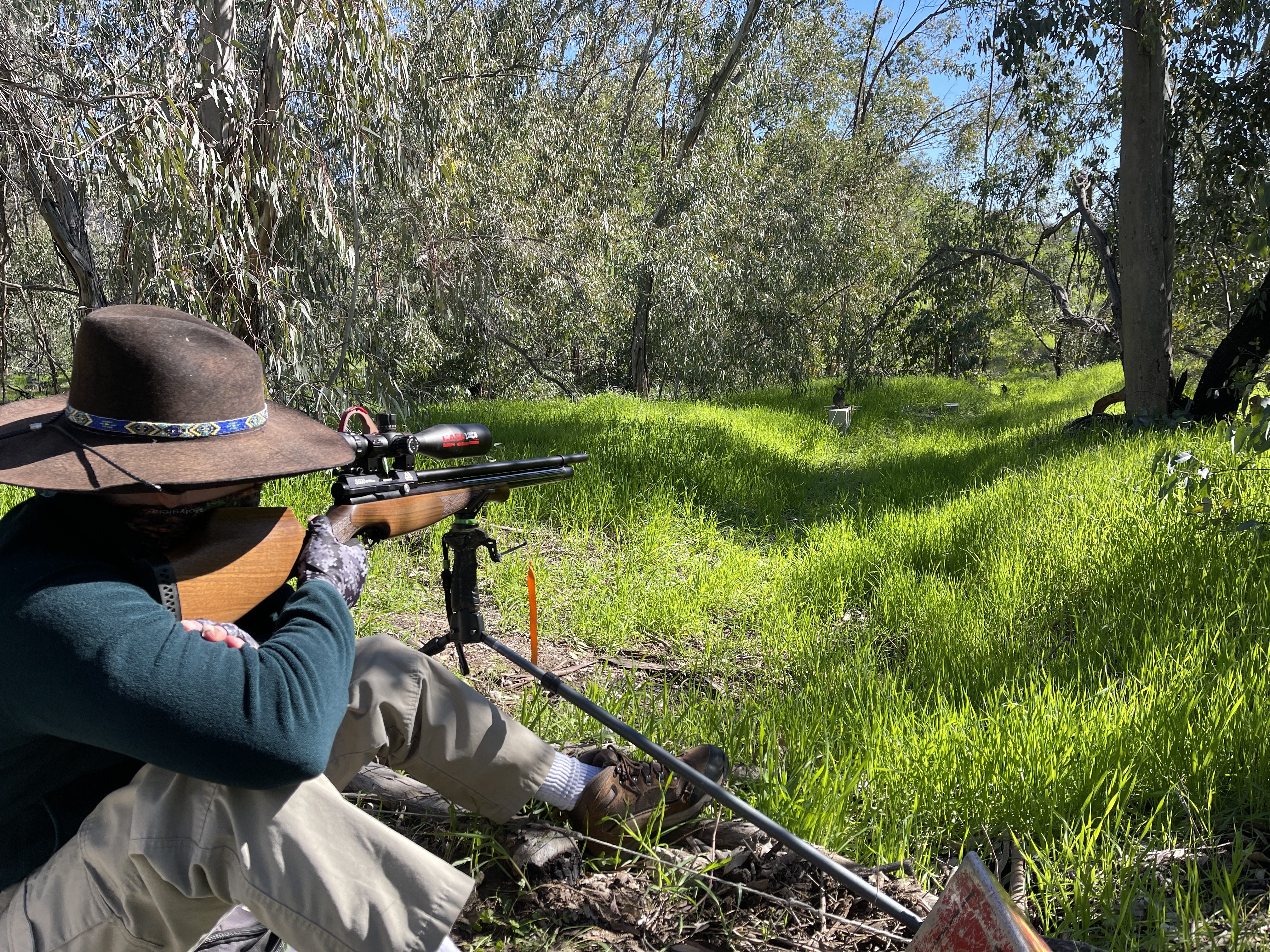

This is a lane from today's CASA match, buddy shooting AirArms.
FT is a lot of fun with varied targets, disciplines and personalities.
Keep it fun, shoot what feels good and be willing to explore different equipment and categories. The "Buy once, cry once" adage can make you very narrow, "explore more, learn more " can provide more entertainment and tolerance.
Trying to increase your score can become an arms race very quickly, which can also be fun, but certainly not everything FT has to offer.
