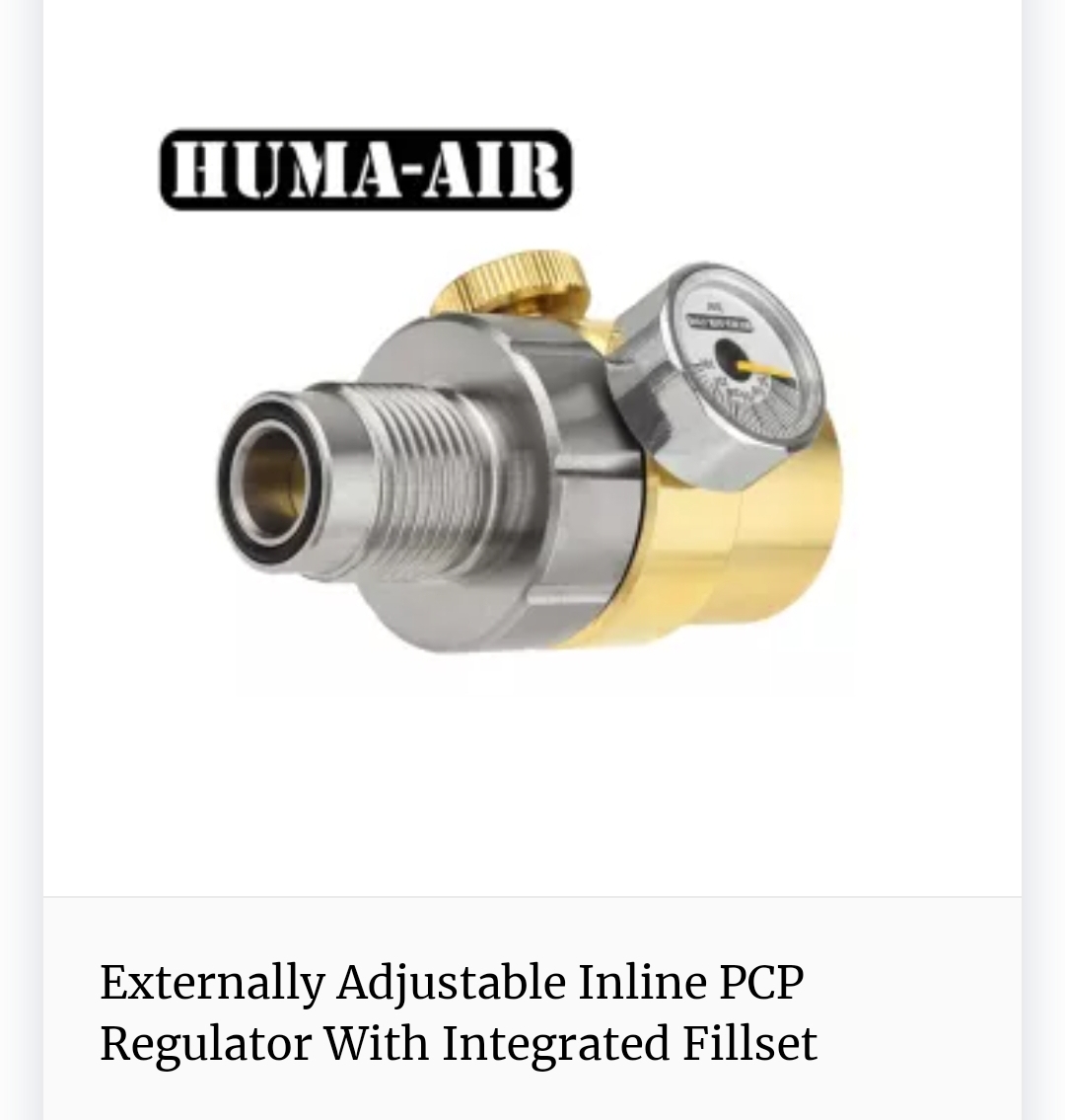

What I have done is attached an externally Adjustable inline regulator with my scuba which gives me a regulated air.
Then I shud not be worried I hope. What do u say?
