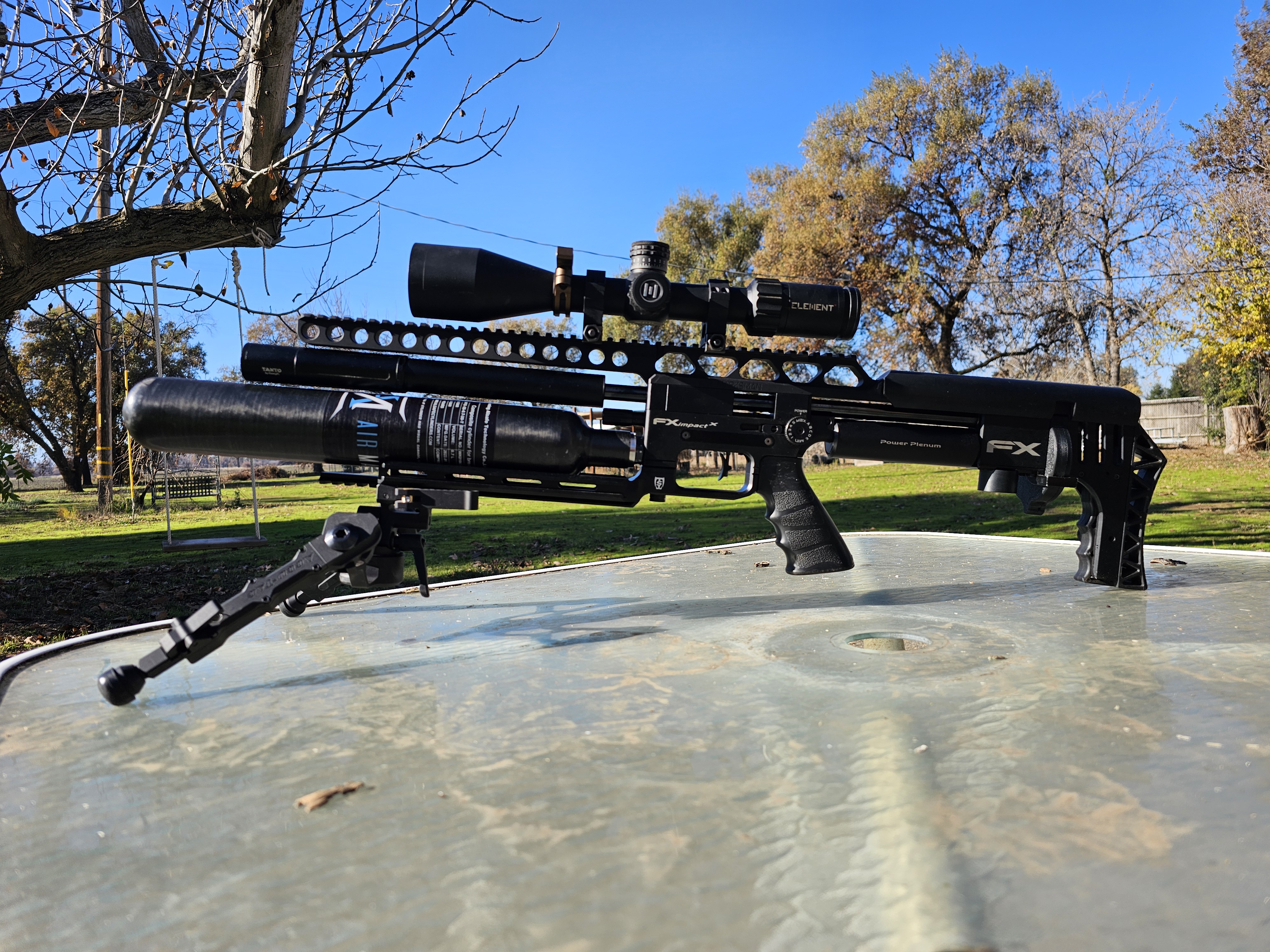

Hello,have M4 COMPACT .25 thinking to put only silencer without that shroud on it,anyone of you guys tried silencer only direct to barrel knut thread,thinking of KOI or Decimeater Hogan as possible more silent option,how does only silencer option of KOI compare by DB sound to lets say shroud with tatsu combo on it,more quiter,same,louder,would realy appreciate if you tested it,thanks.
