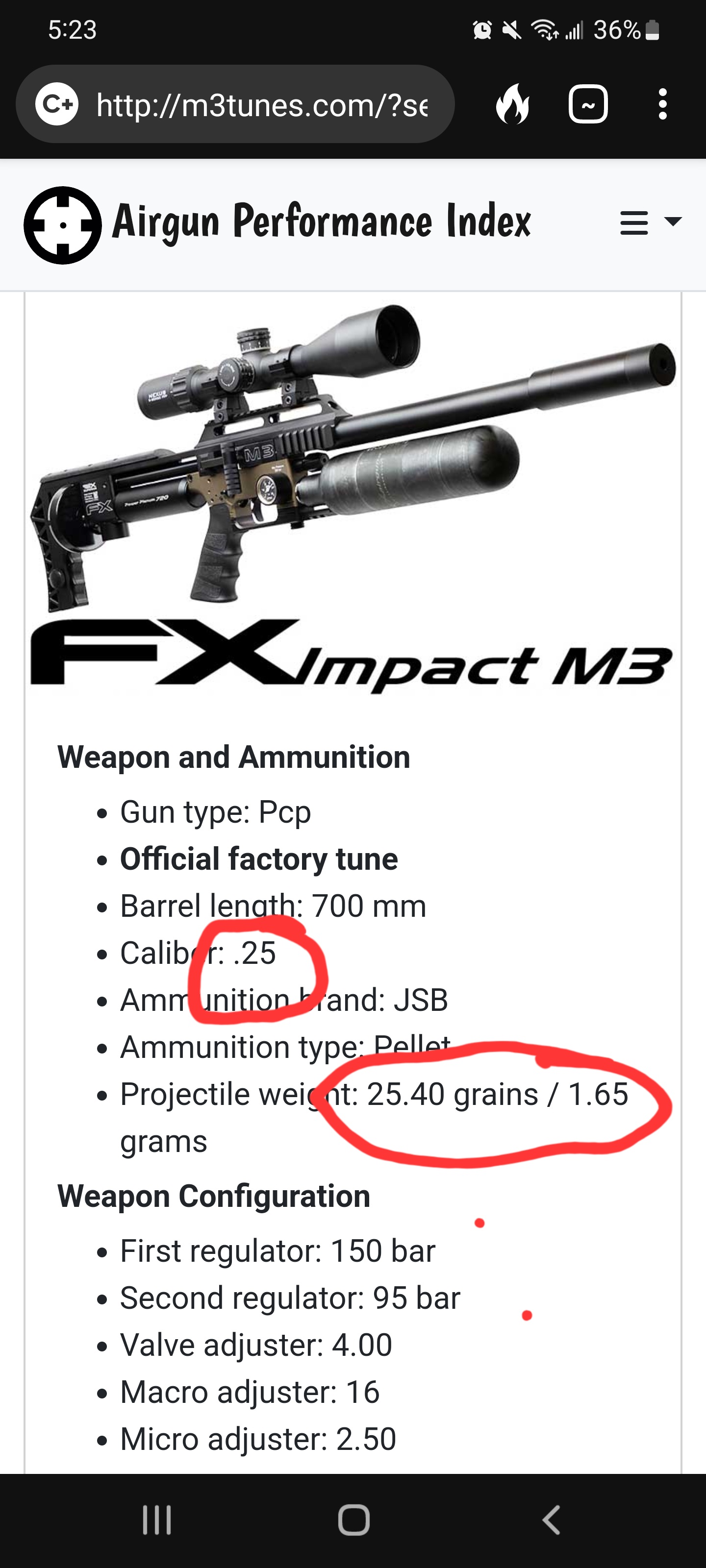

thank you , but the site have not my pellets style
The first one is literally your pellets style.

thank you ,my barrel length : 500 mm

If you're looking for tunes you can use the 600 or 700 as a baseline and add some reg pressure for the shorter barrel and go from there.
Like if they say 95 bar on the reg try 105 or 110. You don't want to shoot these as fast as you can.

What Glem said… you don’t want to just get the highest speed. You want the best speed.
Another note about that site. Look at what others have found to be good speeds for the pellets you are shooting. You may be able to get there with just the power wheel and very little other tuning.

150 1st reg and 95 second reg? I thought you wanted to keep a 30 bar spread. Like 150 1st reg sec reg should be 120 bar. With 700 mm barrel I was set at 200 bar and 170 bar no power mods shooting fx .30 cal slugs at 1033 fps
