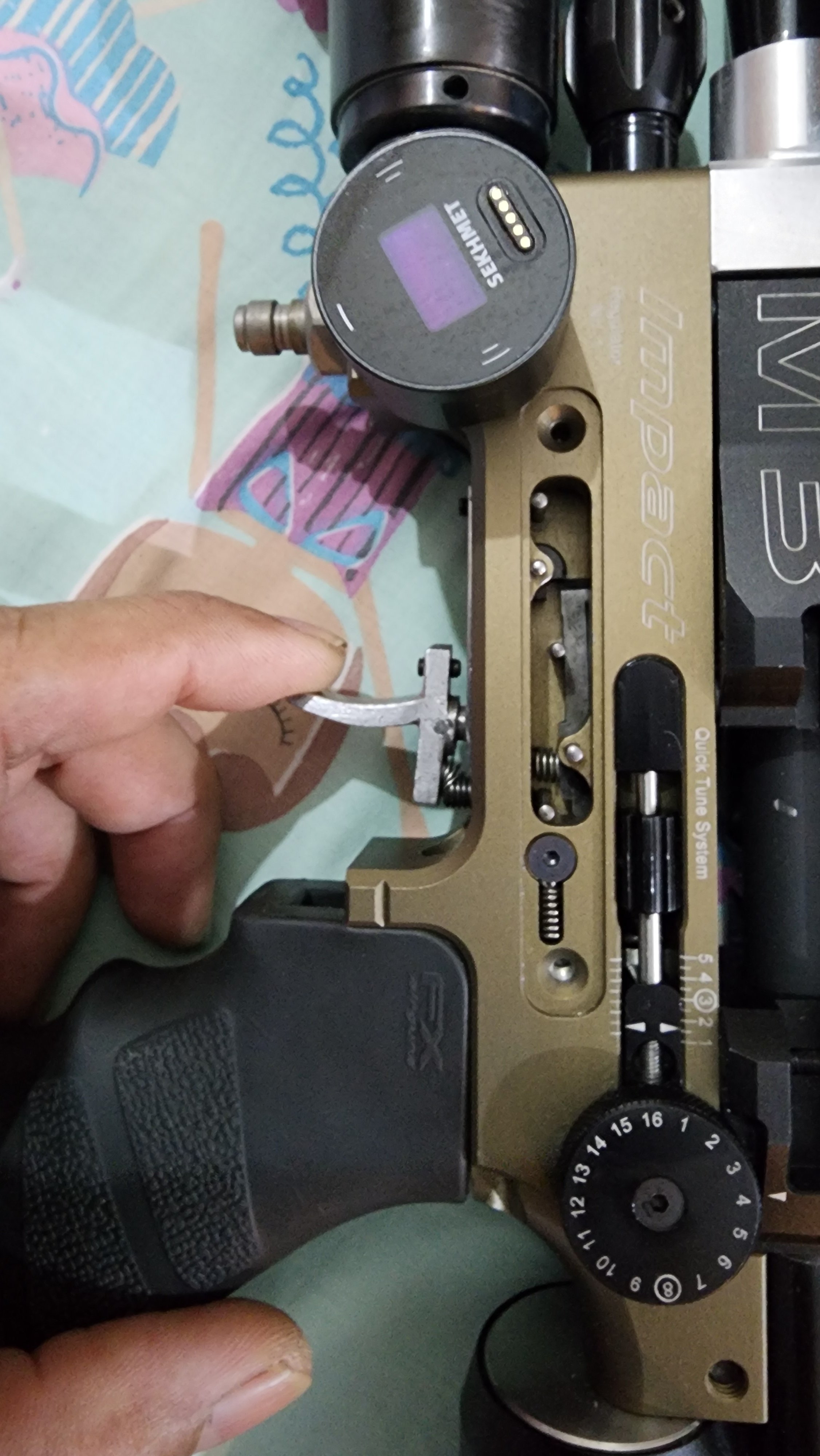

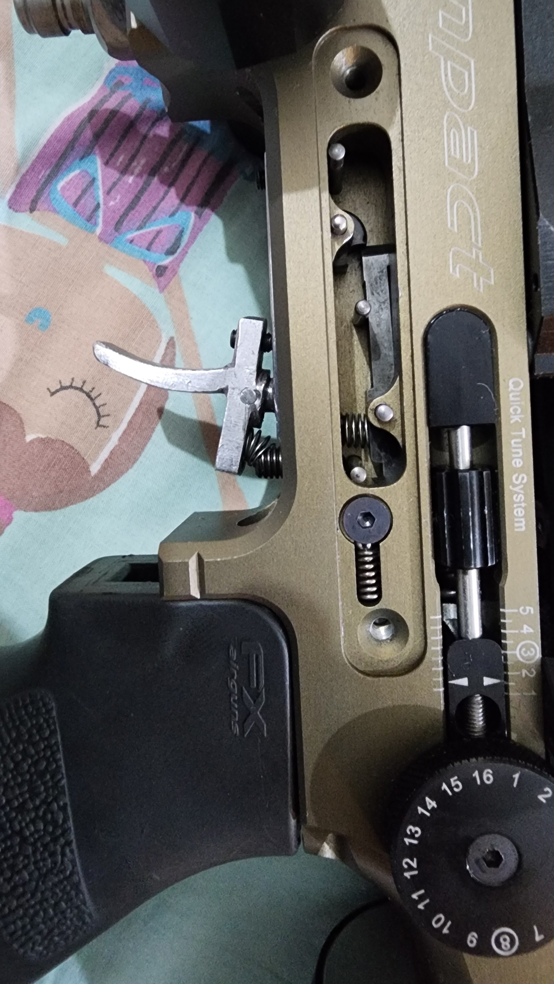

I have installed a separate and independent lighter spring for 1st stage.
I redesigned the trigger, then removed the 1st stage from OEM trigger design and incorporated it in the trigger blade.
Feels nicer.
Better designed spring and some refinements are required as it is the 1st phase of my this type of trigger.
