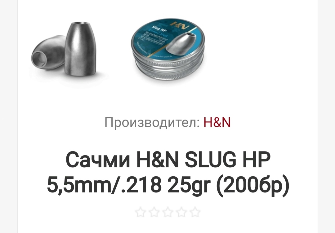

Thanks i will wait to next week will shoot a hit without touching it and than i will see these information i think to get h&n slugs 5.5
