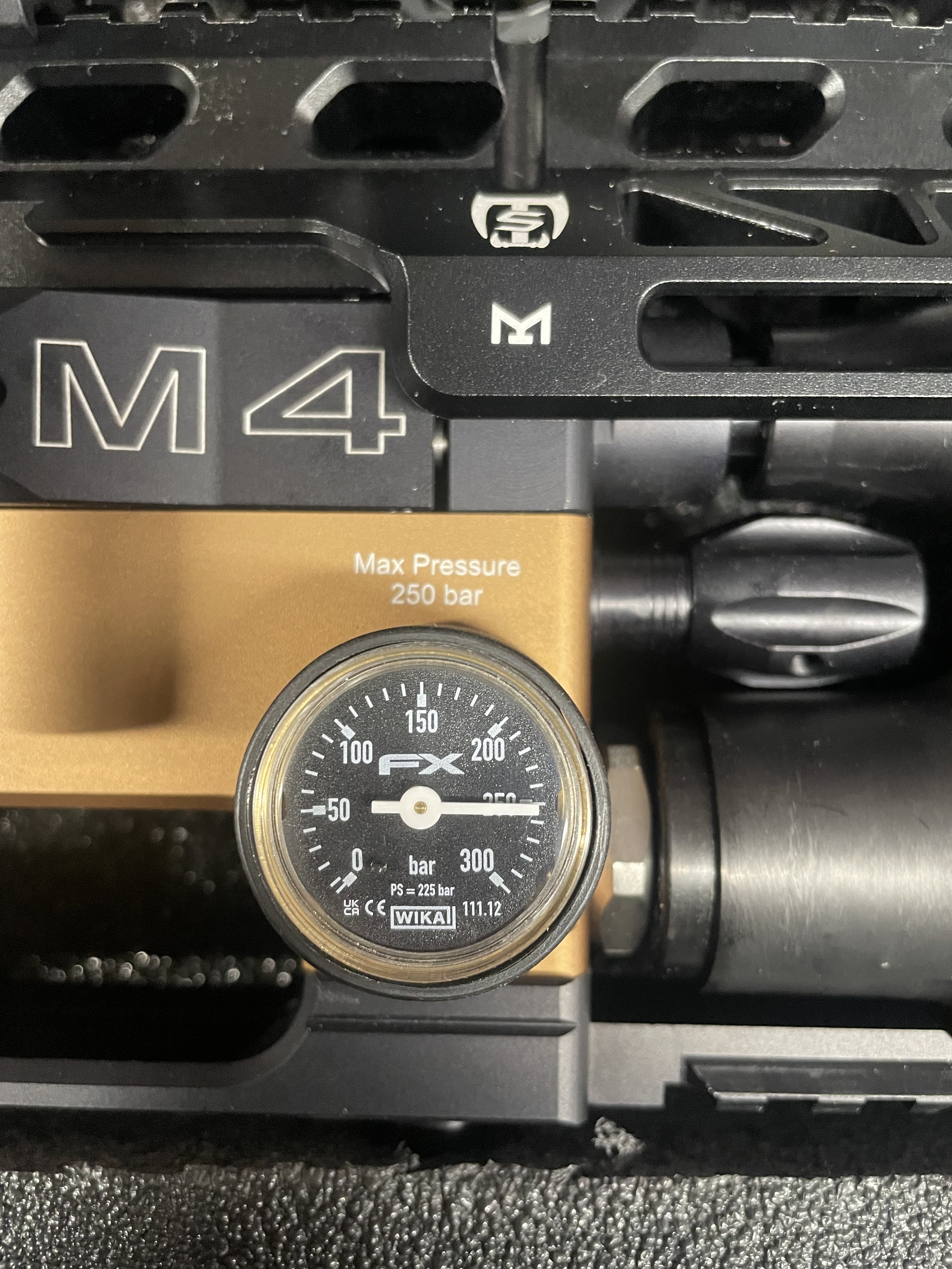

I've placed my order for a new .22 FX Impact M4 and knew from much research and reviews already that FX have removed the 1st regulator, apparently the new brass pin in the 2nd regulator can handle higher reg pressures and so there is no need for the 1st reg anymore, it all sounds good so far.
When I was looking through the FX manual online I couldn't find much information with regards to fitting a 300Bar bottle to the M4, the information was getting a little hazy with no direct answer.
So I contacted FX directly and asked them if I can just install a 300bar bottle straight onto the M4 would that work or is something else required.
FX replied with:
"To mount a bottle with 300bar you need to install a first regulator that is mounted on the Impact M3. It has art no 20540 Bottle connector Impact M3 cpl. Also manometer for the first regulator. You see this on the exploited view on the Impact M3 here in section D F10370-Impact-M3-230925.pdf (fxairguns.com)"
So clearly from FX's response the M4 is not designed or supposed to have a 300bar bottle & fill, as the now only "2nd regulator" must not be able to cope with that pressure despite its new design / brass pin.
This is really disappointing, its essentially a downgrade and you now have to spend more money and time to reinstall the first regulator & manometer etc, just to get a 300bar fill on it, but on the M3 you could just screw set the pressures and put on the bottle, job done.
Whats everyone's thoughts on this ?

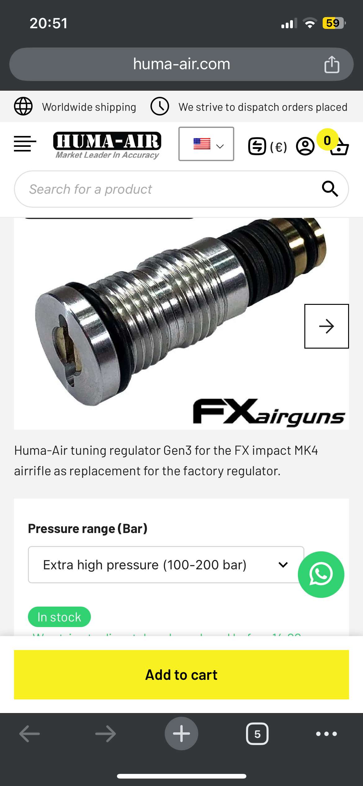

After reading this, I did look at the different bottles available and saw where the 300 BAR was only $10 more than the 250 BAR, so yea, I'd probably pay the extra $10 to get the 300 BAR bottle, but would probably still only fill it 250 BAR. I'd see the extra 50 BAR as a safety margin and as Trucker mentioned, save the regulator. I own 5 FX airguns, only 2 still have the original AMP regulator installed, the other 3 have a Huma Air regulator because the AMP regulator failed.
I reached out to Huma Air and they say their Impact M4 regulator will work with a 300 BAR Air Tank, so there's that option as well.
Yeah that extra $10 makes total sense doesn't it, & on the M3 which has 2 regs already you could just screw it straight on even if you want to keep filling to 250 you've got a cushion of safety, or perhaps fill near half way say 270-275bar, then once the air has cooled back down to room temperature and the pressure has naturally dropped back to 250 anyway you've essentially got a "full fill" instead of the current 250bar fill you do, of which is really only 235-240ish after its cooled down.
Thanks for reaching out to HUMA I'll get in touch with them it does sound like these are better regs and a more viable option.
Would you recommend the HUMA regs over the original in an impact ?
Thanks
I have had great luck with the Huma Air regulators. When the AMP regulators fail, I just replace them with a Huma Air regulator and not look back! I'm sure I will eventually have them in all my FX airguns! Most of my airguns have a Huma Air regulator in them, either added because it wasn't regulated or as a replacement for a stock regulator that failed!
