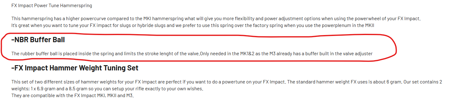

Does the rubber ball really reduce power? I have it installed in my setup and I just never took it out. Like any idea how many fps difference?
Hi, yes it it makes a big difference, my .22 cal Impact M4 is tuned at 990-1000fps shooting a 34gr slugs, I could get it to go higher but the rifle isn't far off being maxed out as it is, if I make no changes at all and just install the ball it reduces to about 780fps, its a big difference and big reduction in power.
If it is installed it shortens the stroke of the valve rod so it cannot hit the valve as hard, this means less air is released meaning less power.
The ball is only for earlier versions of the Impact, From the M3 upwards its not required, it will actually reduce power. Test it for yourself, it only takes 10 seconds to remove the ball and no tools are required.
Hopefully this helps :)
