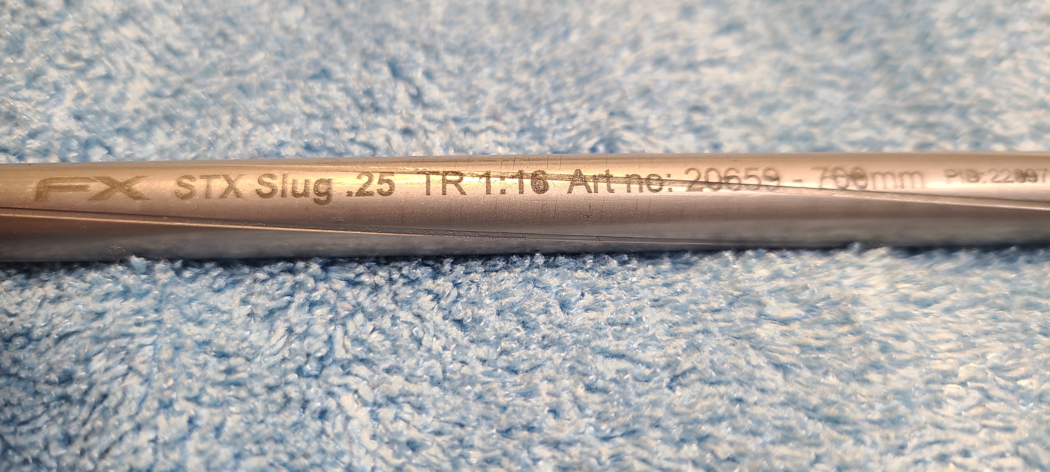

The liner has
FX STX Slug. 25 TR 1:16 Art no:20659 700mm PID 22897
on the liner.

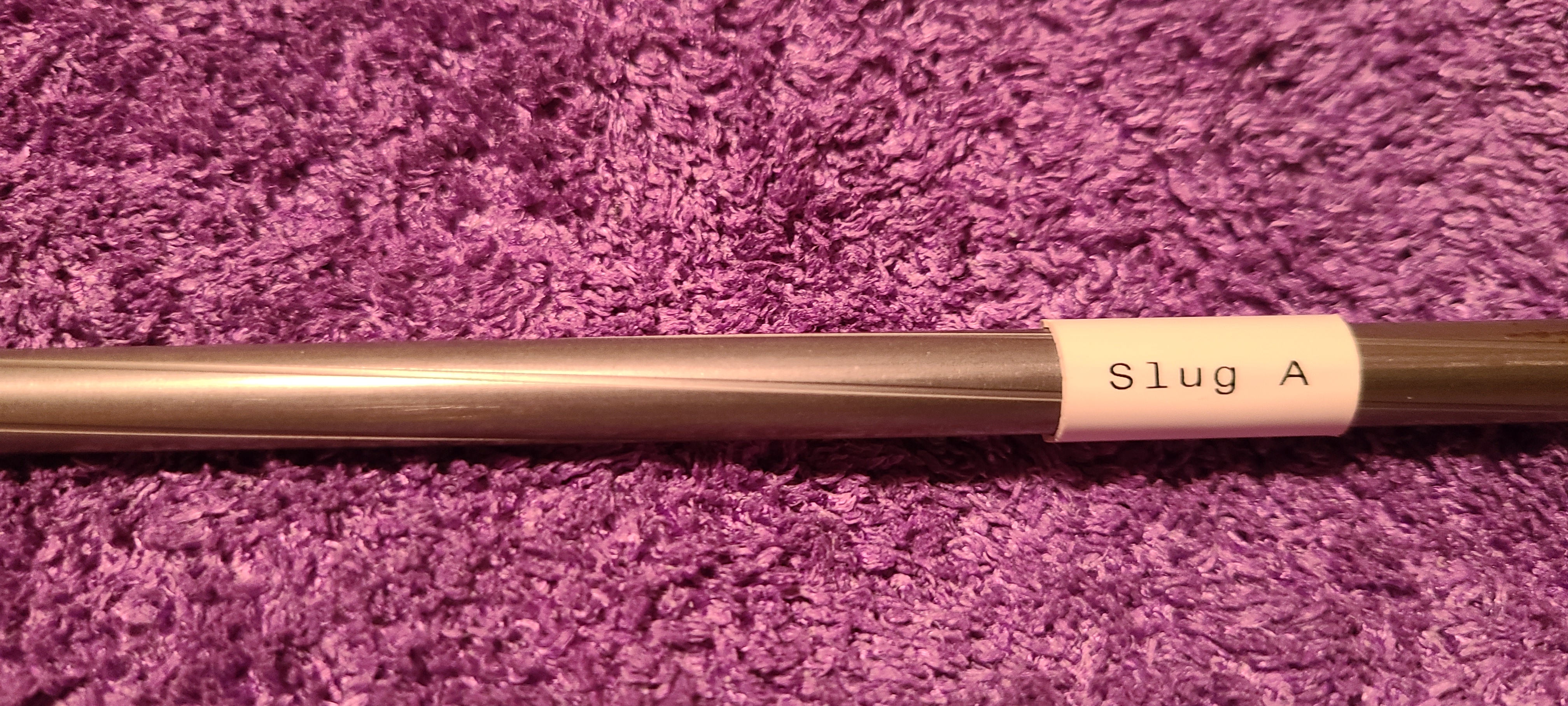

My original slug liner A has a piece of shrink tube that says Slug A on it.

The liner has
on the liner.
Exactly this part no. But I think the colloquial use of "slug a" is because it's the same exact twist rate and as this post stands as proof. It's confusing to many.
