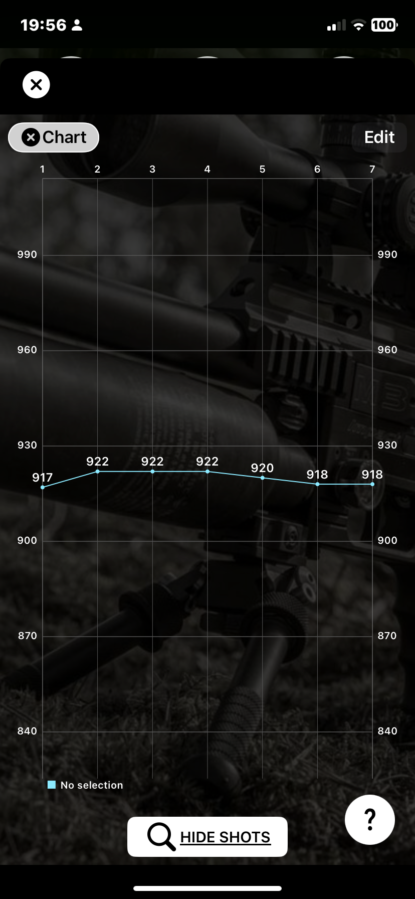

so i have an issue regarding my M4 first 10 shots are lower fps by almost 80 fps
then the gun shoots normally to my tuned fps ( 915 ) looks like it’s commonly issue with many m4 users .
when the gun rests for couple hours i have to shoot almost 10 shots before it settles again
any one having same issue?
if yes what did u do ?
Okay idea but no...not acceptable to have to change settings to get up just to go back down.....what a pain,when you have a 2k airgun that should be off the table,valve sticking issue that is 99%of slower shots when sitting over couple of hours or from the day before ,valve polishing is the trick boys and gals.When I had an m3 I tuned my max sweet spot velocity with the macro wheel set on 12-13. That way when I shot the gun cold I could put it on 16, giving it extra hammer strike to overcome the stiction. Wasn’t perfect but it did make the first slow shots not nearly as bad. Big design flaw of the platform that I don’t think will ever be addressed. With the length of the valve rod in the gun I’m not sure it’s even possible to eliminate for good.
