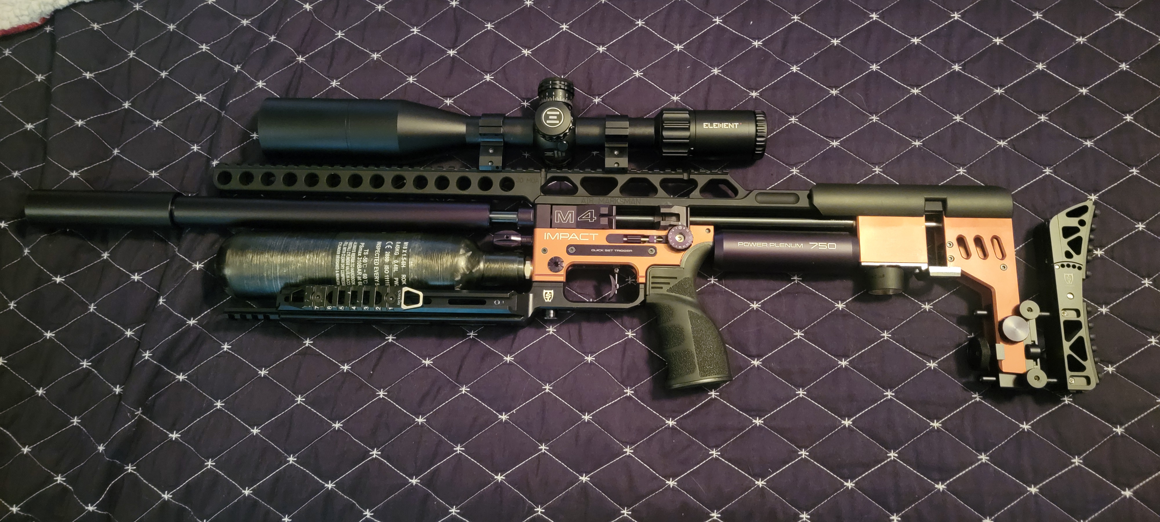

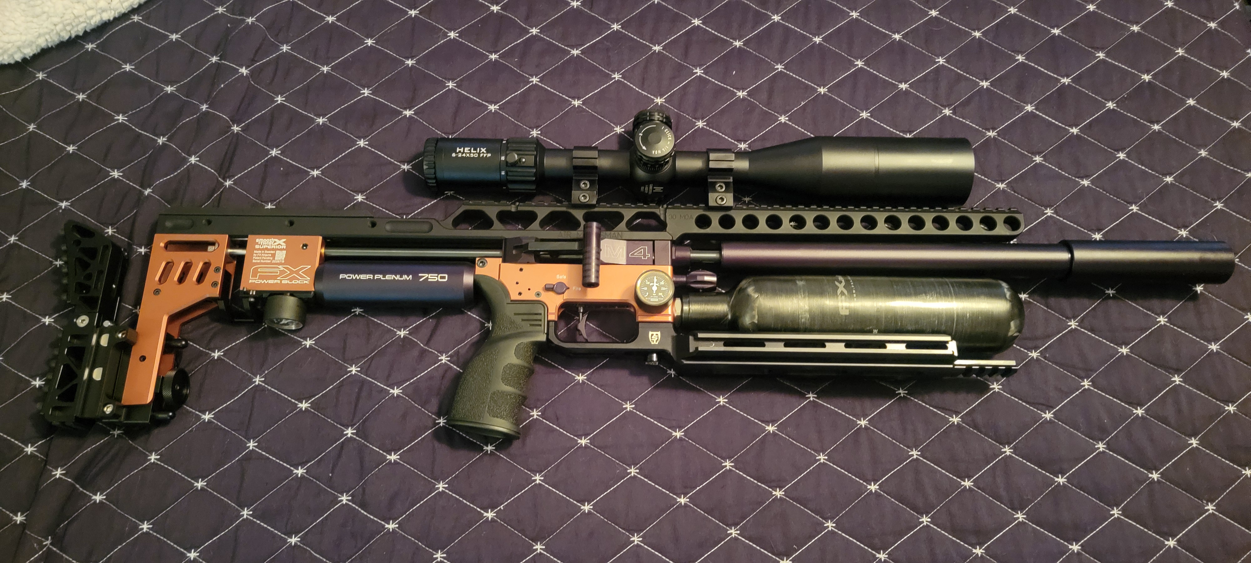

There is a change to the saftey. On both of my M3's you cannot engage the safety until it's been cocked. On my M4's you can engage the safety before you cock it.
That was a much needed saftey feature.
Its the first thing i noticed on my M4's and havent seen that published anywhere.
There are a lot of things different and all are 100% welcomed. It's worth buying / upgrading.
