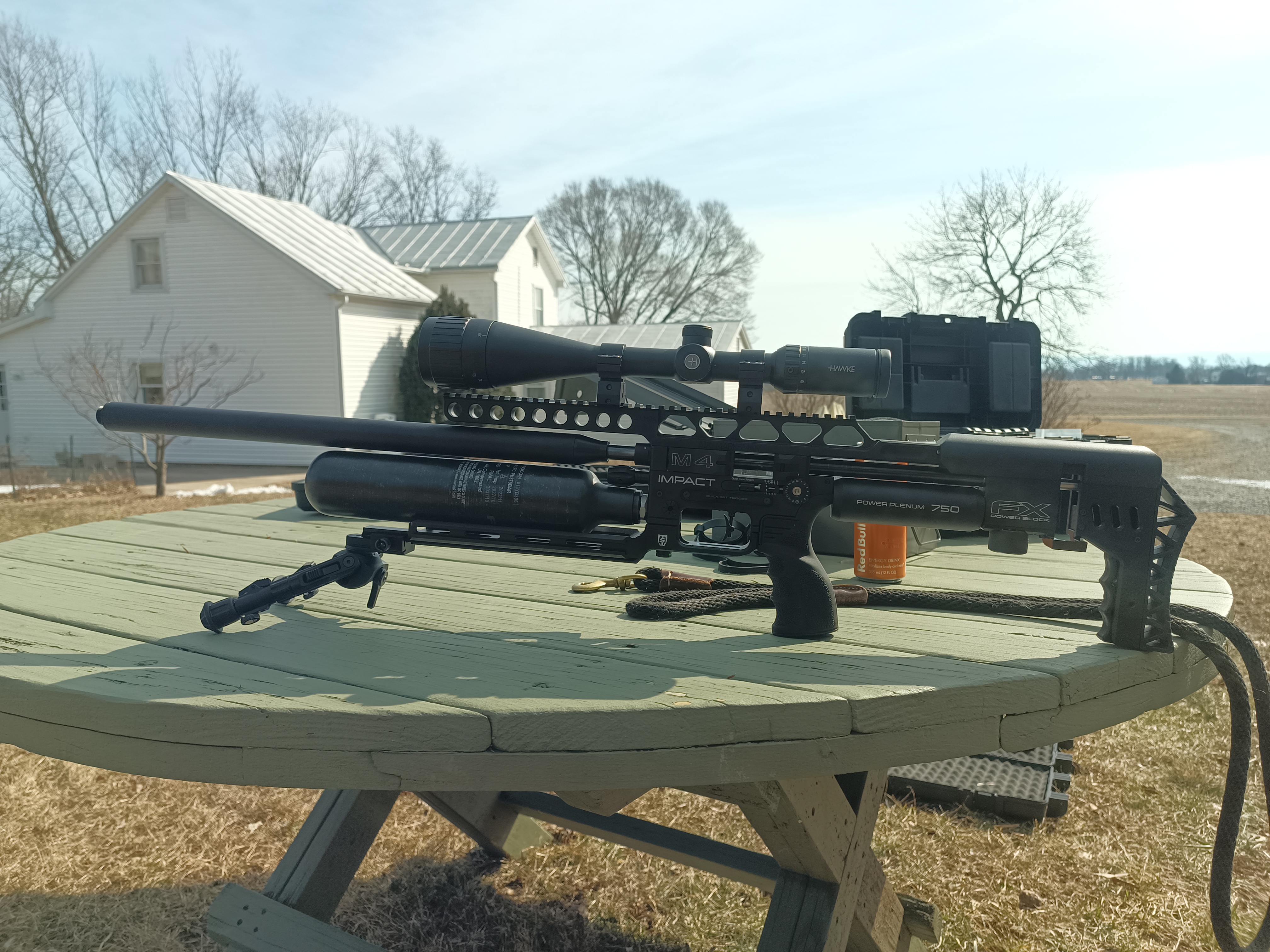

Mine doesn't. What pressure are storing at, at night? I love my M4. At first I wa unsure but it's grown on me big time. And the gun itself has literally grown, lol. I should have my 2"x6" moderator on the gun for this pic. That Donny fl is a mean one.
Reactions: coastal drifter
