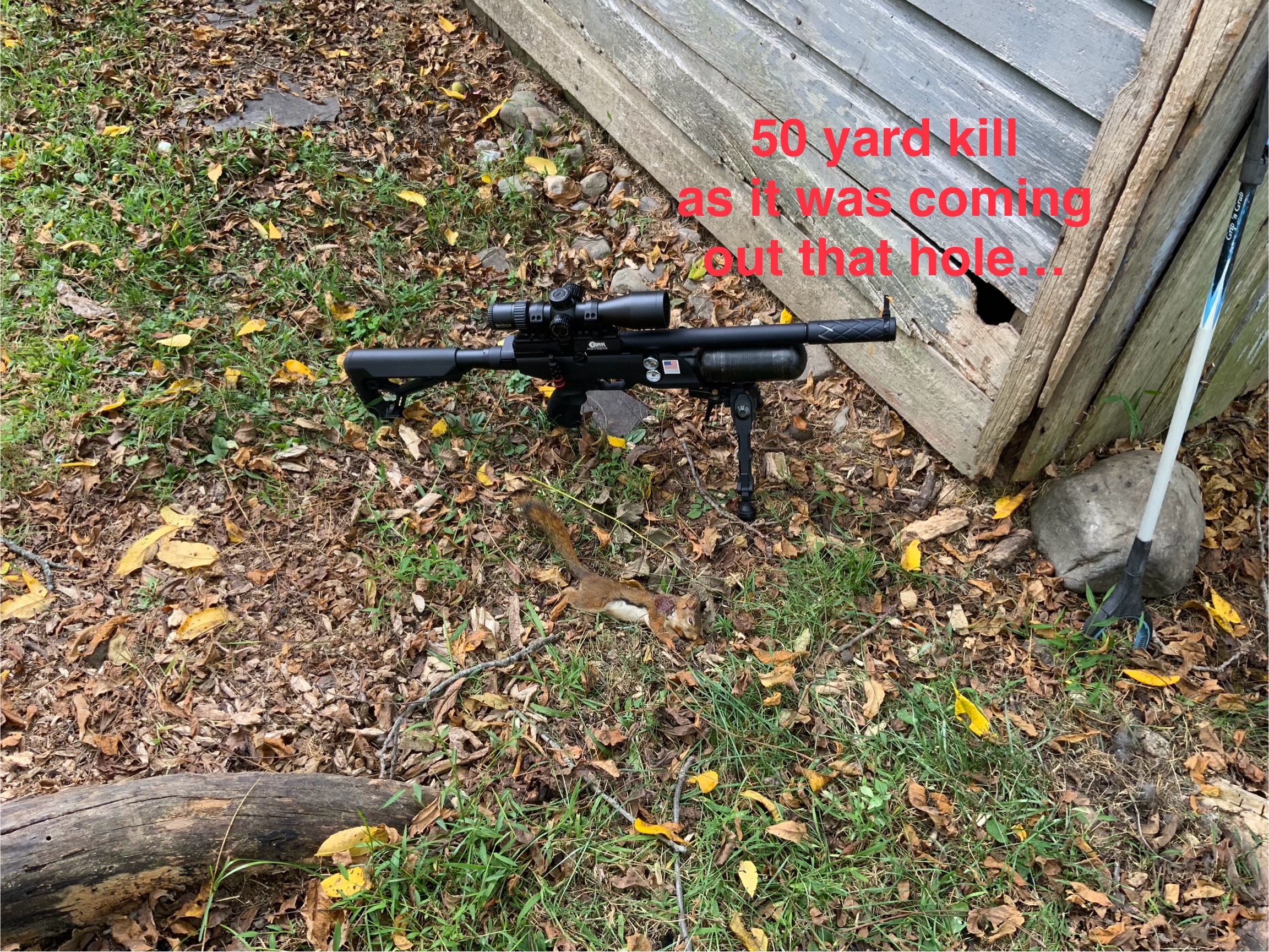

At your maximum stated backyard range of 15 yards…? An M4 would definitely get it done, but so would many other PCPs. Am surprised the Notos isn’t effective for you. “Knock down power”? At the ranges you’re describing, pass throughs are the norm. So there is no maximal energy dump as the pellets, hollow points included simply zip on through. Shot placement is the key, particularly with low power airguns. The Brits kill lots of squirrels at ranges further than 15 yards with barely 12 FPE PCPs… My favorite pesting gun generates 17 FPE at the muzzle, I have killed squirrels with it out to 50 yards.
get a taipan vet if you’re set on spending that much money. otherwise, a notos is really all you need. 10-15 yards is overkill for an FX M4 or even a vet. fx has a huge following but also a huge non-fan base and nobody really says anything bad about the taipans. that says a lot. the notos is good all the way out to 50 out of the box.. that’s a little over 4x the distance you mentioned. if it’s still too loud for you, get a blowgun 😂

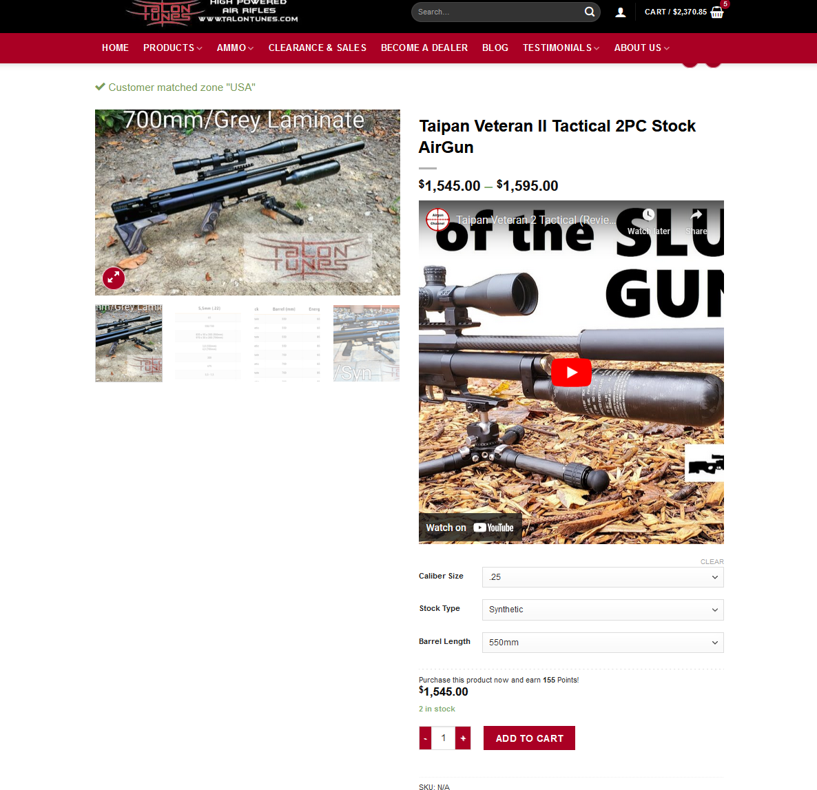

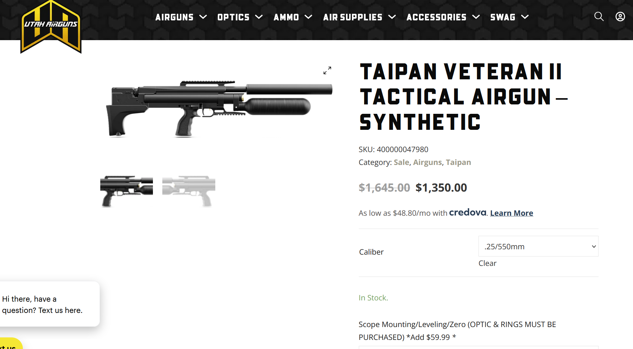

The Taipan Vet 2 looks like a great gun, going to do more research and reading to it, love the high capacity CC bottle and came with moderator, it pretty much met all the criteria and about $500 cheaper than the Impact M4 :D If i were to get the Vet 2 should i get it from Talon Tune or Utah?
Are these the same gun? Utah seems to have it cheaper, couldn't tell any difference in spec

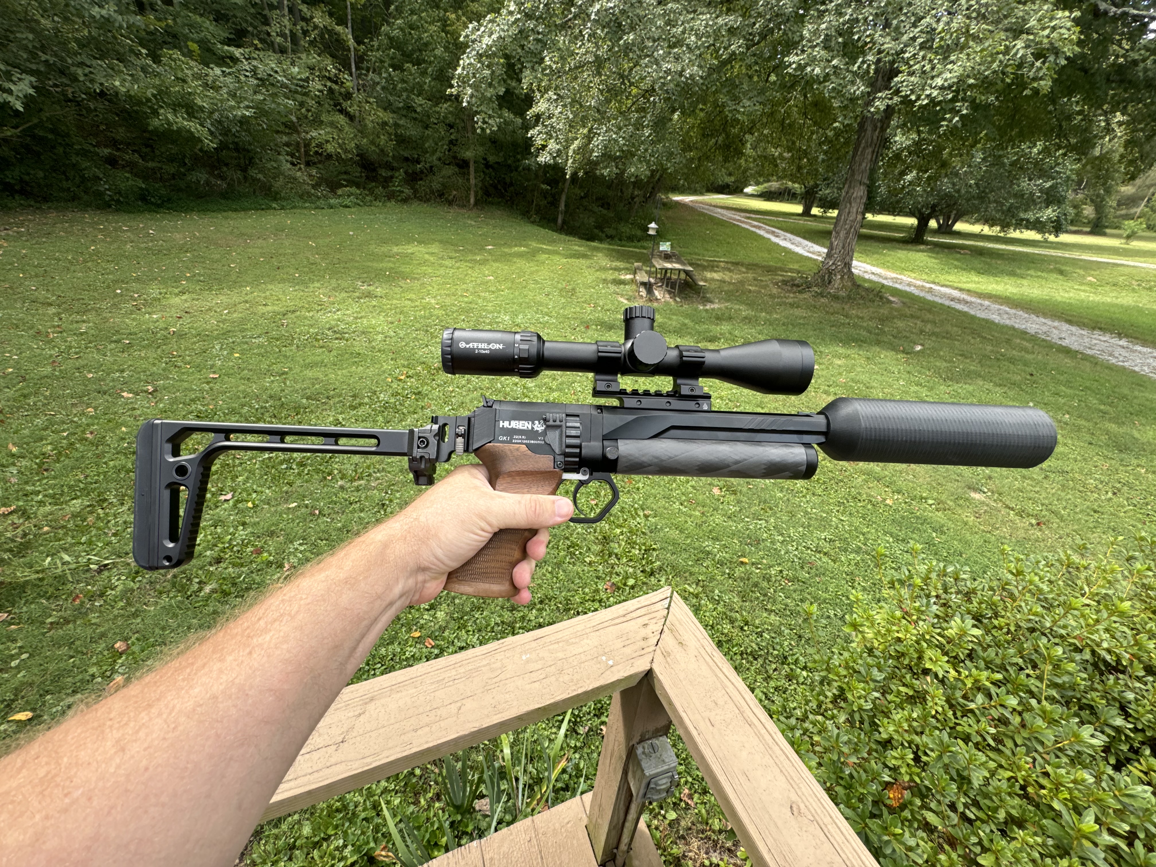

3. The current Huben mags are chamfered at the entrance such that no pellet seating is needed. In fact , seating only causes pellet skirts to be compressed, allowing them to rattle around. I have >22000 rounds through a GK1 with no seating and no issues. I can click 19 pellets into the mag using the OEM loading gate as quickly as I can open and load an FX magazine. I can sure unload them a lot faster, which gets expensive. I agree that there are concerns relating to safety but there are steps that can be taken (rotating the mag to an empty chamber) to mitigate that problem. I also posted a very simple method for Huben barrel cleaning, going in from the muzzle with a rod-in-tube holding a retractable patch. It’s so easy that I now favor its use on all my guns.
