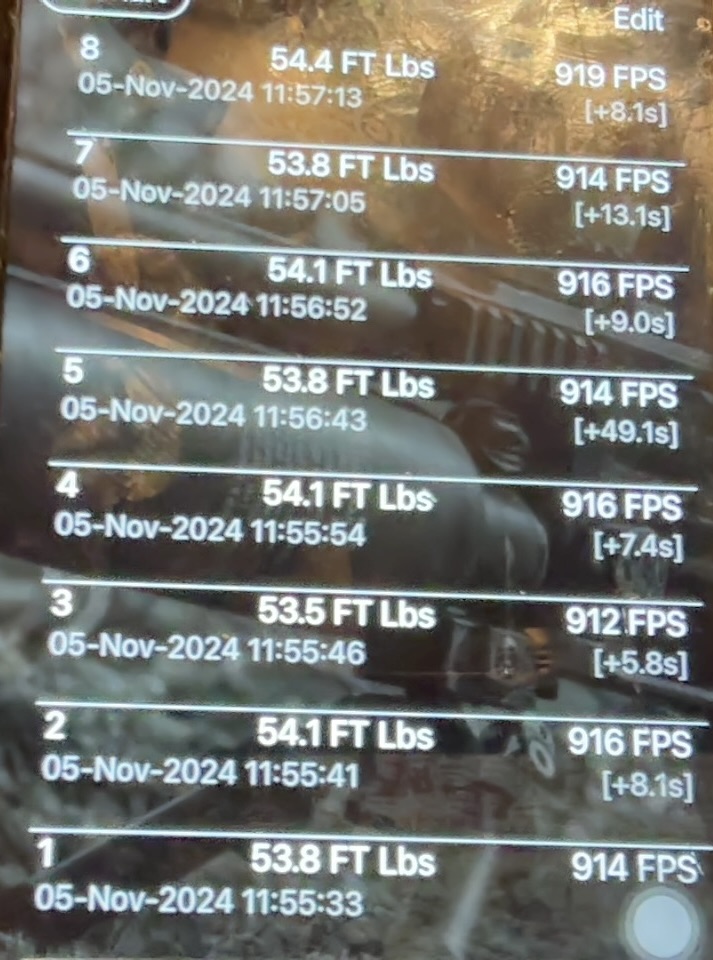

My Impact .25 M4 Compact likes the NSA 29 gr Dished.
