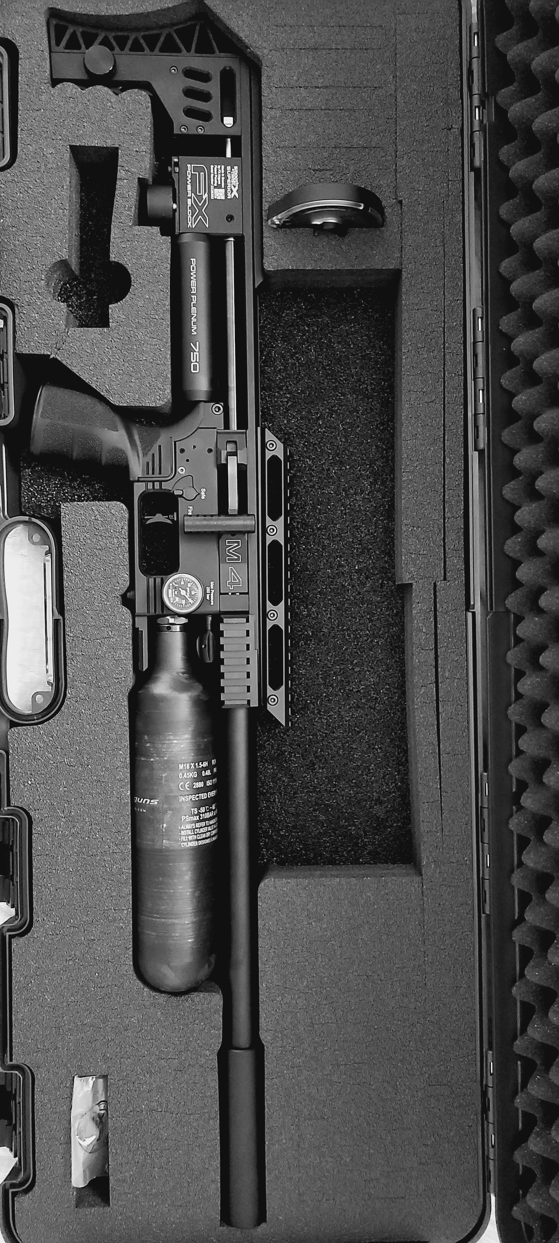

You have the sniper? 700mm barrel

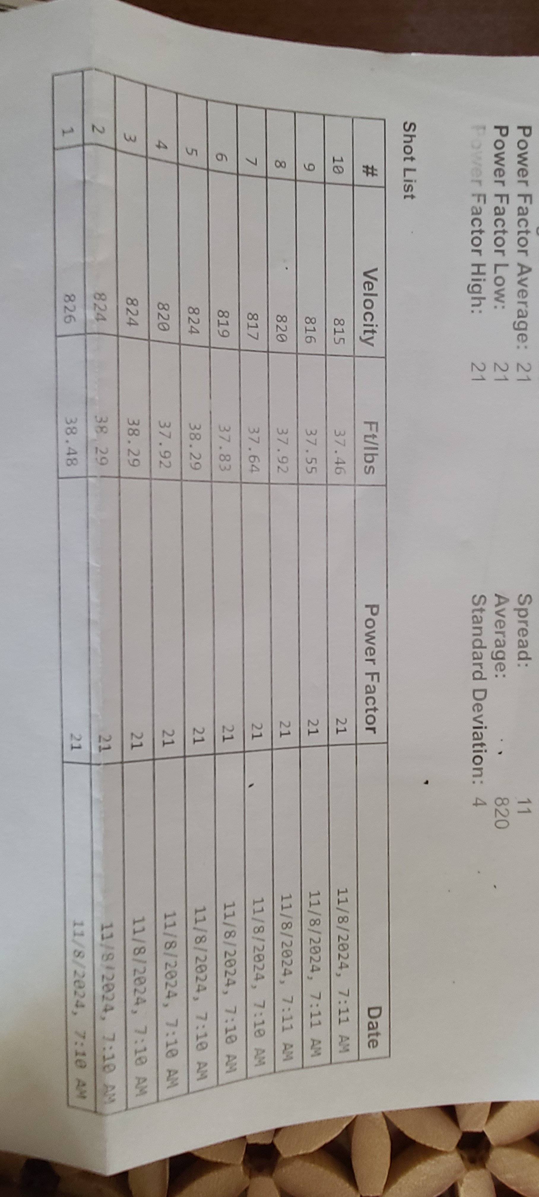

Out of the box the reg is at 105ish had pyramid do the 10 for 10. 820 fps out of the box.

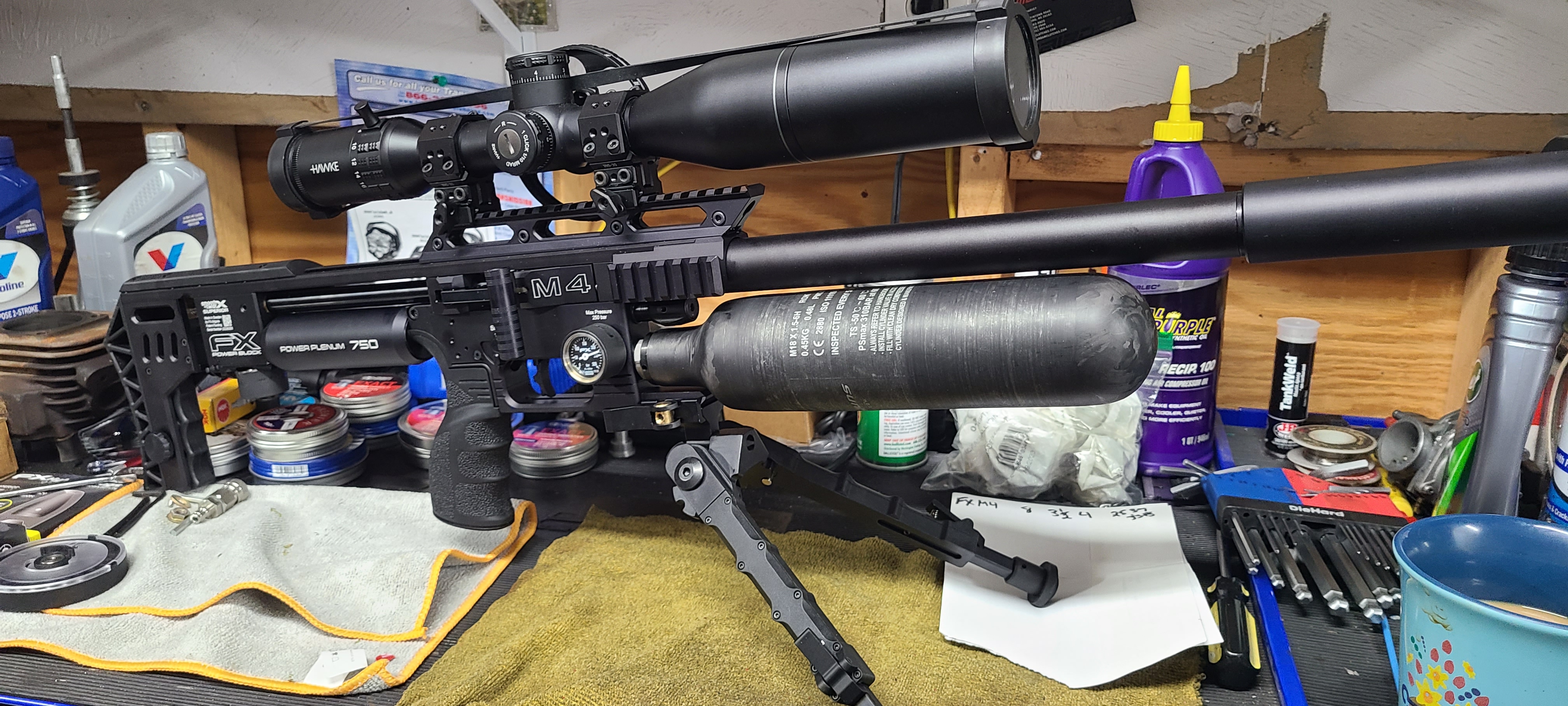

Yes it’s the sniper with standard superior STX liner ,out of box 105bar reg,16 macro ,3 micro and 4th line valve .was running 820fps with hades /26grain but would only give 720fps with heavy’s 34 grain .my reg is now on 130bar ,macro 16 and micro 4.5 with valve out slightly to approx 4.5 .Getting now 880 fps for the heavy s
Pellets .I think they are set up for the 26 grain fx pellets / JSB but if you want to run heavier pellets you will need to increase the reg pressure .

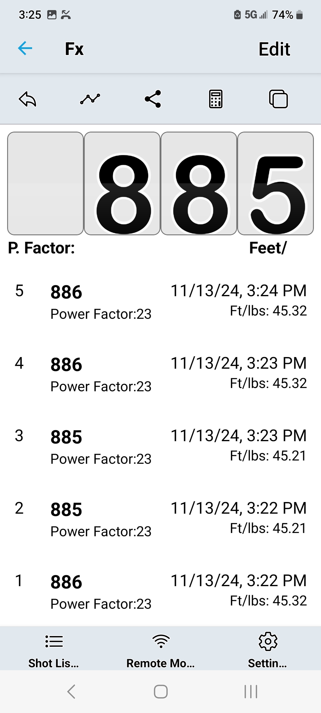

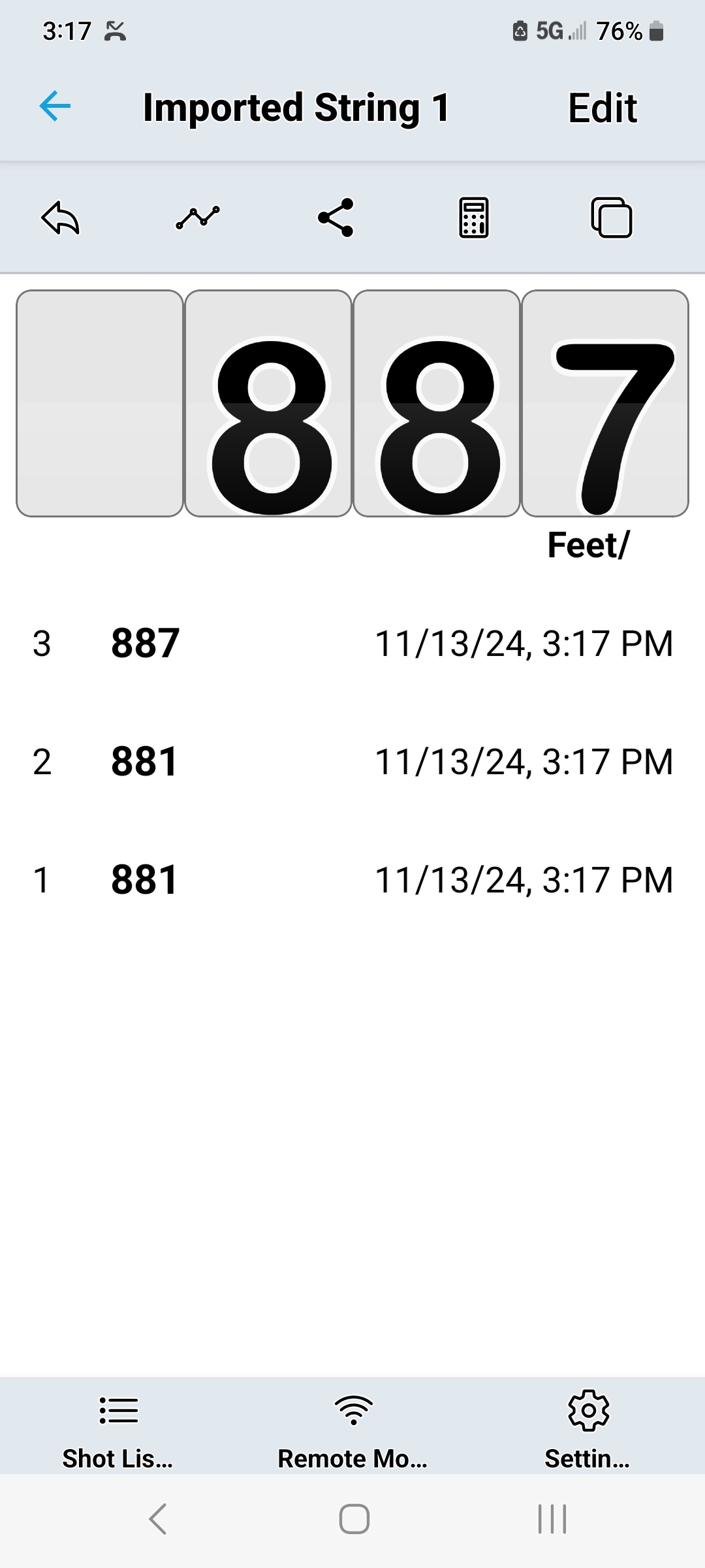

Left the reg at 105 ish just to shoot turned the power wheel from 16 down to 8 3-1/2 on micro and the valve stayed at 4. 821-825
Not sure if 39-degree temp affects them seem to shoot OK.
Turned the reg up to 120
Didn't touch nothing same
Settings just reg 885-887

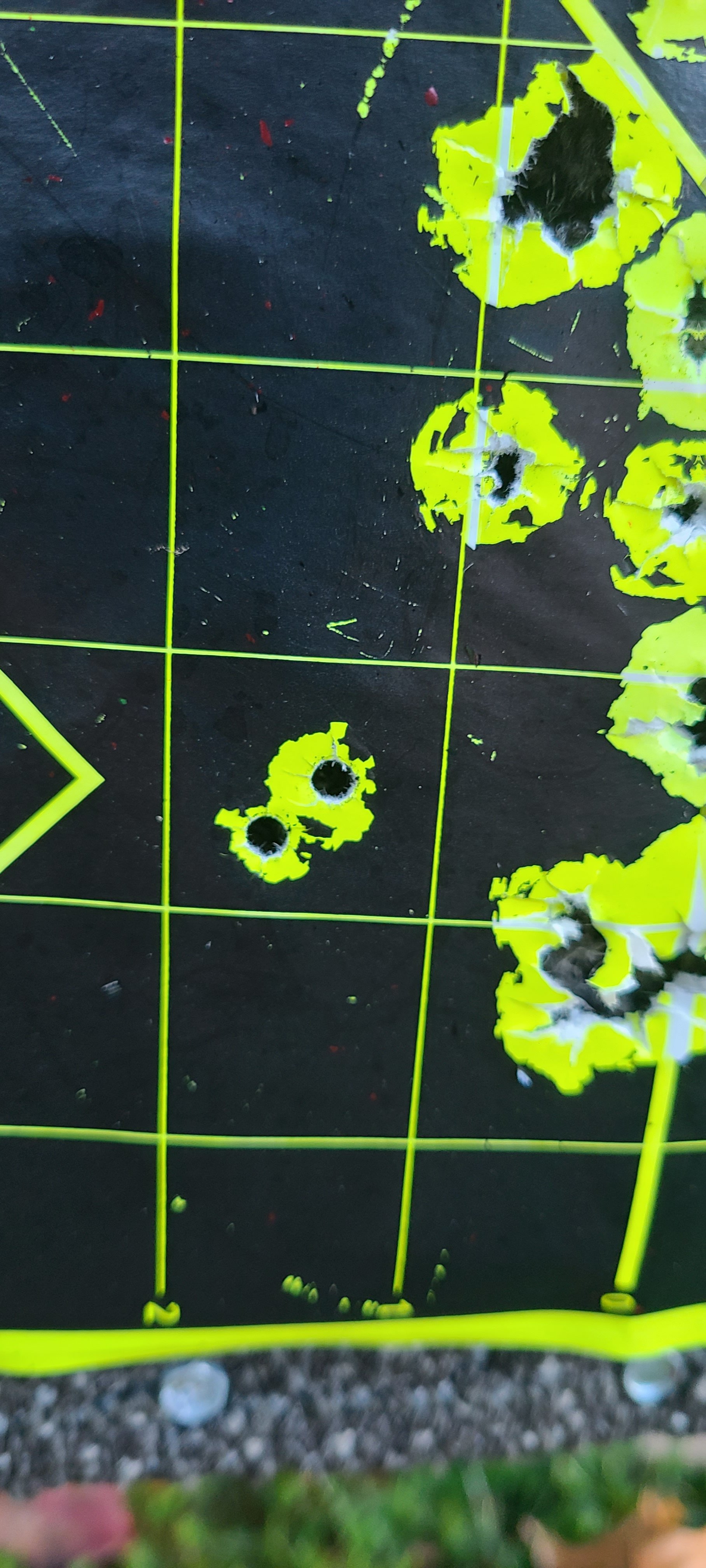

I will say couple clicks in the scope it shot pellets well at 40 yds 3/4 hole.

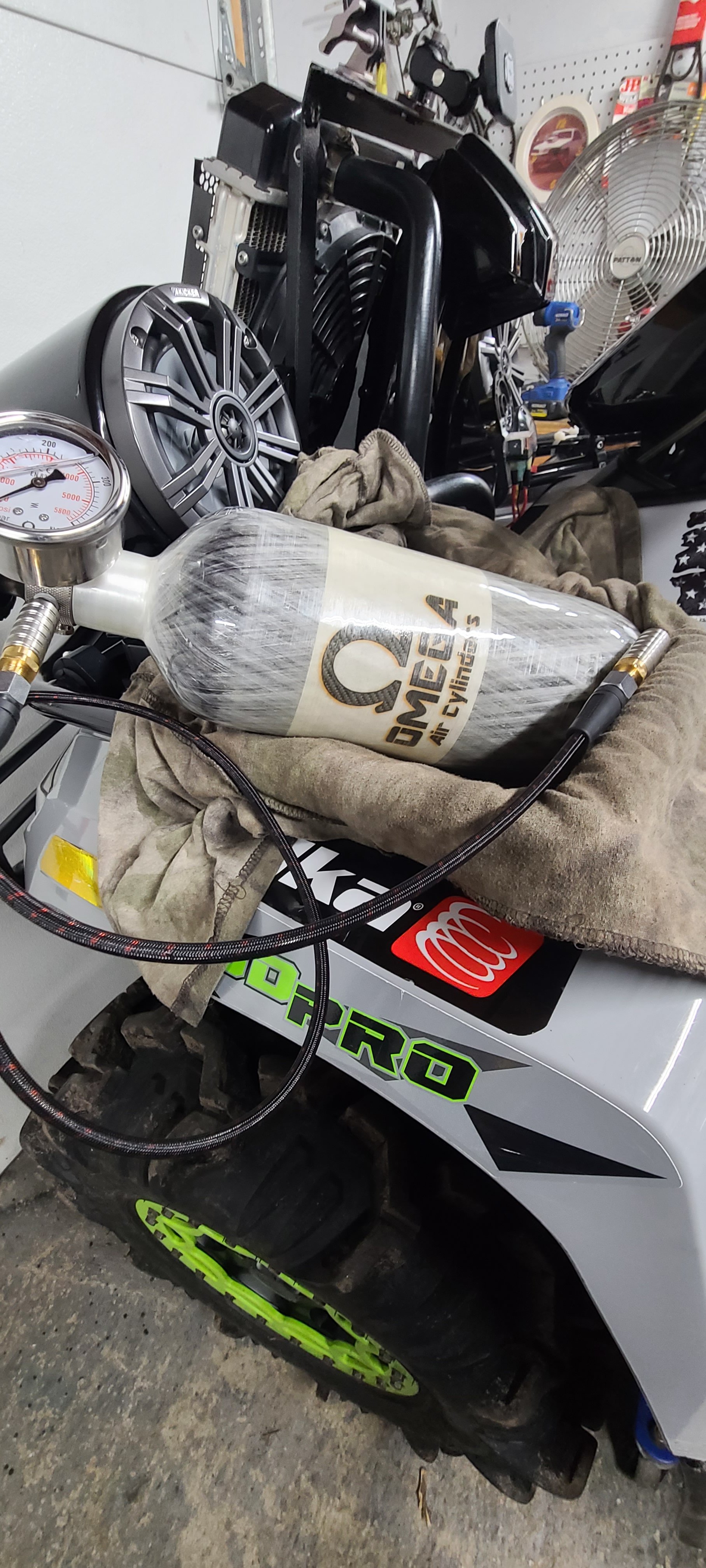

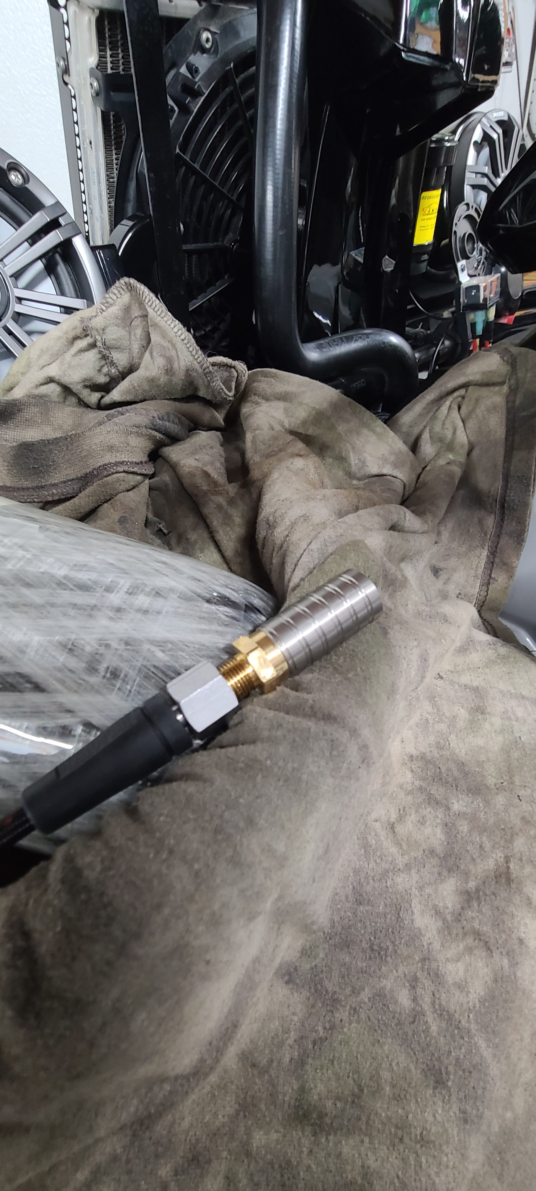

Also got an omega 18 cu ft
Tank with the new c3 valve and flexible hose they come with tall narrow female foster make filling easy.
1st target is the 3 26 hybrid fx slugs 2 out of 3 were close I was just curious how they flew at that speed 885-887 fps 3rd top right corner.
2nd and 3rd targets were the Jsb King Diablo 25.39g those shot well so far at 883-886 i think the Groupe will tighten up
with a little more speed.
