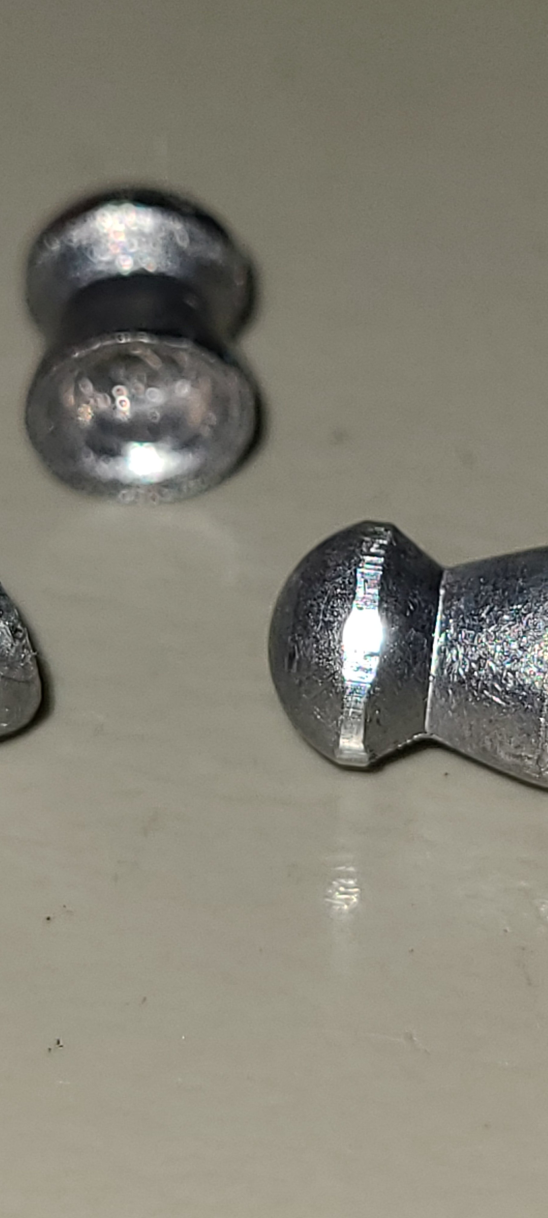

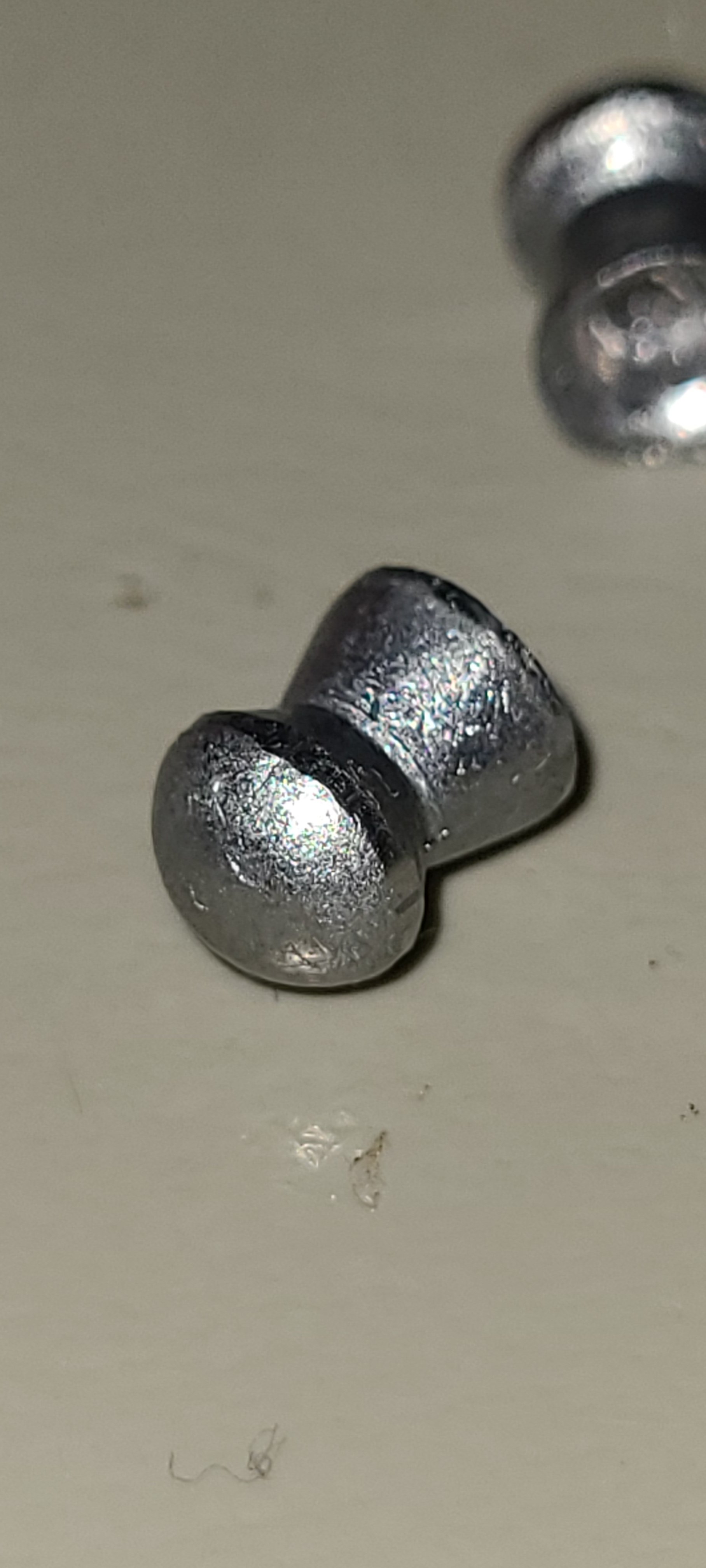

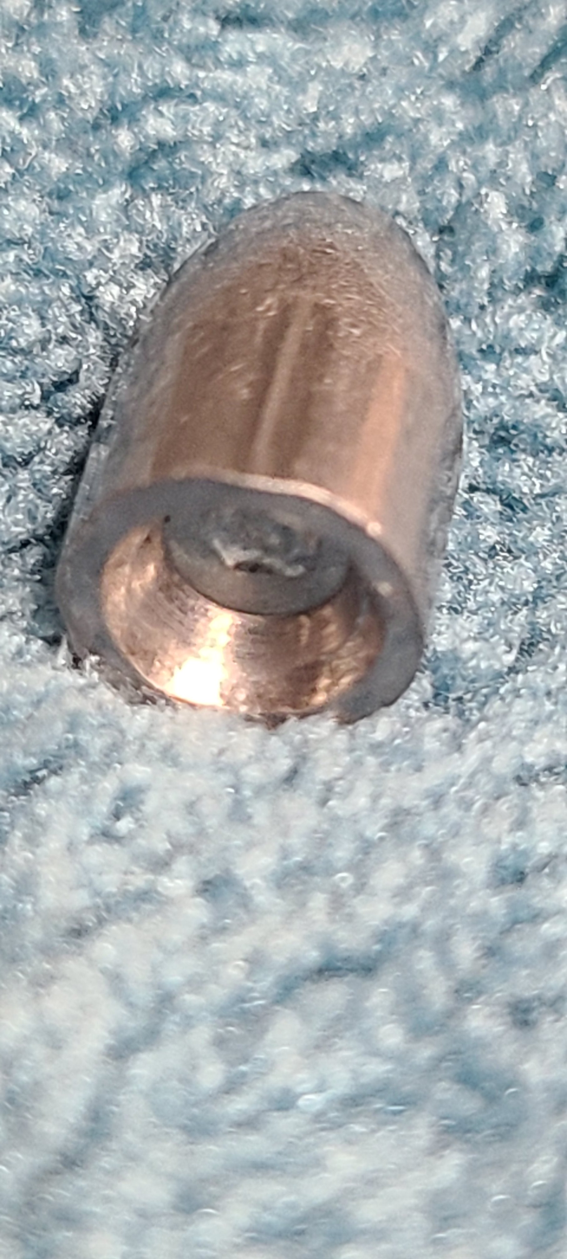

Well I think I found a small issue with the zan slugs
Seem to be a little bigger
Than the hybrids from fx

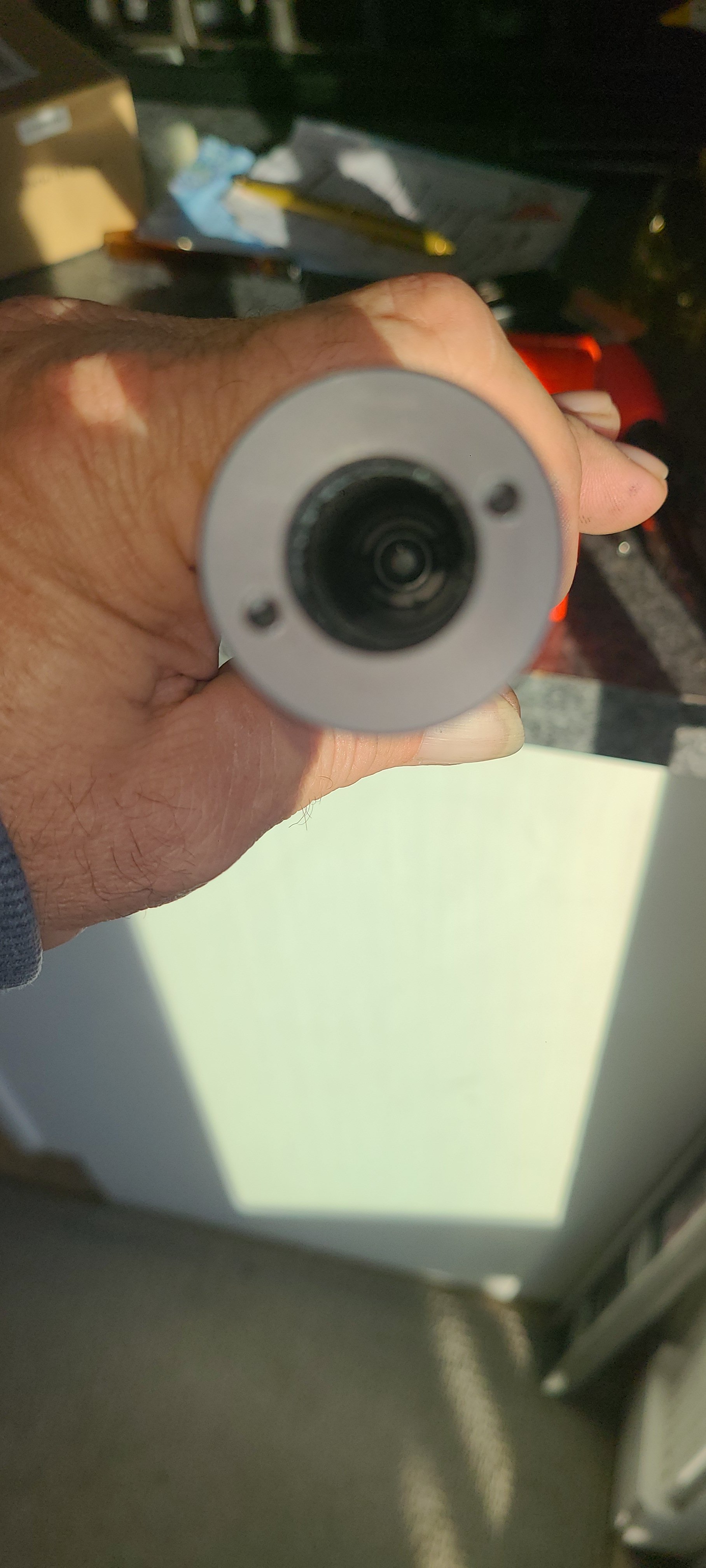

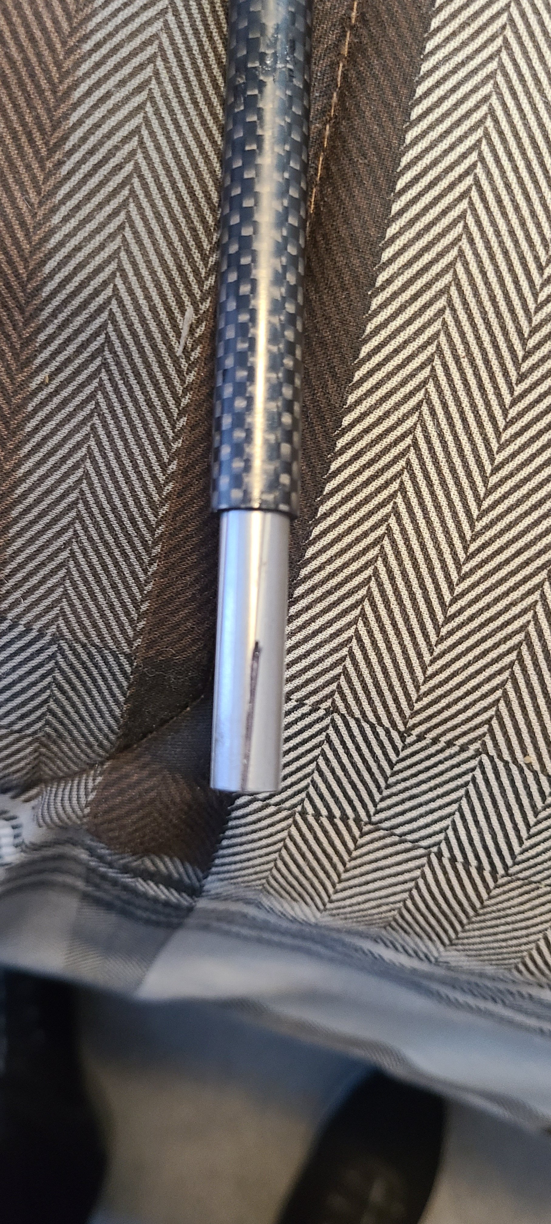

Also indexed the liner while installing the CF liner sleeve

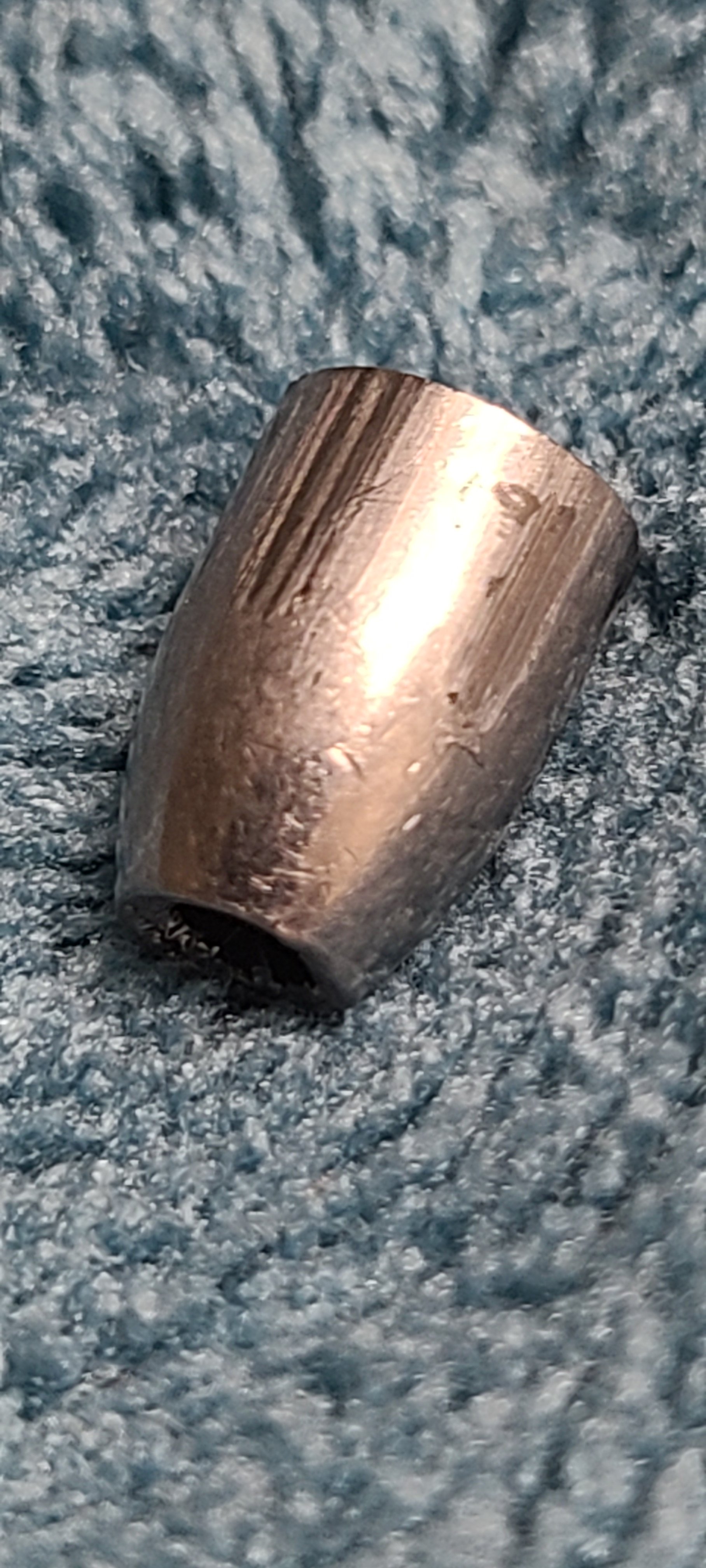

Ran some jb through the choke of the barrel took the high spots down
As the pellets were getting grooved just as bad
Here is an after photo of a pellet pushed threw after
Doing the barrel pushes smooth now and very little hint of the barrel
Did this to my 380mm barrel for the notos as they was just as bad

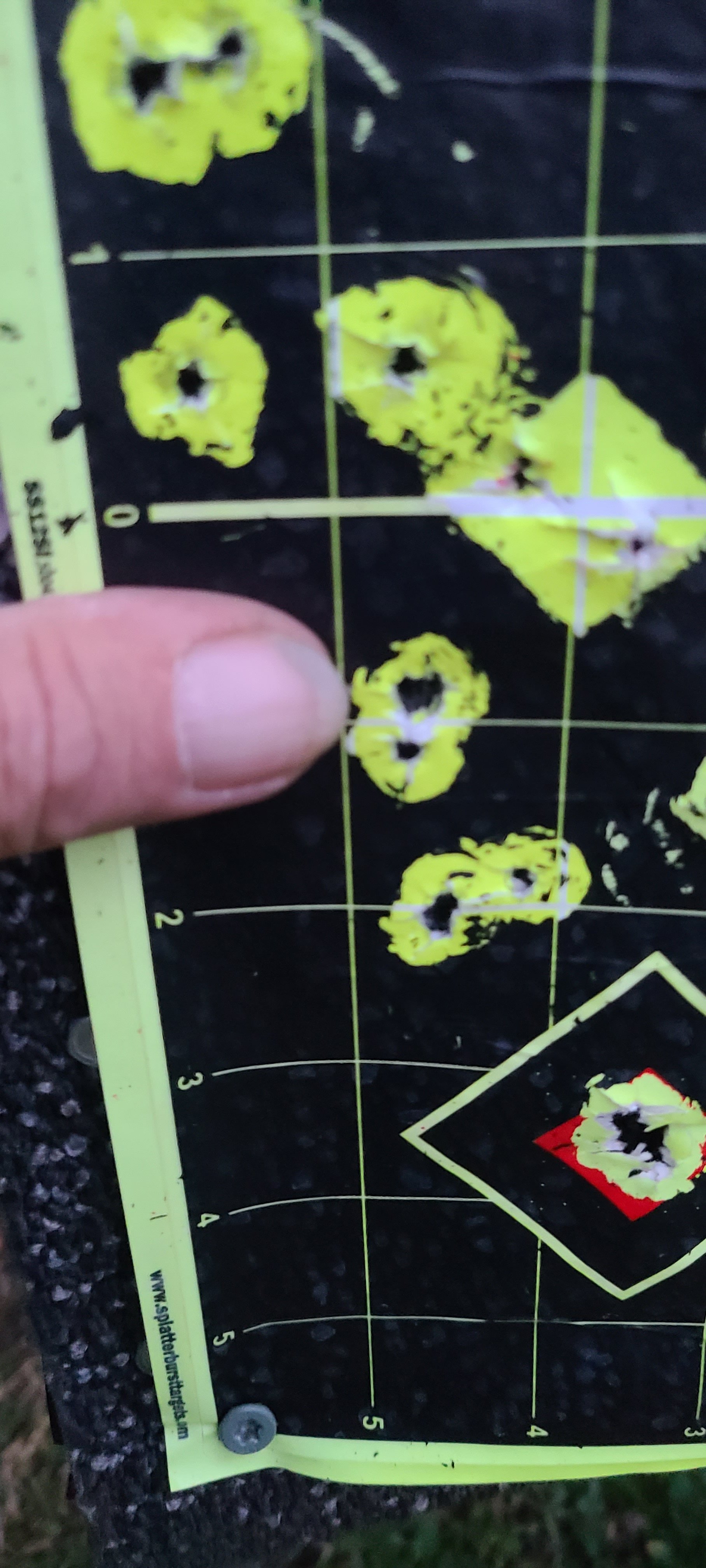

Shot 2 groups of 12 on the 3rd group went from 3/4 down to a dime crono battery died so no other adjustments
But very happy with the poi now
Also didn't know there is an active air stripper Inside the shroud now I see why the mod is empty

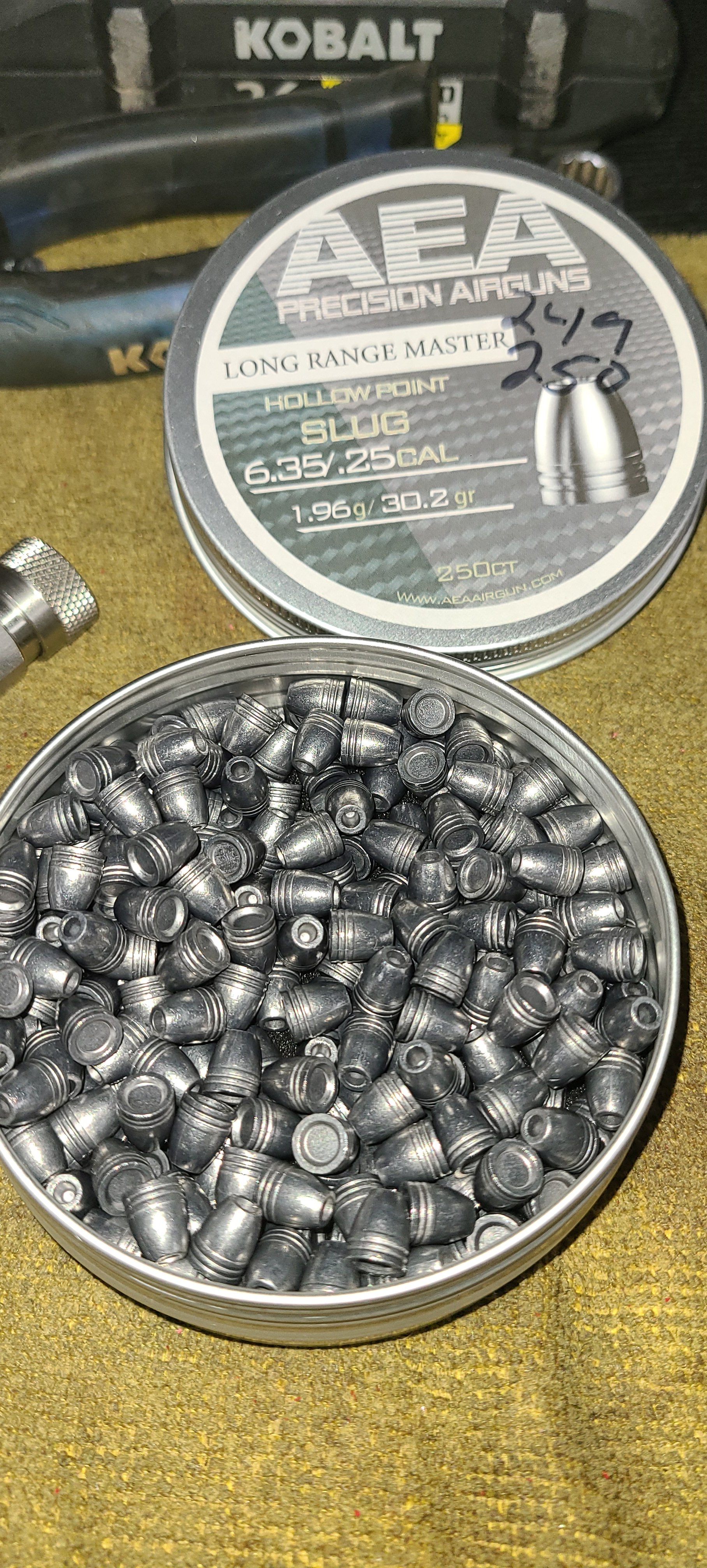

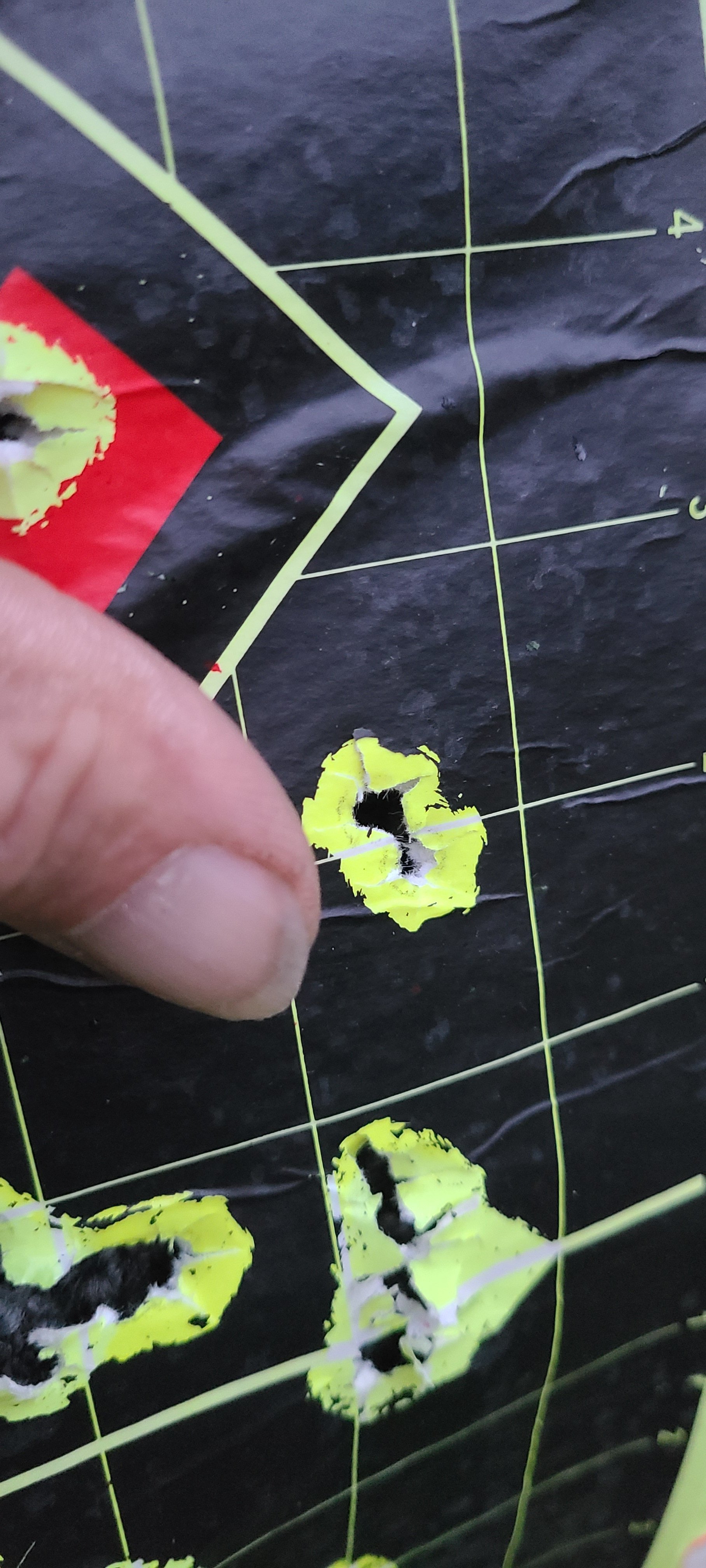

well decided to put the superior heavy liner 21007s is the numbers on this one
i see 2 different numbers for this same liner early and late made ?
shot a couple of mags through the barrel
this was the last 3 5 shot strings have no idea what kind of fps was getting dark i know the jsb 25g were at 905=910 fps
2 groups with the AEA 30g slugs at 50 yds size of a dime,, these AEA 30 and 33g fly like pellets with this combo
made no adjustments going from the jsb25g
going out to 75yds in the am
HogKiller thanks again

What speed are you sending them?!
the 25g jsb pellets were at 905-910 fps my chrono could no longer see due to getting dark
25 to30g I'd guess 870=880 fps maybe will know in the morning; I will say out of zan nsa fx hybrids so far these shoot-like pellets
i just bought 4 more tins lol

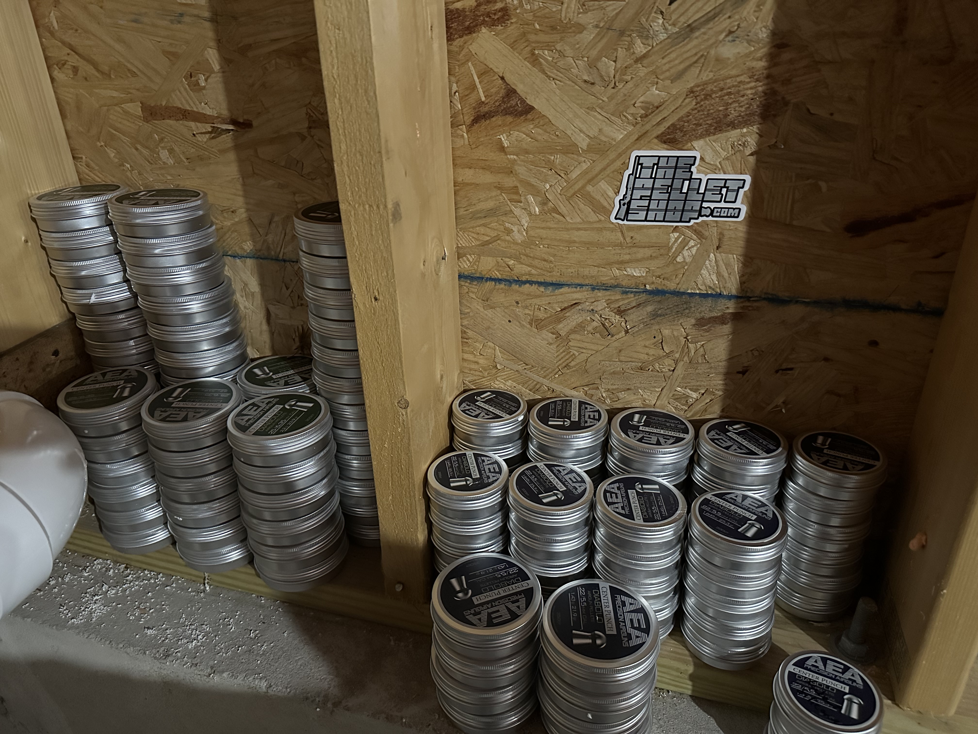

lol, maybe I was sending them too fast?! Didn’t go down all the way to the 800s… strongly recommend to stock up (for real) once you found what the gun REALLY likes. You never know whether a change will happen, prices go crazy or suddenly things are out of stock forever. Literally ALL my guns love the AEA pellets, sooo:
