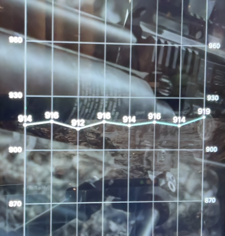

got to get some shots over the chrono today those AEA 30 grain group very good at 890 fps.

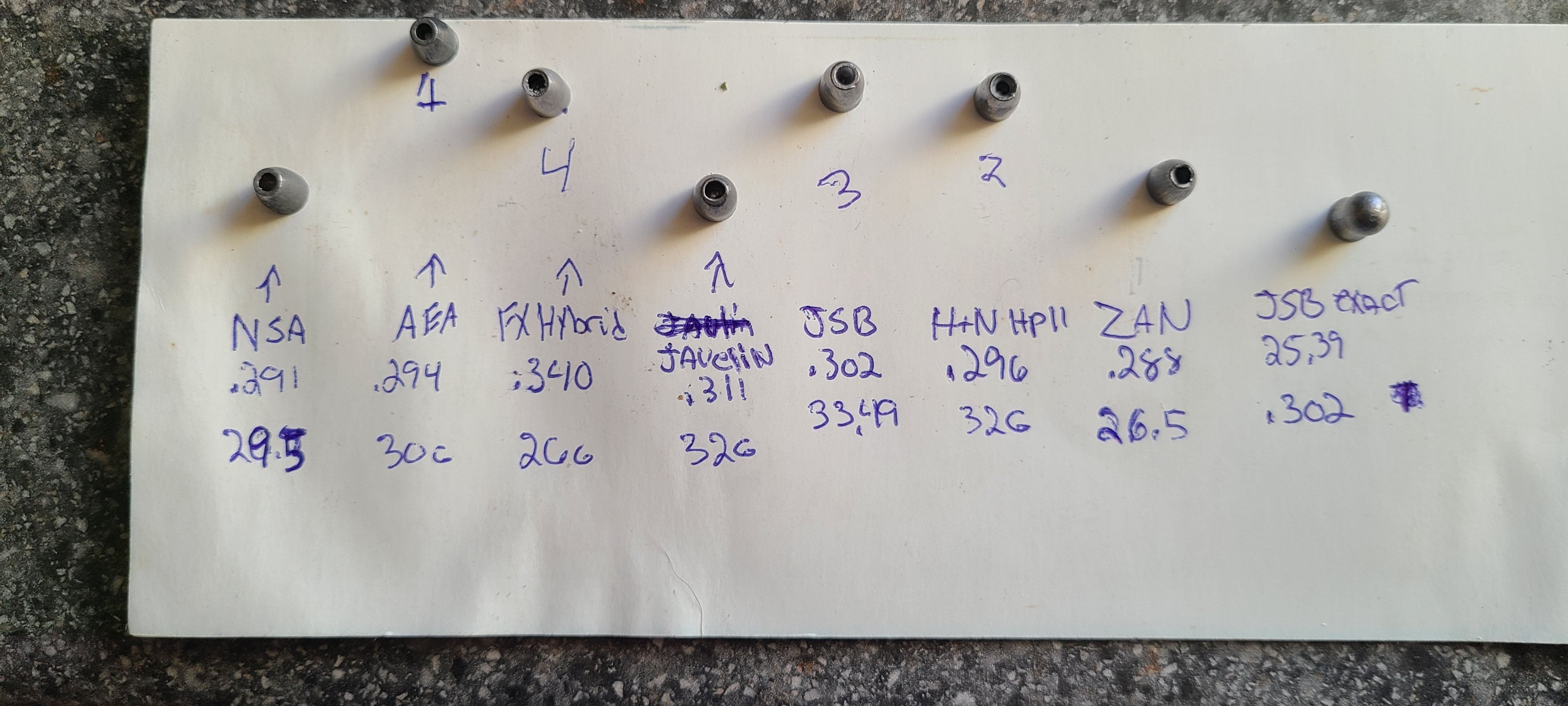

i also noticed the AEA H&N AND JSB are very close in length
i also noticed if they are flat on the backside like the nsa they tend to be inconsistent
the javelin 32g zan 26.5g i have not tried yet seems lime 25 cal likes slugs in the .298 - .312 in length i noticed.
here is a pic of the different slugs and Lenths

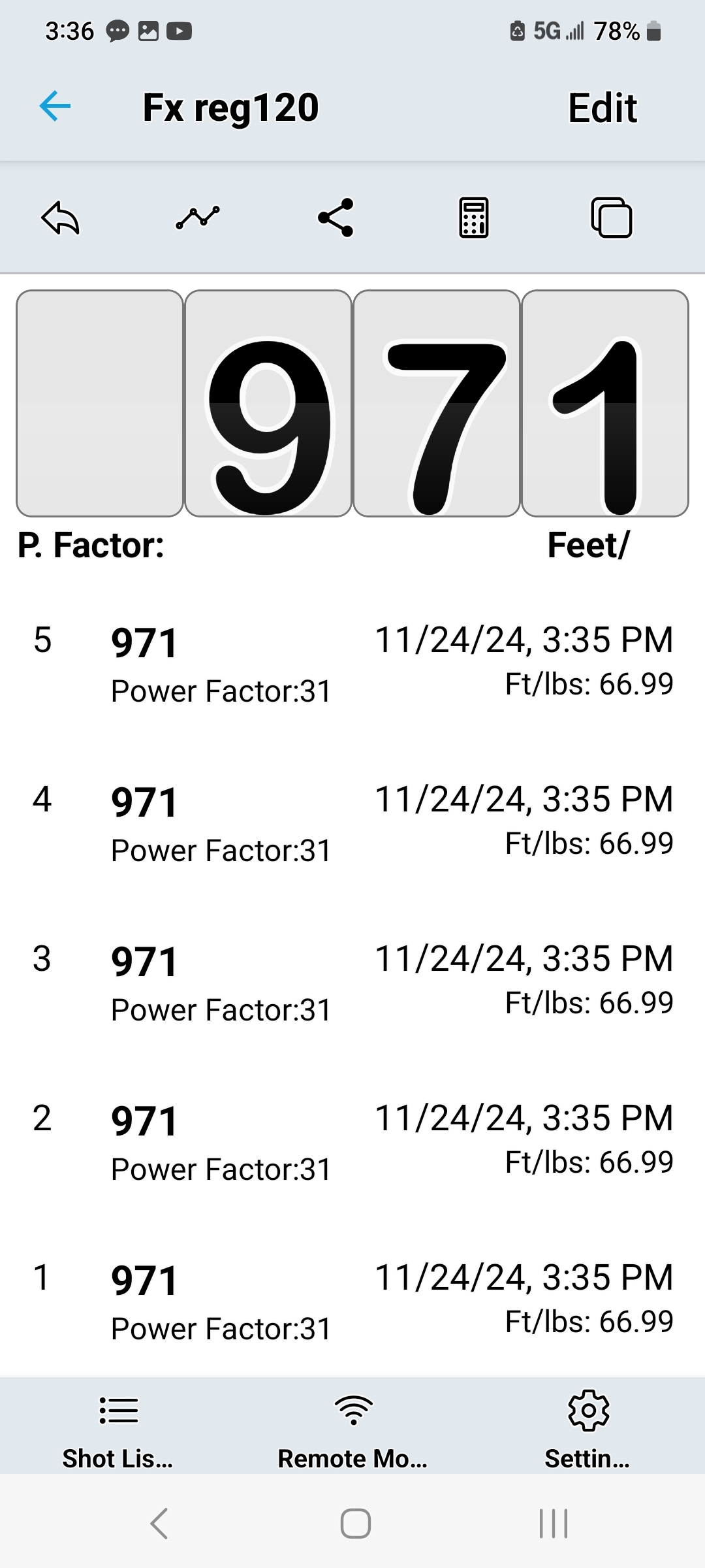

the huma air pin probe was good for 15fps with either port if you're going to use pellets i found you have to use only shallow skirt depth 2.5mm and less
otherwise, they won't load as smooth. I'm going to shoot both pellets and slugs, so the stock pellet probe is just fine. 33.43 gr 1015 fps I'm good.

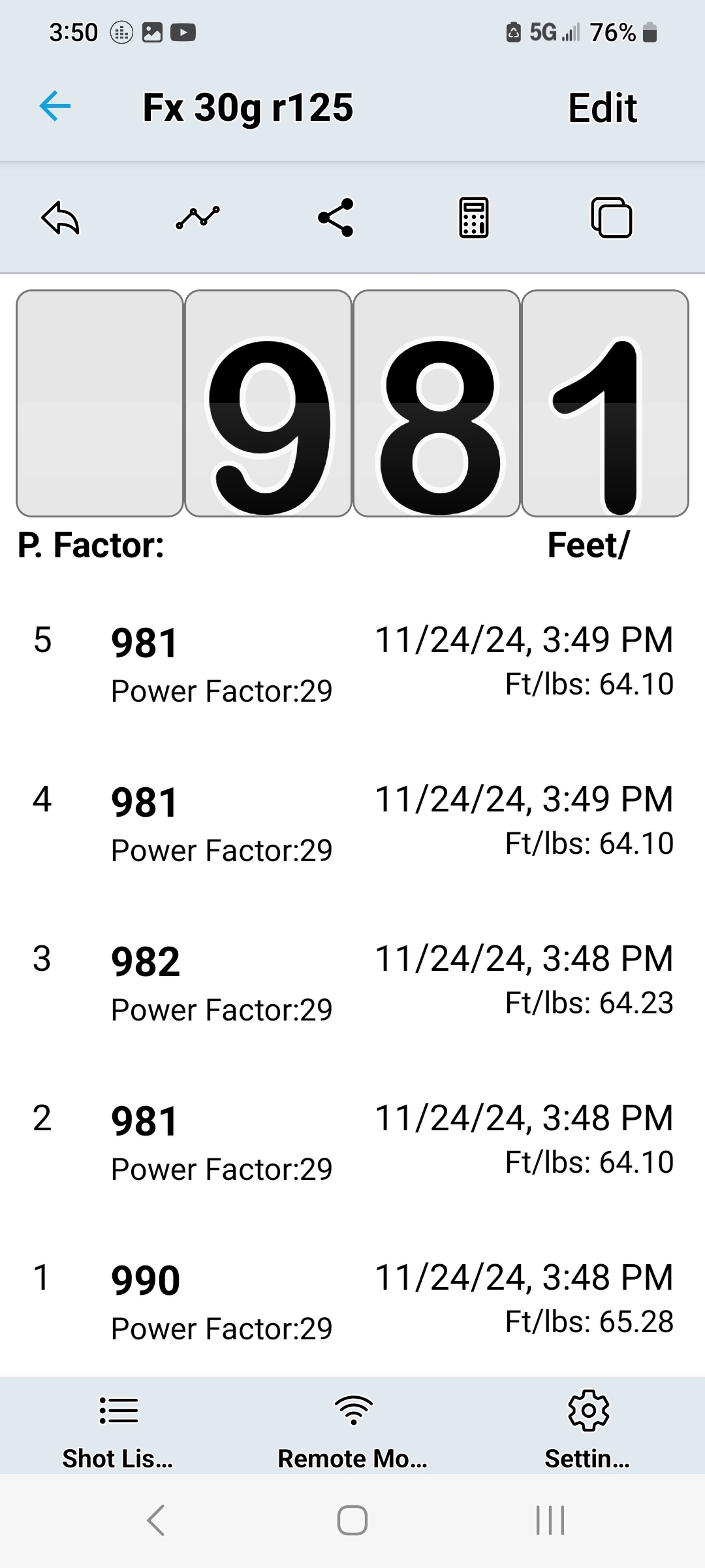

out of all the slugs BIG thanks to HogKiller AEA 30g and 33.9 970-980 1/4 in @ 50 yds
JSB KO 33.49g 970-975 just shy of 1/2 group @ 50 yds
the H&N 22g just like the AEA 30 g no adjustments shot the same reg was at 120 went to 125 pw 10 -12 micro 3-1/2 600mm 1/18.

funny when comparing the jsb H&N and AEA there all within a few cm in length side by side they look the same taper and measure the same o.d.

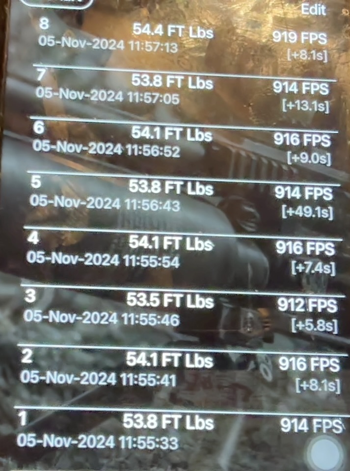

well guys figure id pass some info along here is a couple 4 shot strings.
