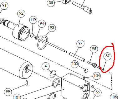

Check your valverod oring. Its a tiny one.

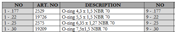

O-ring 2,2x1 NBR 70

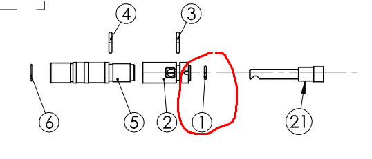

Also check if the oring is still in the transferport.
O-ring 2,2x1 NBR 70

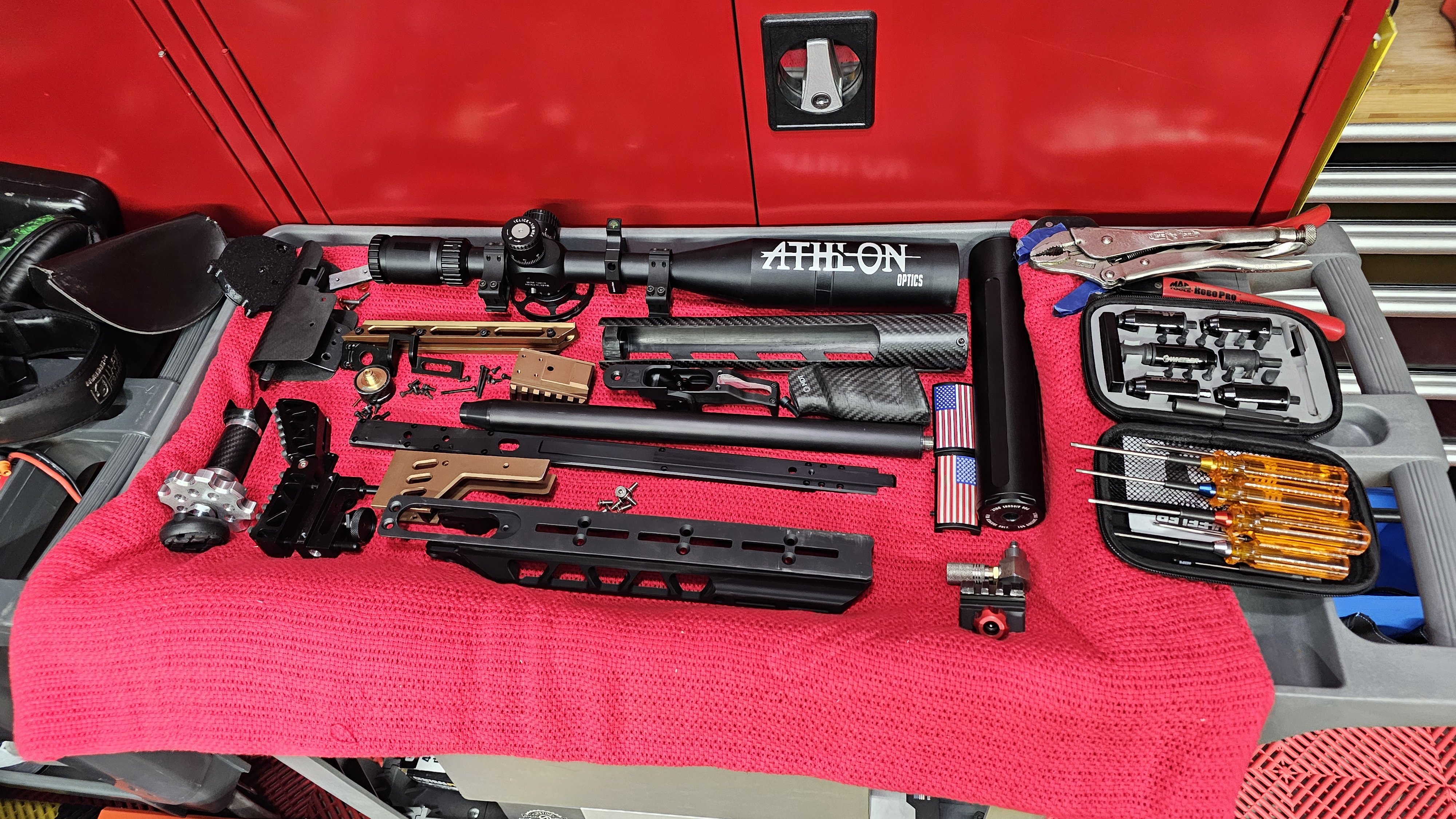

Thank you. I will finish taking the rifle apart and check it!
