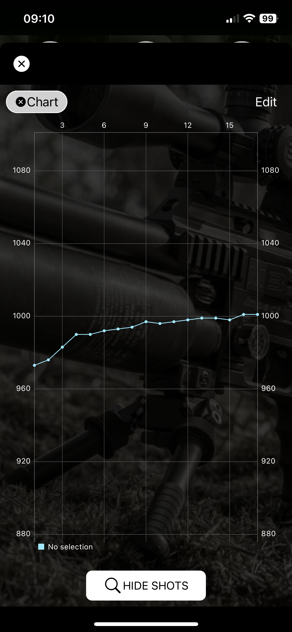

Here the chronograph results from an overnight room temperature rest, (over 2x strings as pictured)
26 shots so almost a full magazine !
