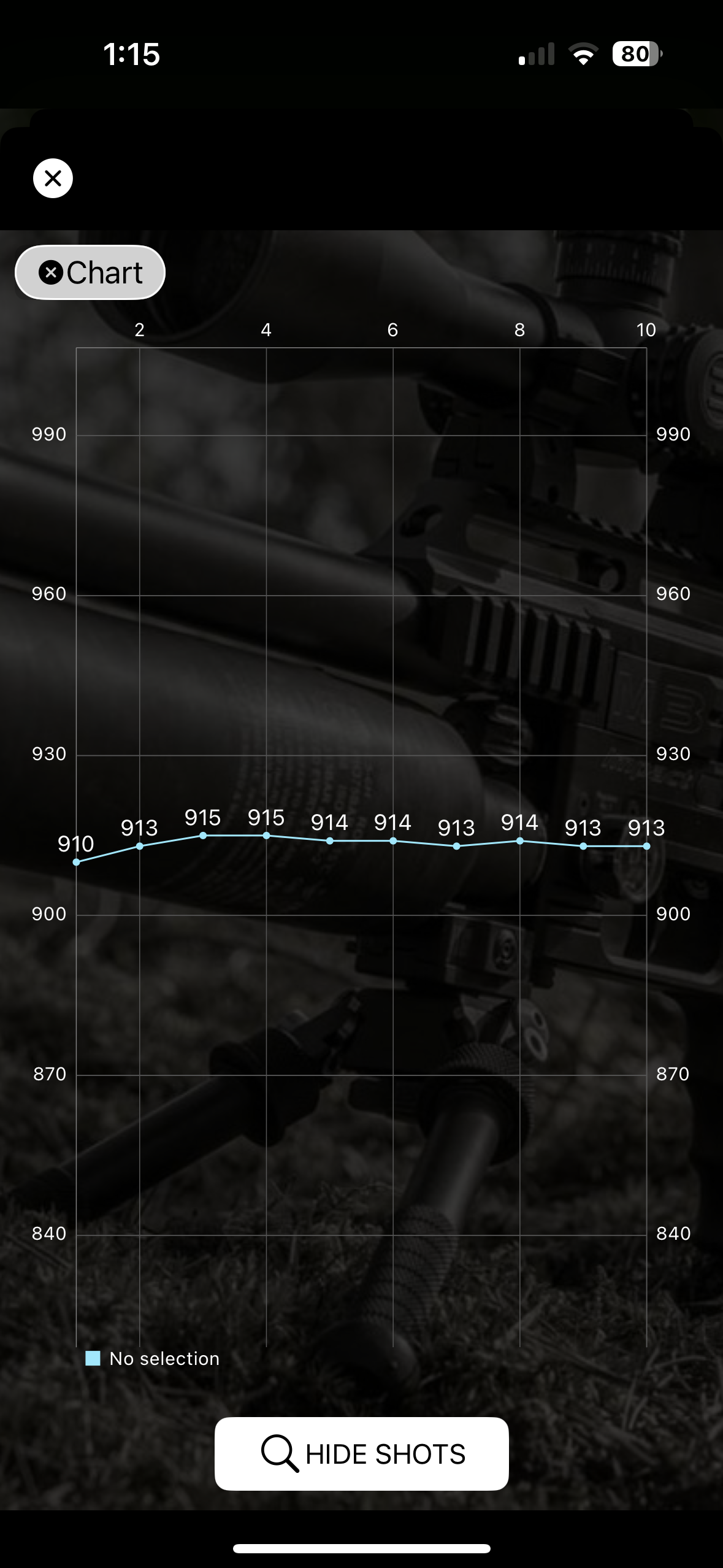

FX FX impact M4 velocity “warm up”
Ya that’s crazy unfortunate for a 2k gun. My $400 Turkish reximex wasn’t shot for 3 weeks. I left it at 918 FPS. Fired it yesterday at 917FPS first shot.
This should not be allowed on a gun that costs that much. Even 2-3 shots to “warm” it up seems weird.
Imagine telling someone who shoots powder. You need to shoot 3 times before your gun will be accurate. You think anyone would buy that gun

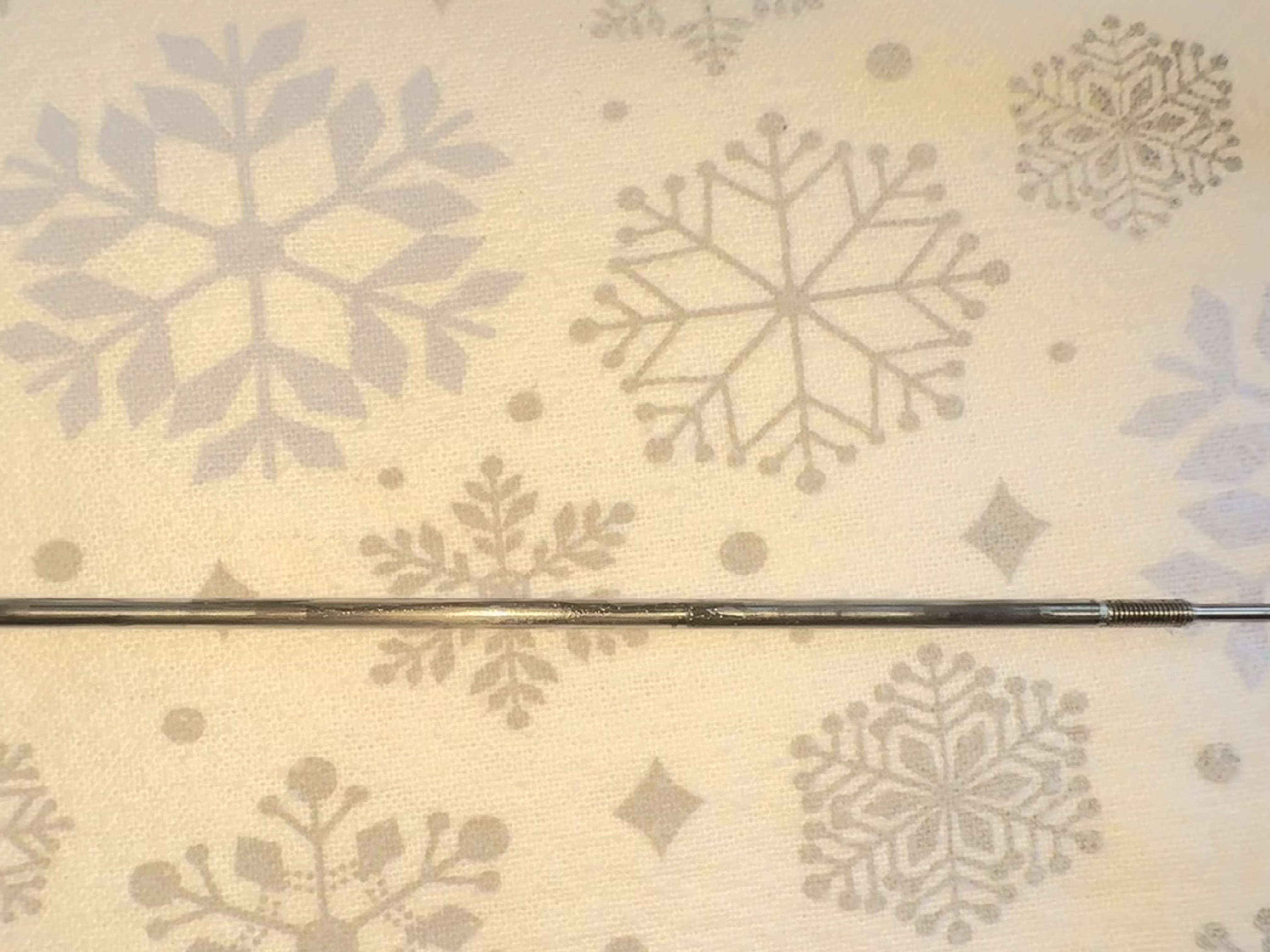

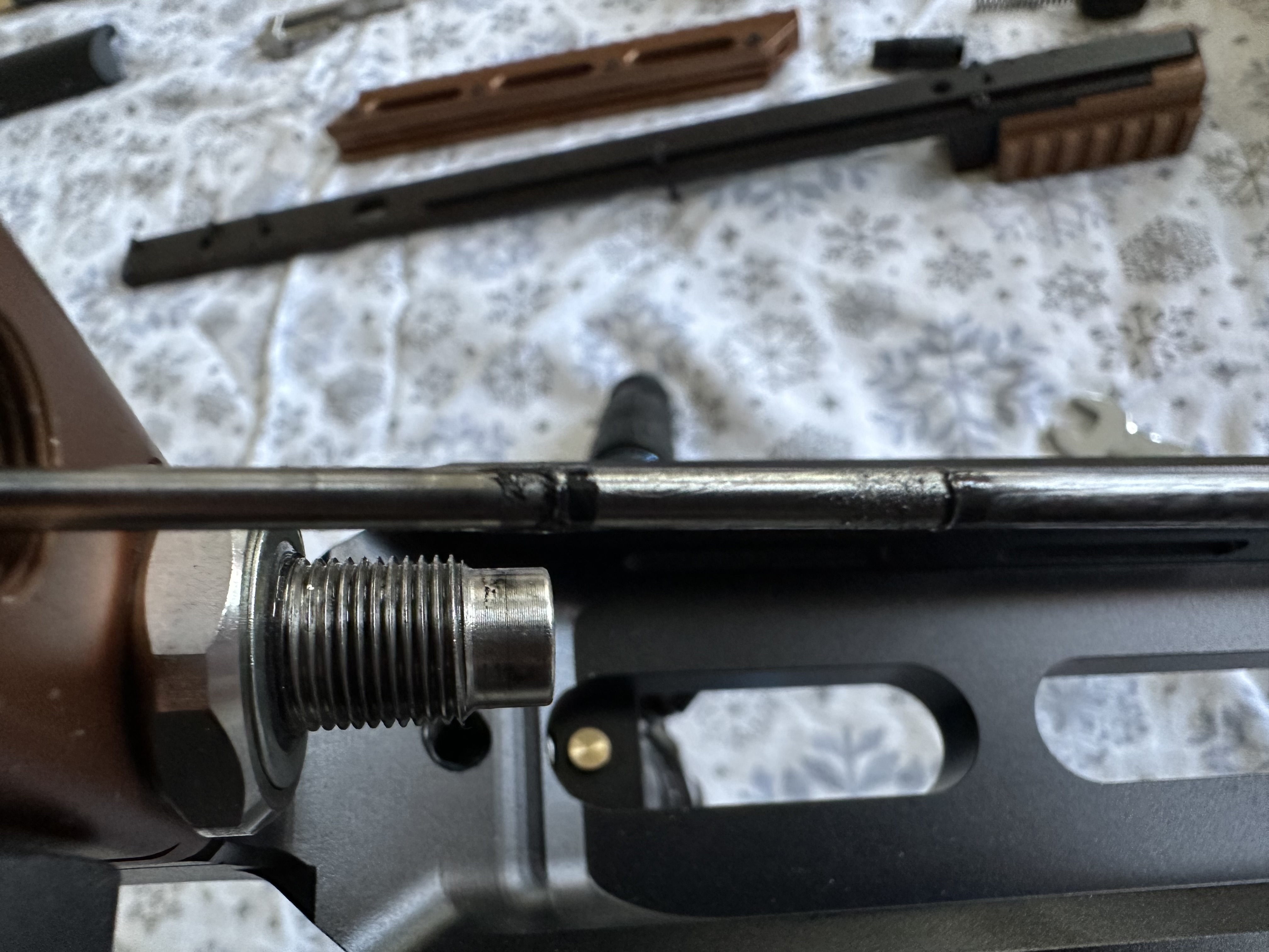

FYI, reached out to UA given that FX USA is no more since mine is doing the same on a higher power tune and they confirmed that this is a know issue and that cleaning and lightly polishing the valve rod is the solution. Can be fixed by UA under FX warranty of course if you’re not comfortable with breaking the rifle down yourself.
If cleaning and polishing the valve rod is the solution, let us know. Because all of us that have been doing this for the last four years trying to fix the issue will need to attend their polishing seminar. That would mean all the parts we are machining for this gun to really help with the issue are a waste of time.
Not the solution for the first slow shot, only for needing “more than one or two… meaning if you need 15, then it’s the valve rod. If you need one or two, then it’s just FX being FX…
I present to you: M4 valve rod gunk, newest feature… after cleaning and polishing the rod the gun is uber consistent again…
Yep I did the same process as yourself and found that solved the issue, I also lightly lubed the rod with silicone oil before putting it all back together, then a drop or two of silicone oil in the fill hose of my compressor just before filling the rifle up.
It now takes just 2-3 shots to get it up to its tuned velocity & not 10-15.
My rod was all gunked up too (not as bad as yours though) after just 300 slugs fired through it, maybe the residue of it being new and not yet worn in ?
Hopefully it won’t happen again or any where near as bad.
