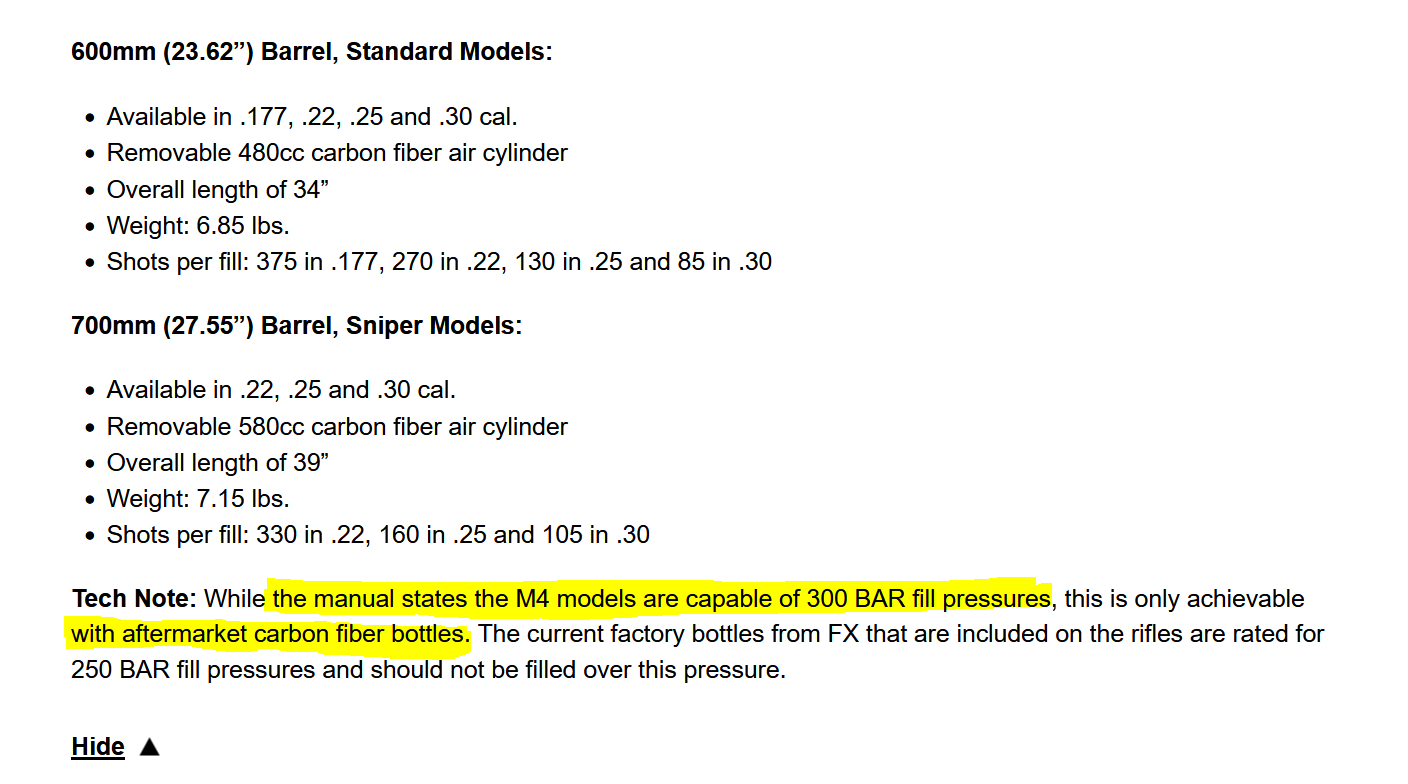

The FX M4 manual states in section 5 that the maximum bottle pressure for 1 regulator is 250 bar and for 2 regulators 300 bar.

UA isn't the only one either. I've hit up The Pallet Shop to inquired about it before i placed my order for the 300 bar 580cc CF bottle for my new M4, Bin also confirmed the M4 will run 300 bar with the aftermarket CF bottle perfectly fine, not to mention at Pyramid Air, they too..... CLEARLY noted the M4 models are capable of it as well with the 300 bar bottle.
